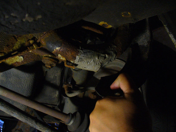

TrueBlue
Posts: 100
Joined: Sat Aug 23, 2008 5:30 pm
Location: ex-Buffalo, NY; now Cleveland, OH
Post by TrueBlue »
I have this exact same problem - grabbed a shot of it last night. A PO tried patching it with fiberglass but it's unsuccessful. I've pushed aside the plastic cover, also caked with dirt.
Hope that helps someone out. :)
Any other place to grab one besides a dealership or am I looking at a repair / parts hunt?
1994 Legacy L AWD 5-sp • 2002 Chrysler 300M Special • 1968 Mustang Fastback C-code

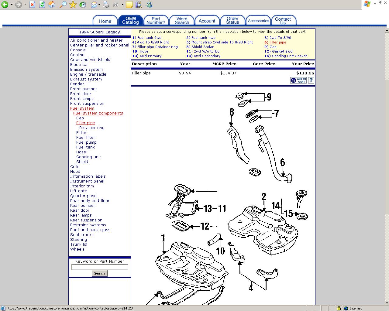

TrueBlue
Posts: 100
Post by TrueBlue »
nubs said he dug one up five years ago at $150, but further searching ( :) ) here netted this:
http://www.supermotors.net/getfile/6663 ... r_neck.jpg
$113. Best price I've found, and it's not on rockauto.com.
