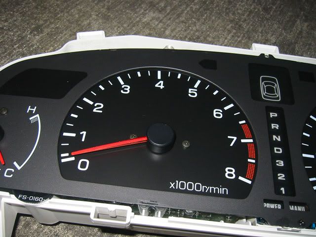

Today I pulled the gauge cluster, installed the blue LEDs, and colored the needles red.

Here is what the needles look like colored red:
Here is what the cluster looks like with red needles and lit up blue (and what the final result will look like when I'm done):
Unfortunately the blue light did end up being to dim to properly light the needles, so I will have to go back and add some direct backlighting for them. The needles are slightly more visible than this picture shows, but they are way too dim for normal safe driving. You can also kind of see the hot spots in the blue.
