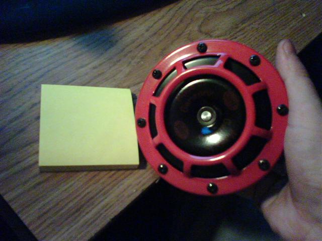

As you can see these things are bigger than a post-it note

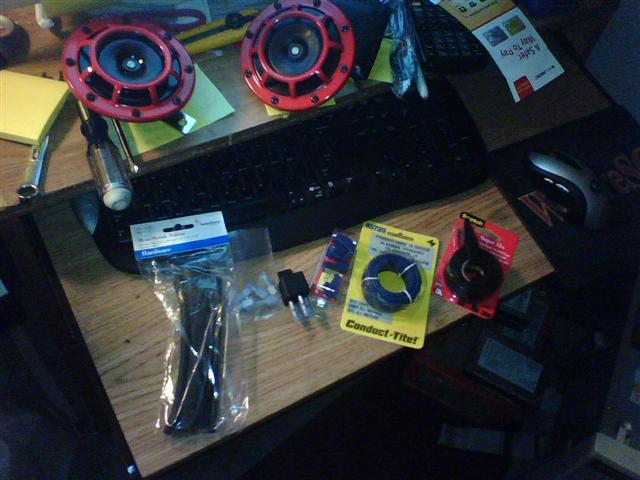

You're going to want to buy some wiring and heat shrink and tape and zip-ties and butte connectors. Probably also some wiring conduit to tidy everything up.
The horns and relay have standard 1/4" spade terminals so you'll also want some female connections for hot wiring action.

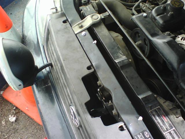

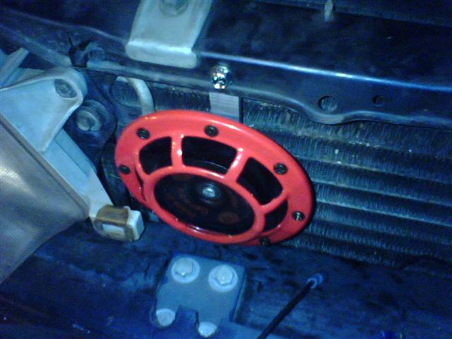

Next you need to find somewhere to put these things. I could probably have just used the provided brackets and mounted them where the stock horns go. Mouting these things behind the grill is all the rage on nasioc so I decided to do that instead.

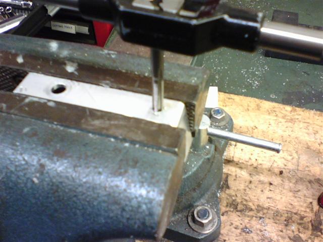

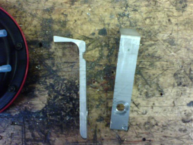

I scrounged through the scrap bins in the maching shop at work and found a nice piece of 4x4x1/4" aluminum out of which I cut two 3/4 strips. Then I sawed off the excess and milled the top down so that I could mount them flat against the bottom of the radiator support (which is angled).

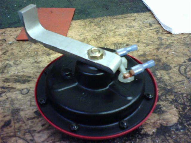

I cut that groove out so it would fit up against the hood latch cable and milled down that little circle so that I could thread the bolt down on the back of the horn like so:
I also tapped threads into the bracket so I could just run a bolt through the rad support into them and not have to worry about holding a bolt or something. They're metric of course.
Here is how they mount:
I used a hole that was already in the support for that hole and then drilled new ones for the rest.

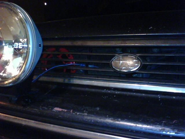

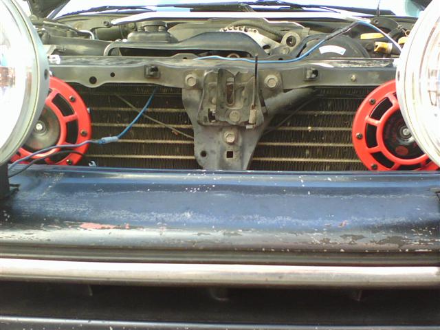

You can see they hide quite nicely behind the lights. I don't think airflow to the radiator will be reduced much and I took a "spirited" drive with them mounted and didn't have a problem. Although this morning there was a mysterious small puddle of coolant on the ground that I will definitely need to look into.
I have only tapped the horns and I must say there were pretty loud. I would not want to piss me off.

Nice write-up.
Did you have to trim anything off the grill?
I couldn't fit mine behind the grill.....
They sort of fit where the stock ones are, but it's tight, and there's better spots.
I still need to remount mine....

Legacy777 wrote:Nice write-up.
Yeah they fit behind the grille just fine. There is a little over 1/4" between them and the bumper, and probably 3/4" to the a/c exchanger. I don't even know how close they are to the grille itself but I think there is plently of clearance. The only problem came when the split in the wires ended up being at the narrowest part between the radiator and headlight, but I got everything tucked away with zip ties. I feel like I should wrap it with extra conduit or tape or something though.
I also re-did the wiring for my lights and put everything together. It's wrapped in 3/8 split conduit and ziptied under the radiator support.
Posts: 27932
I think the 92-94 grill has more room then the 90-91 grill.
Nice job countersinking the bolt holes.
