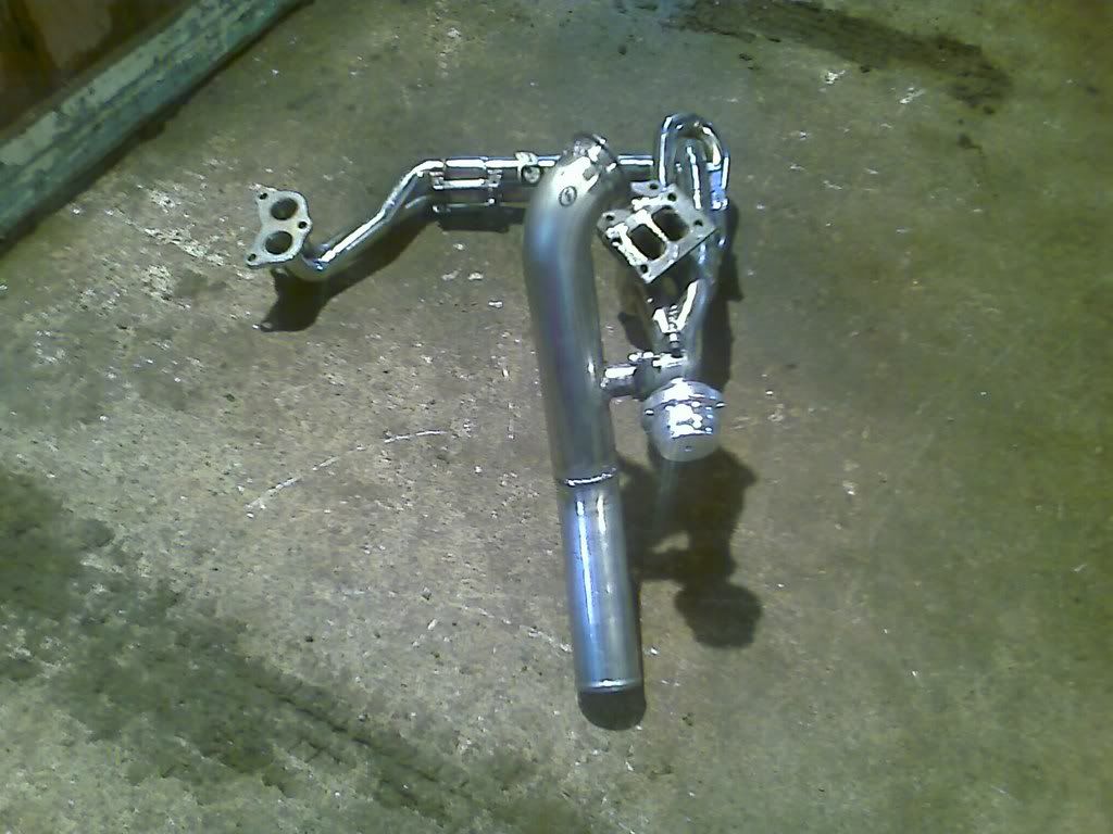

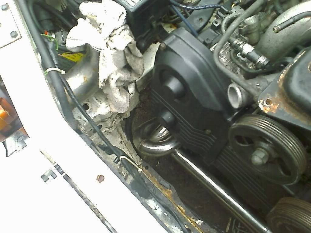

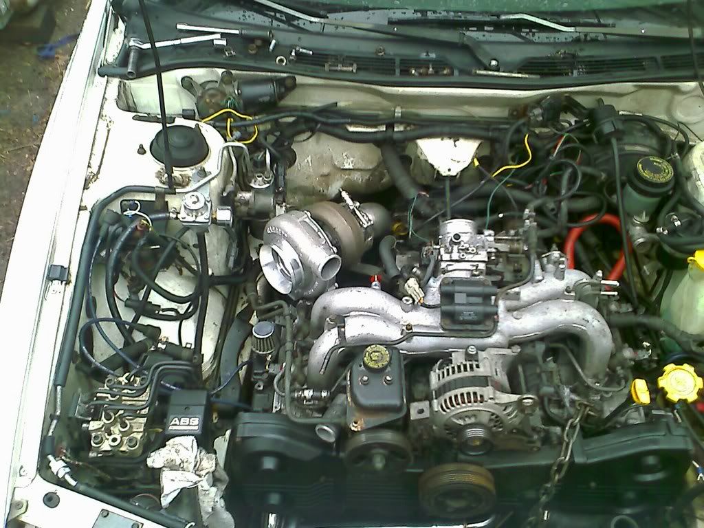

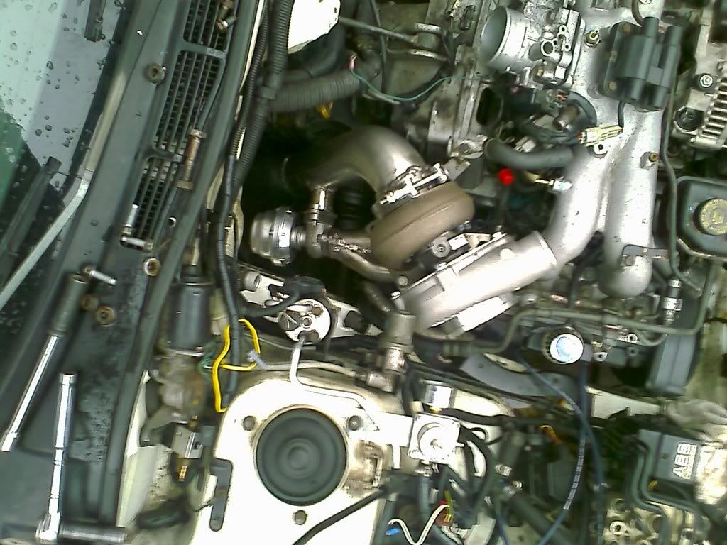

Here are some pics of a friends SS in progress.
A few Details:
Garrett GT3076R, twin scroll
LARGE FMIC
660cc venoms
MAF Tanslator Pro
Eagle/Wiseco Shortblock
Phase I DOHC heads
DLC

It's an automatic???

Is the final section of the up-pipe divided?
206er
Posts: 2590
Post by 206er »
yep

I like your wastegate and adapter setup. That's cool. A twinscroll GT3076 would be a really nice turbo.
Its a friend of mine here in MN. He doesn't post, but lurks once and a while. Of course he had to wait until he rode in my car before he decided on a turbo.
I'm curious how the .78 exhaust housing w/ the twin scroll works out. Next summer I want to get a set of those heads, and a larger snail may be in order. :twisted:

wow identical setups much. except im using a differnt exhaust housing.
cant wait to see results

The twin scroll won't work properly, as you don't have the correct cylinders paired to achieve the alternating twin scroll effect...
BAC5.2
Posts: 9026
Post by BAC5.2 »
It's set up correctly. What makes you say it isn't?

it will work. even if its not paired correctly it stil has benifit. FAT in az did a "improper pair" using the cast iron and it still has a great benifit for the 40r their using

Derek said its paired back-two, front-two, as it should be, IIRC. His cell phone pics don't really tell all.
Either way, this thing should rip with those heads. He just needs a tranny. He's looking for a roasted auto tranny out of a turbo car BTW. I never realised the auto in the turbo car is beefier than NA cars. Since he rebuilds autos for a living, he's capable of making hold up a little better.

Ah...it is right...It was hard to tell from the pics
my bad :o

It runs now. Derek said those 2.5 DOHC heads really come alive at 4500rpm. He needs a standalone bad. The MAF translater Pro, although nice, limits him to the factory redline.
15psi at 36-3800 rpm is not to shabby for a 3076R and comp ratio in the low-mid 7's
