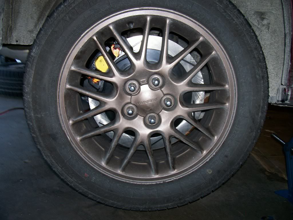

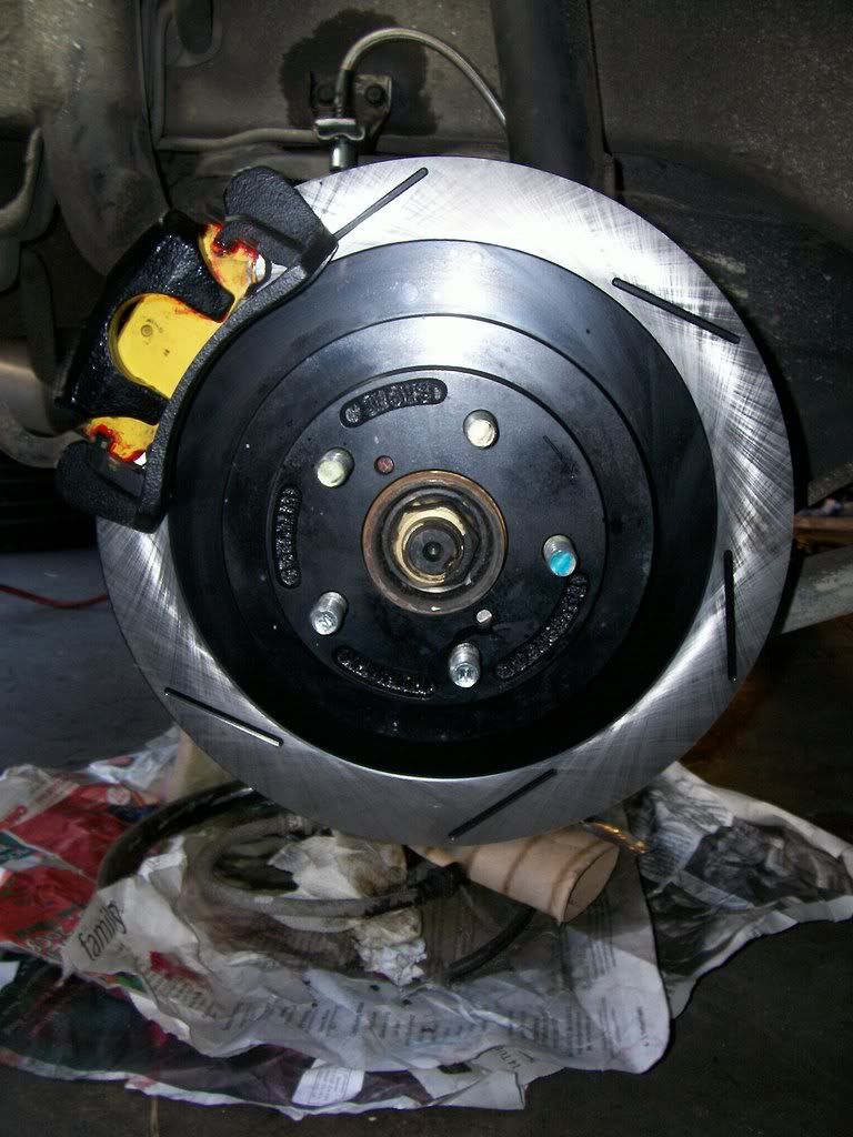

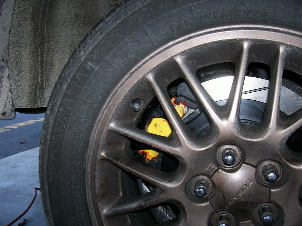

I ran out of time to get the pads on the driver's side and the caliper bleed and haven't gotten my WRX fronts on yet so I don't have any driving reports to give. But I thought I would share a few pictures of the new hotness that is now my rear brake setup -
There's maybe a 1/4" of clearance between the caliper and the rim, but it does clear it. Once I have some time on the road I'll report back.

The rear calipers are attached to the brackets with two bolts. The top bolt is really just a pin that the caliper slides onto and then bottom bolt goes through the caliper, through the rubber bushing, and into the bracket. So the whole caliper can float and to change the pads you just take out the bottom bolts and pivot the caliper up and out of the way.
So with the new brackets you just have to unscrew the sliding pin from the old bracket, it's a 12mm hex, and install it into the new bracket. So now the caliper will attach to the new bracket just like it does with the stock bracket.
The new bracket is made such that it just moves the caliper further away from the center of the rotor. You can see in the pictures how the contact surface is still pretty skinny, a result of just moving the existing pads/caliper outwards. The bracket attaches to the hub with two 14mm bolts behind the dust shield. It is the length of these mounting legs that determines the distance of the caliper to the center of the rotor. The new brackets just have longer legs to move things out.
I should have taken some pics with the old brackets next to the new ones to clear this up but once you get them it's pretty clear how the whole thing works.
