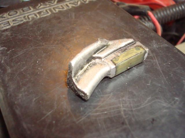

I dropped the transmission because the noise it came with became louder and even more menacing. I figured a bearing was the cause of the noise(it still is) but I also found a chunk of fork.
So if you drain your Sparkle fluid and this pops out, refer to this guide.

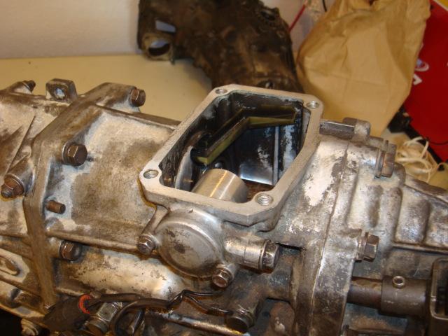

Once you have the trans out open the top cap.

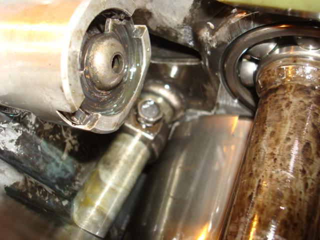

In here you gain access to this:
Undo this screw(the one in the collar, on the shaft) this makes it so the internal linkages can clear each other and you will be able to split the rear differential housing off of the main housing.

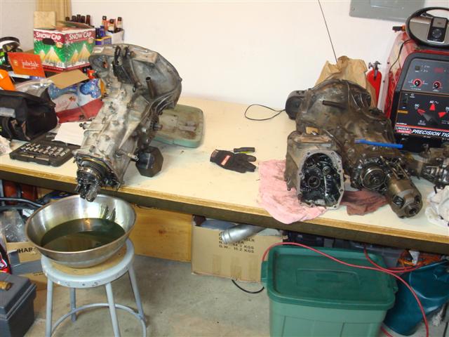

Now you have have something like this.
Let some more fluid drain and have a beer. I like Snowcap this time of year.

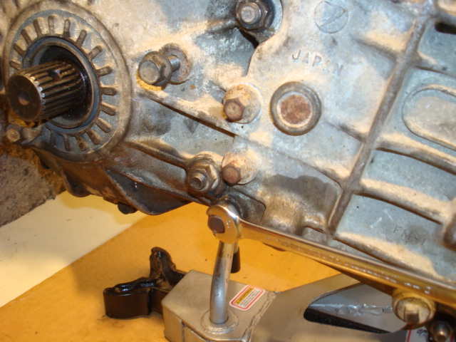

Now it's time to start undoing the large handful of bolts that are holding the transmission together. I had the unit upright and level with the cinderblock in the front and a jackstand on it's side under the rear. This made it easier than having it on it's side to get the bolts out.
These four will also need to come off in order to get the halves apart:
Once your bolts are out lay the transmission with the drivers side down(left side), and gently tap the halves apart using the tabs around the seam.

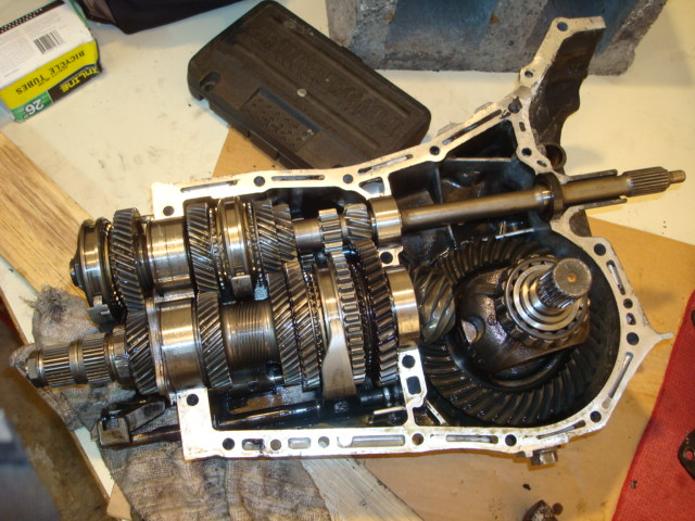

And now you should be looking at this:
Now you can lift the input, output/pinion shafts out.
I always thought that there was special aligning to be done whenever you ventured into a 5mt, but only when you are altering the gear parts. Since we are just lifting them out to change a fork and dropping them back in, there's no voodoo magic to be worked.

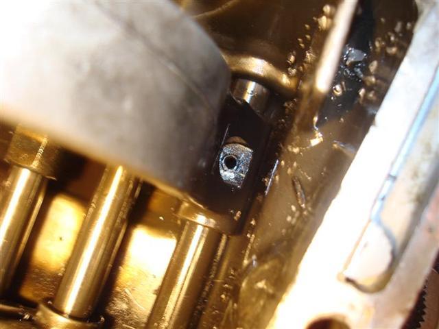

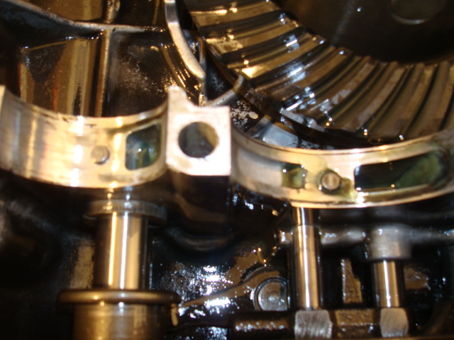

Now that the shafts are out you can get to the fork. And in order to get the fork out you need to drive out this pin:
Grab the 3/16 punch and drive it out. Mine had a smaller pin within the larger pin that is pictured, I used a nail with the tip ground flat to drive the small inner pin.

Slide the busted fork off- mine was sticky and needed massaging, keep trying- and slide the new one on.

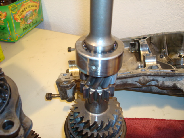

The bearing at the rear of the input shaft has a ring around it, much like a piston ring, that needs to be snug against the case when being laid back into the race. The ring has a section cut from it so it's able to clear the plate that is held to the case by the 4 bolts (sixth pic from the top).

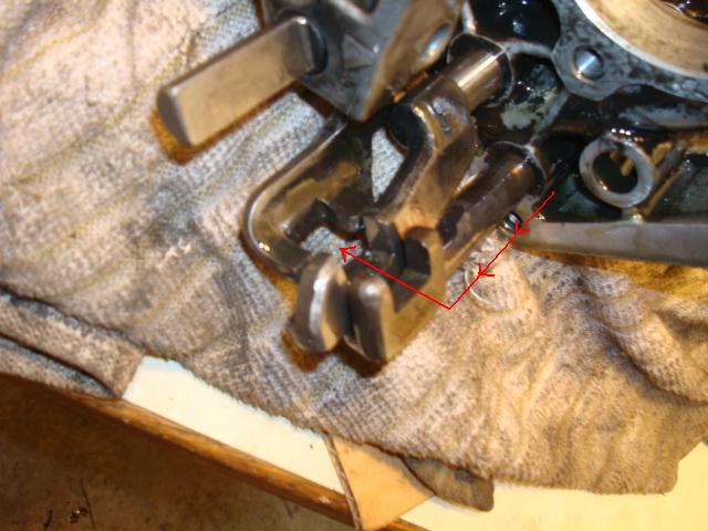

Once you have the case halves back together, and are ready to put the rear section back on it's helpful to hold the shifter rod full counter clockwise again like we did when taking the rear off.
You have to get the tab into the slot, hehe, in this sort of fashion:
It's pretty easy and you will know when you have it in from the way it feels.

1.) when putting the trans. back together, there are a few spacing plates on the pinion shaft bearing. they all need to be in the correct location and on the correct way before both shafts/bearings will mesh (theres a clip on the mainshaft bearing that will catch the spacers
everytime). if u dont do this, your trans. may not spin, you will ruin your spacers and it just wont be correct.
