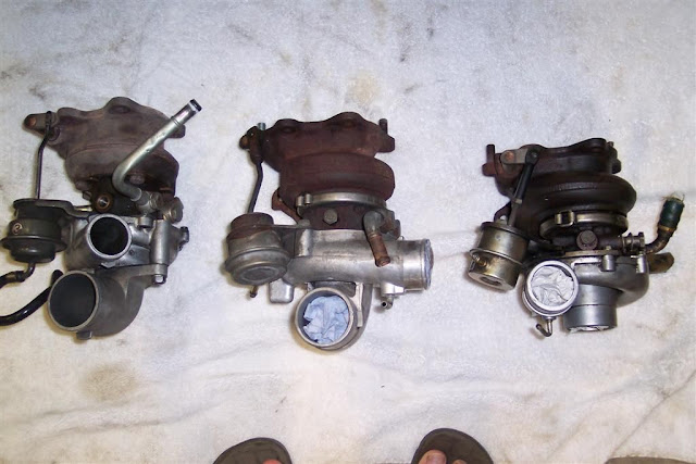

Here are comparison pics for your enjoyment.
From Left>>Right:
VF11, JDM TD04, '06 WRX TD04L, JDM TD05H-16G
LINKto photos.

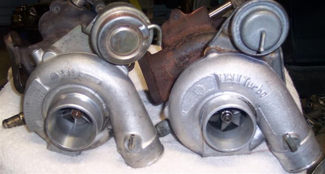

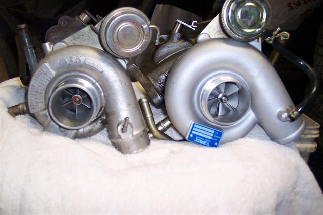

TD04 vs. VF30: JDM V7 Subaru Impreza WRX STi. The VF30 is a thrust-bearing turbo that utilizes the P18 exhaust housing of a VF24 and the compressor housing sized between a VF23 and a VF22. Install was painless. Tight fit between 90 elbow and IM, but not as bad as others. Used the VF11's upper coolant pipe and the VF30's lower pipe - had to bend it a bit to fit. Also, tight fit where 90 elbow connects and the WG and Turbo vac lines connect.
VF30 (L) vs. TD04 (R)
TD04 (L) vs. VF30 (R)
TD04 (L) vs. VF30

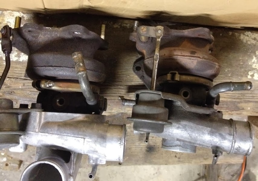

VF11 vs. TD05-16G vs. VF22 (clocked)
EDIT: More turbos - TD05H-16G vs. VF24 (V4 STi)
TD04 vs. TD05H-18G (Zage brand turbo- yeah, I know, I know). Installed OK, but very tight on the stock oil lines and the 90 elbow against the IM.
