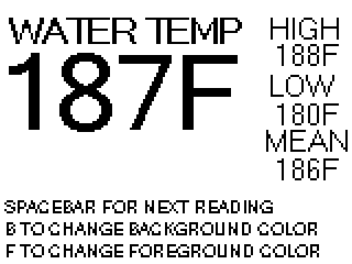

						Splinter wrote:VRG, if you're planning on doing any updates to the program, here's what I'd like to see:
be careful not to get your hopes up. the programming format that the code is written in is sevrely limited by size (100k max size IIRC)
Factoring in the high/low/mean would mean pointer and memory management, adding considerable size and complexity to the code.
You'd be lucky to get the text blown up to fit the screen.
I doubt this program has any future development. It's a great diagnostics tool, but that's about as far as the stock ECU is useful.
