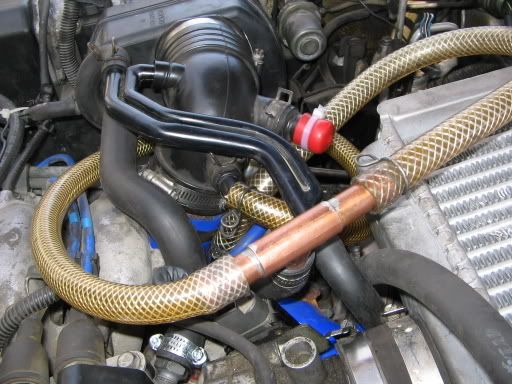

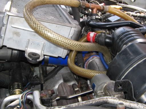

Okay so i found this: http://www.clubwrx.net/forums/showthread.php?t=134744 which might help others with the install.
I totally blanked and forgot to take photo's during the install.
problems that i ran into:
1. f-pipe off of PCV valve broke. ended up using a brass-T pipe, because the f-pipe kind of didn't fit... or rather the hose i tried to use at the time didn't fit properly without adding too much stress to the 13 year old piece of plastic.
had to use a metal exhaust pipe section (at least that's what i think the metal came from) to act as a meeting point between the chopped y-pipe and silicone extender to turbo outlet (this was very difficult, the stock y-pipe is all contorted inside and makes it very hard to fit the same size material in far enough to get a clamp on secure, suggest getting an STI y-pipe or aftermarket one from Perrin or the likes, as they are silicone and fitted properly. Did the same from the intake to the silicone elbow on the inlet of the turbo, this one was easy, just a straight piece 2" pipe.
had to remove (well didn't seem like it would work with it in place) the up-pipe mounting bracket that connects to the block, so that we could fit the 90 degree elbow between the intake manifold arm, and the turbo itself.
bov doesn't look like it will be recircing anytime soon, and i may end up switching back to the stock BPV in some manner, if the new one draws too much attention from say... the wife. The new one looks like it won't fit in the opposite direction (will hit the throttle cables) in order to connect the recirce hose towards the air intake. might fit the otherway... but at this point i just don't care.
If i can think of anything else... i'll add to this later.
