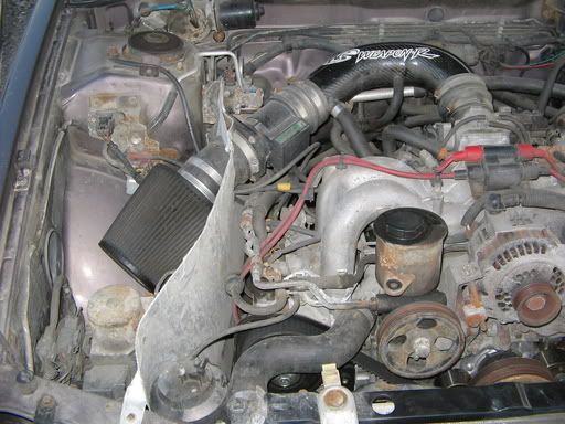

Just thought i'd share...
on my 96 wagon i screwed around with this concept, i installed a "ram air" hood scoop that went directly to the cone intake, which i had isolated from the engine bay heat with a DIY heat shield wall.
unless you tune your car to recognize that there is more air, you won't see any huge difference, other then getting colder air, which offers slightly better mileage.
However if you replace the stock exhaust, in combination with the intake, you might see some more power. intake and Borla headers + borla catback = the car was quicker then stock, and sounded mean as hell. However it's nothing compared to a stock leg turbo on boost.
if you do go through with it... make sure you have some way to divert water in heavy downpour, otherwise you may have issues with the MAF (err, did first gen leg's have mafs?) i had piece of plastic i could swivel into the way of the air flow if it REALLY was raining hard outside.
hope that helps.
