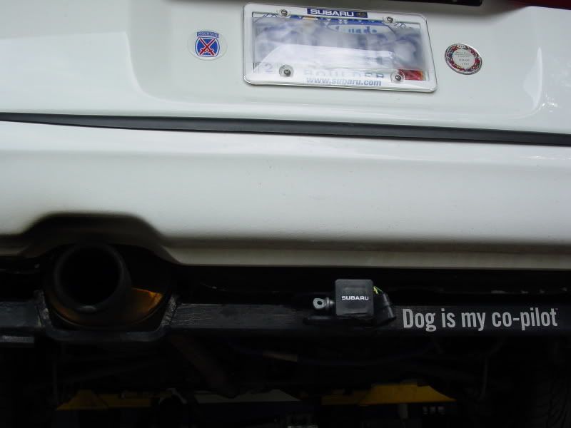

nice settup, but what muffler is that?

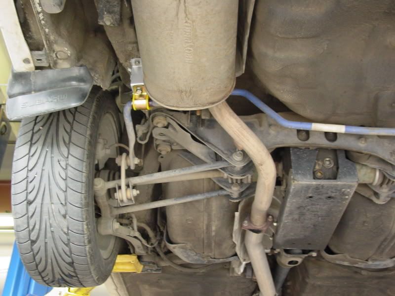

Where'd you get the skid plate and diff protector?

Muffler is Bosal Brospeed S.S. right out of the Subaru Parts Dept.
it's made for the old Impreza 2.5RS
Steel skid plate is off an old '97 Outback
and the Rear Diff. protector is from an Impreza
Subarus are kinda like Legos :)

also some older bc/bf's came with a factory front skid plate, and the rear diff protector you can buy at subaru for $50.

Nice. I'd like some underbody protection. The primitive racing parts aren't too much, but it'd be cool to just pull that outback part in a junkyard.
I'm looking at getting pretty much the same setup. 2.25 custom piping, one cat, and something like a magnaflow muffler.
How do you like the sound, and do you get a cel?
I was thinking the cat should be a little closer to the manifold than that, but it'd require a lot more fabrication to do that.

I should have mentioned that I've NEVER had a CEL!!!
In addition, I replaced the turbo leg mid-pipe I got from Matt Monson
with a larger dia. custom fabbed mid-pipe
As far as the 'sound' goes it sounds unlike any Subie I've heard
at low RPM it sounds 'wierd' but at mid to upper RPMs it sounds
Badass :twisted: Power is amazing especially for a 240,000 mile

for those interested in a really cheap skidplate, an ea82 stock one with extra holes drilled will work.

Header is Cobb Tuning
Equal length Jet Hot Coated w/ hi-flo Cat.

So the Cobb header will in fact work with the ej22?
Also, that transmission doesn't look like it was the one from the factory. Is it only the older 4eat that has a slightly offset front diff in the transmission?

It's the original 5 spd. manual transmission!!!
