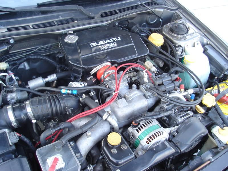

2 questions;
-Any issues fitting the AWIC into the engine bay, or move any components?
-What brand/model is your front strut tie bar, and what was it originally made to fit?
Ok, 4 questions.... :)
Jerry
livestrong14
Posts: 1517
Post by livestrong14 »
Thanks man!
No problems with fitment of the Air/Water for us. My engine came with all the mounting brackets that support the TMIC, so there were no mods needed on that end. I am using a 98' Forester Clutch master cylinder which is shorter than the SS 5-speed one.
The STB is a whiteline piece that was meant to fit 95-2000 Legacy's. No it is not backwards! lol

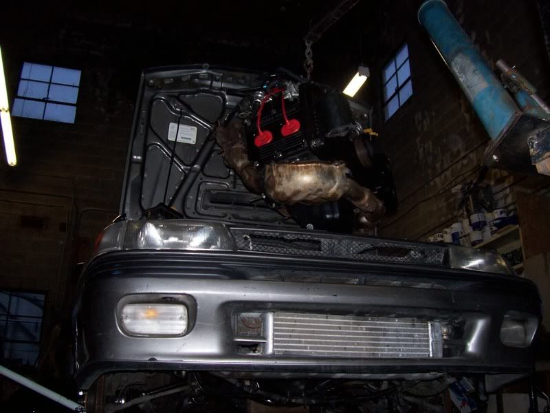

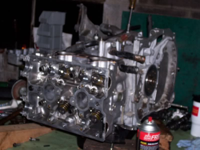

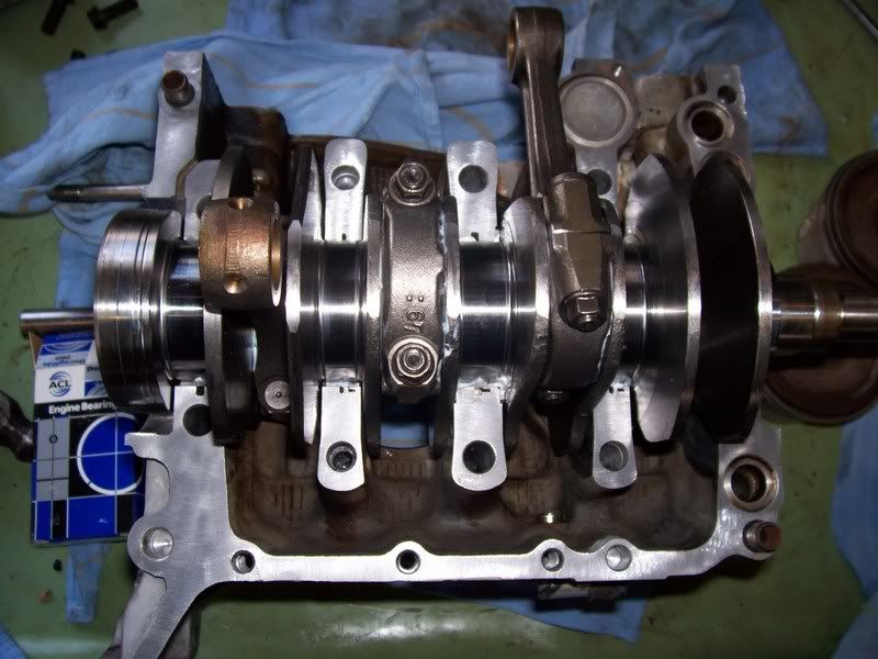

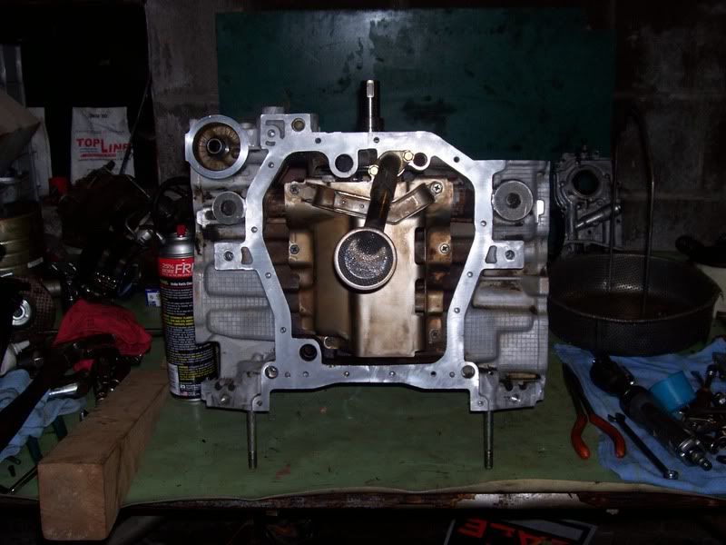

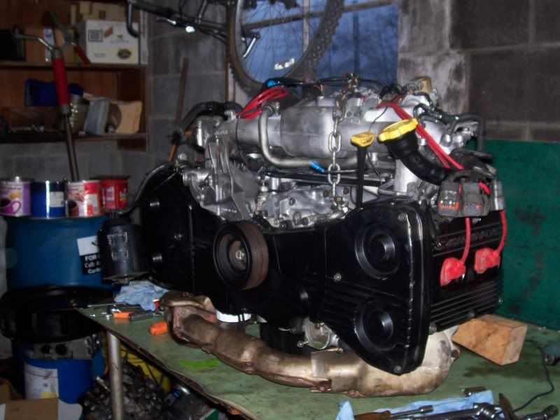

As a few of you know, we have been very busy down at the shop lately! Sorry I haven't been able to update more, our time frame was very short. But now, the legacy is back in action! With a few new goodies;) Thanks to many friends I have been piecing together more parts to be installed this spring break. But, enough of the future, here's what we did over the last week!
Kory (koryh2009) and I drove to Portland on the 26th of Dec! We immediately pulled the motor out of my 91 Turbo. It was time to remove the torqueless 2.0 shortblock! Time for a closed deck 2.2T! We also threw in a few goodies to go with it, including ACL bearings and a (VERY) low mile JDM WRX crank. Everything was torn apart, checked, and checked again then given a clean bill of health.

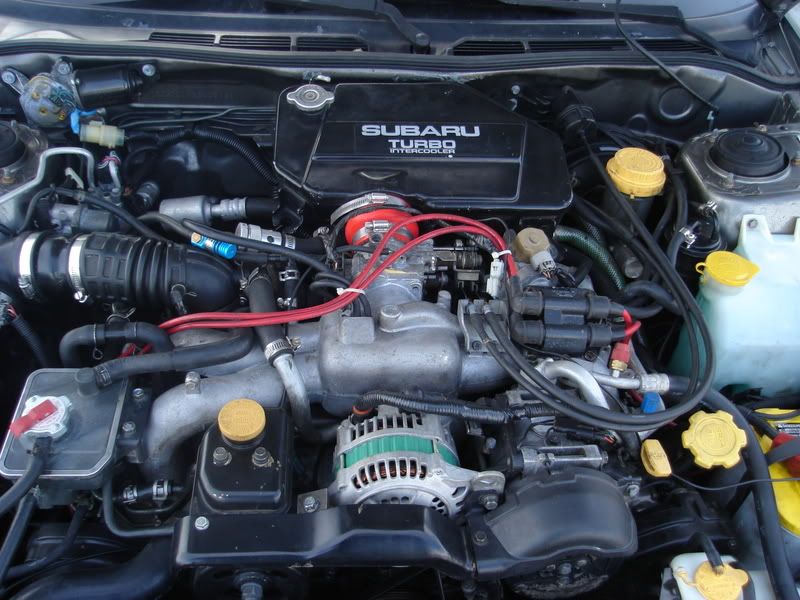

Then, I decided to do a little dress-up. I got this idea from David at RalliTEK, and I personally think it looks bad-ass!
Then after we got all of this assembled, it was time to go back in!
The car runs better than ever! Smooth and beautiful idle, can't ask for more! My dad can sure build one hell of a motor!
Vid of start up!
Here she is all put back together, still needs to be cleaned up a little, but she sure looks pretty stock. New mods to add to the list include: JDM Forester high volume oil pump, ACL bearings, STi Group N Pitch Dampener, STi Group N 5MT Tranny Mount, STi Group N Motor Mounts, and to finish it off, a Diamond coil pack.
Driving Impressions
There is no comparison between the 20G bottom end and 22T when it comes to torque. After driving the 20G for a year, then swapping over to a rebuilt 22T shortblock, I can't believe it took me so long to finally make the swap!!!
It takes less gas to get moving from a stop, the clutch/gas transfer is minimal. It finally has enough torque to go up Germantown Road in 3rd! I used to have to downshift at every turn. And perhaps the best part is having an active 5th gear, that you can still accelerate from at 60 mph to get up to freeway speeds (Idaho 75mph) The best part of all of this, after driving back from Portland to Idaho yesterday is my 28 mpg highway! What more can you ask for from a high 13 second car????

I like the cam covers.
What year 2.5 are those plug wires meant for? I'm guessing '96.
livestrong14
Posts: 1517
Yeah they are off of a JDM Forester intake manifold that was shipped to us. They are the only ones long enough.
