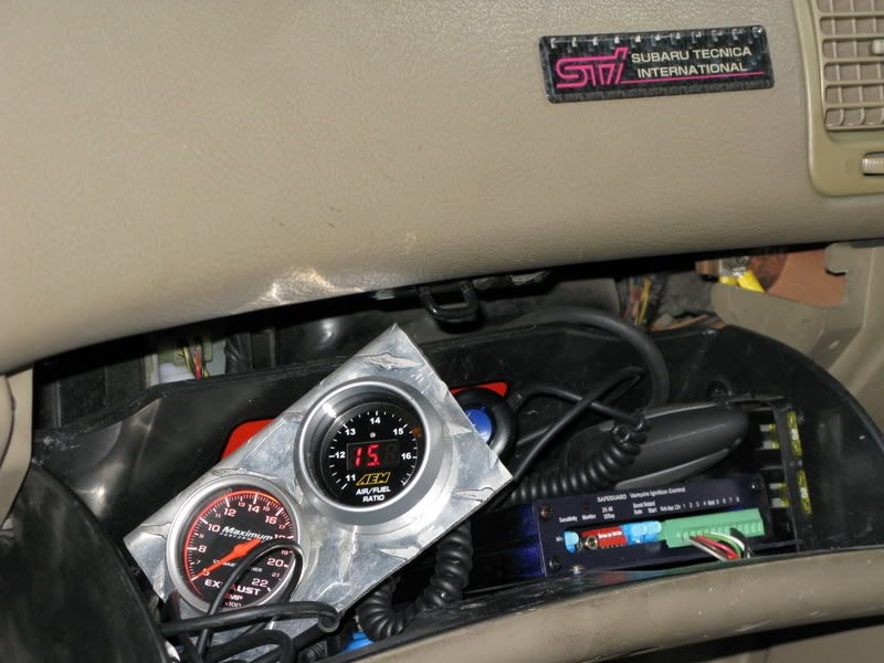

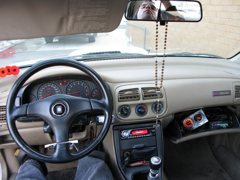

i use perriens water meth system.
i know when it kicks in i see my air fule guage jump about two afr points higher. but i asked mike at innovative tuning if it was like adding a point of fule its not the same thing. also it kicks back my egt a slight bit nothing crazy.
in the summer it kept my motor nice and cool in the dead of heat, and when the motor blow up all the parts where so clean.
greg donovan: i also just got a j&s knock system! that box works amazing if your trying to control knock.
and its a small unit fits perfect in the glove box for hide away from police
