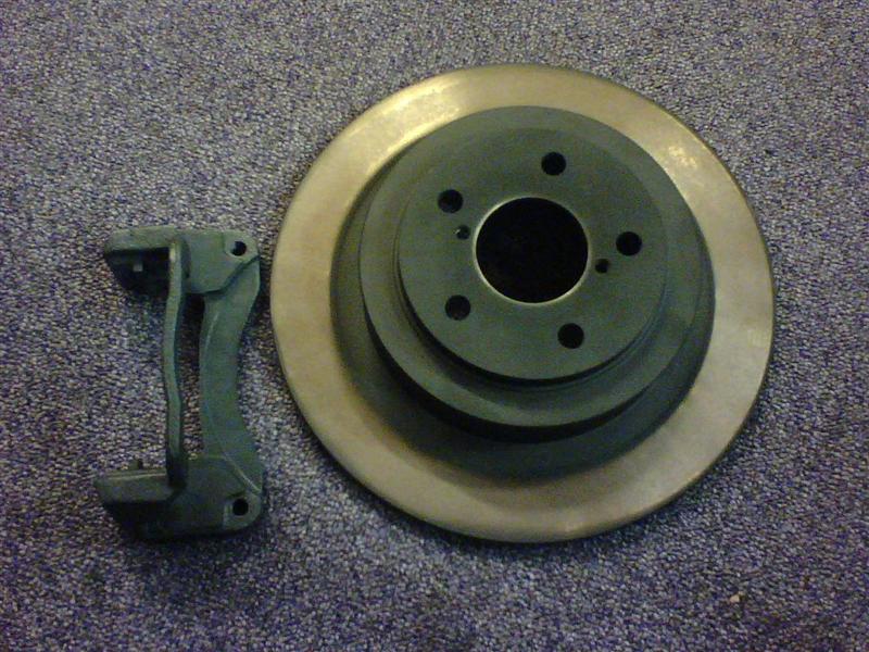

Contents, 2x of these:
That's a rear caliper bracket and rotor, and my stock rear rotors are a bit smaller. So the first thing I had to do was trim the rear dust shields a bit

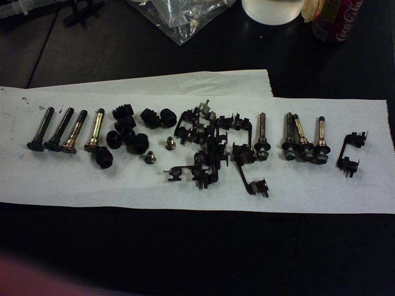

Then I thought it would be a good idea to clean off all the clips and bolts and other caliper hardware:

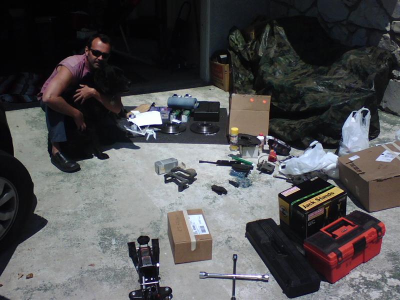

Saturday it was time to get to work. In exchange for those rear rotors and brackets, I agreed to help my boss change the rotors and pads on his CR-V, flush the fluid, and put new pads on his wife's Forester. Here is all our stuff and him and his dog:
We put the CR-V on jackstands, pulled off all the wheels, and I took off the front caliper, cleaned off the bracket, greased the pins and all that junk, then put it back together. It was soon apparent that the rotors we ordered online were the wrong size so we put the old stuff back on, slapped fresh pads on the Forester, and got to work on my car.

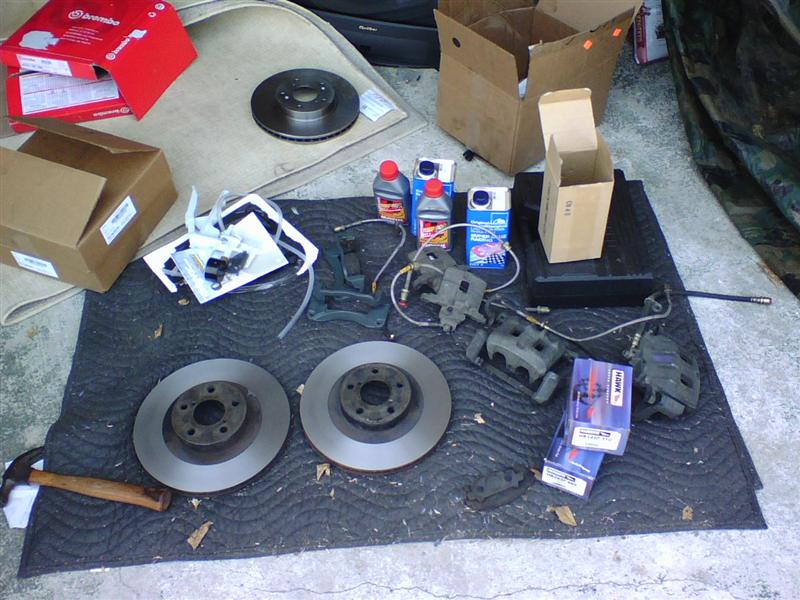

Here's the stuff I put on:
What is it all?
WRX front brakes
'H6' Legacy rear brakes
Goodridge stainless steel lines
Axxis Ultimate pads
Motul RBF600 fluid.
That other fluid and the Hawks were for the CR-V.
So, my old front rotors are somewhat smaller than the new ones (260x22mm vs 294x24mm):
The calipers also have an extra piston each.
The rear rotors are also a bit bigger (290mm vs 266mm), and the new rear calipers also have bigger pistons.

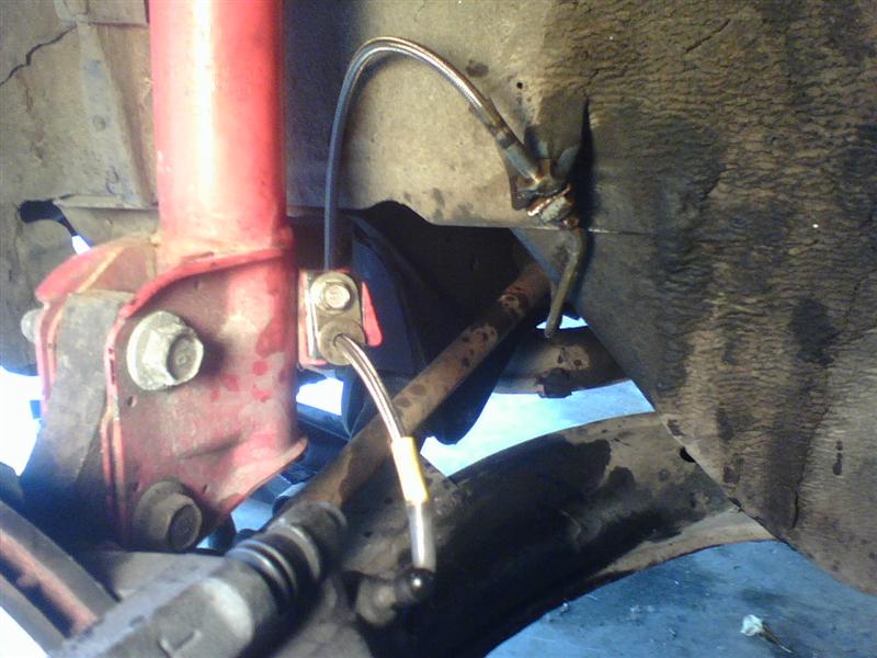

Then quickly detach the old lines and put on the new ones. Thankfully they all came off without trouble after being attached for 14 years.
Hey that's interesting. The new WRX lines bolt up to my struts. Why is that? The struts are out of an STi. So I no longer have to use zip-ties.

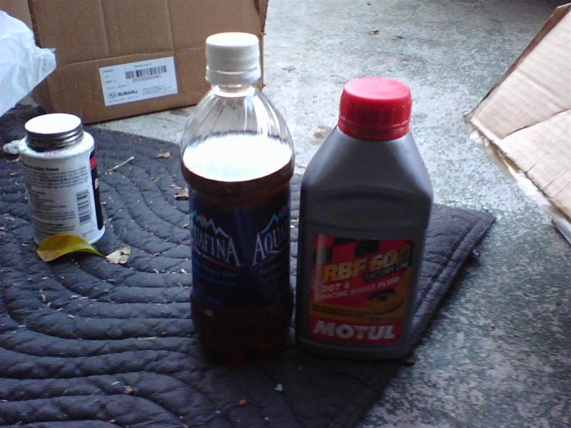

I bought a mityvac at Sears before I did all this, so flushing and bleeding the brakes was a piece of cake. Pump vacuum handle, crack bleed screw, keep pumping until new fluid comes out. It took like 2 minutes a corner.
Old fluid vs new:
As far as I know it had never been changed. Also it wasn't quite that nasty because some of that came from the calipers and lines that had been sitting for like a year.
