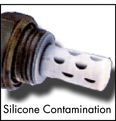

This was the 1st time replaced at 125,000 miles. No, I haven't taken it out to look for "poison" What would be the signs?
