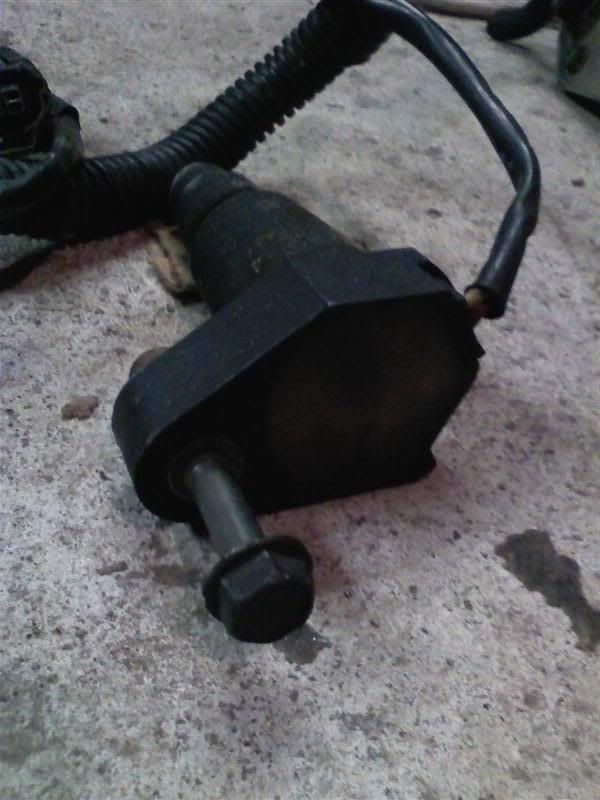

Anyways, the spark plug wires are red in these pictures. You can't miss them. Just pull these plugs out, they may look a bit different on yours I'm not sure. Once the plugs are out you'll need a deep socket, I don't know what size but usually a tool kit will have 2 of them designed for pulling spark plugs with a rubber piece inside that grabs the end of the spark plug so it comes out with the socket when it's loose.
It's a really tight fit so you'll probably need to remove your battery and the air filter box to give you room to get your socket wrench in there.
I think you have the twin turbo motor with the coil on plug design. So you'll need a 10mm socket to unbolt the coils which are on the spark plugs on the sides of the motor.
MAF = Mass Airflow Sensor. It's also called AFM or Air Flow Meter and it might have another name, it all depends on the manufacturer. I think toyota might call theirs AFM. It just reads how much air is coming into your intake. Should look like this.
The MAF is located at the end of the intake hose on the left side of the picture. You can barely see it.

Thanks for the photos Kimo.
It´s going to be tight, I never saw the red cables. I´ll check it and I´ll post a reply.

dzx: I even cant see the coil pack in my car.
Kimo: I recognize the MAF ! that´s something
