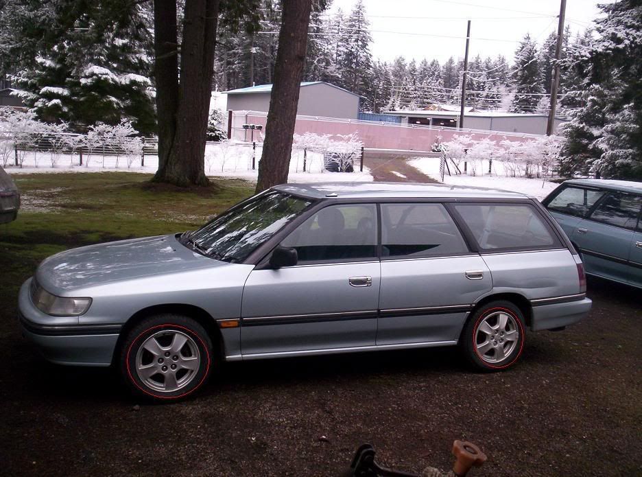

I went wheel shoping yesterday at the local used auto parts emporium (wrecking yard), and found a set of really cool 15" 5 spoke wheels to put on my '92 Wagon. Believe it or not they came FACTORY on a 99 Chevy Cavalier!!! FWD GM is a 5 on 100mm bolt pattern, same as Subie, and the offset is almost perfect. They are a little wider than factory Subie wheels, but fit great. Have 3/4" clearance at the strut, and they sit out about 1/2 to 3/4" wider , just enough to fill in the wheel well better.
Right now they are on my '90 White wagon to test run them for issues (had none!!).
Now I just need to epoxy in the chevy bowtie logo and paint the center caps...
Thought I'd open up another cheap wheel option for everyone

Thanks for the compliment. I've taken them off the white wagon and put them on the Ice Blue '92, and wow, I like. Will post a pic later.
As for the donor Cavalier, they had different trim levels... We do have a couple of other Cav's with steelies and caps. But, ANY fwd late model GM will have the same 5x100 bolt pattern as the Subies.
Also, I measured the hub and the wheel hole diameters. There is only a 1/16" difference, so I'd need a 1/32" wall thickness spacer ring!!! A couple of wraps of stainless aircraft tape would take that up, but I'm just going to run it as is.
