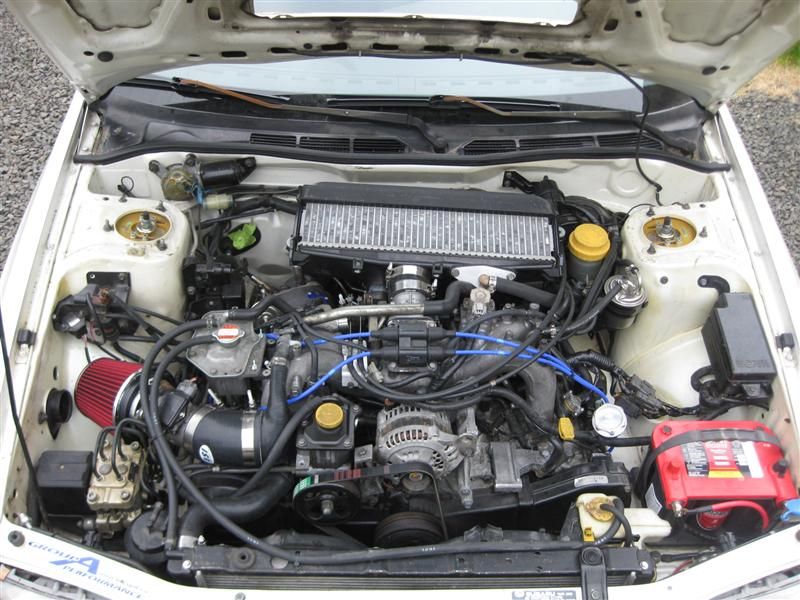

I put a hose clamp on it. There was only one place in the plumbing that wasn't clamped and that was right at the intercooler. You can see it here:
