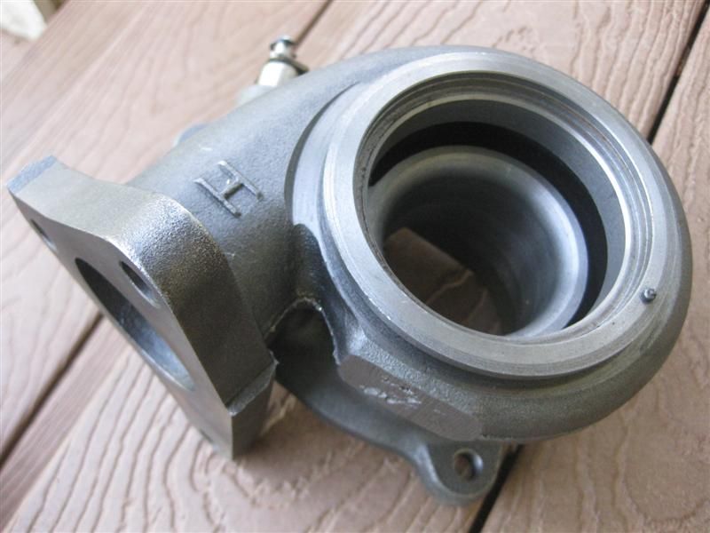

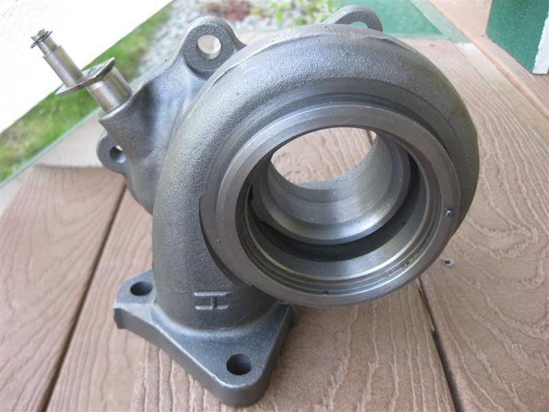

I sent my turbo hot side in to grimmspeed to get it coated because I didn't feel like taking another trip up to performance coatings and their ceramic coating doesn't look nearly as good as performance coatings. It looks like it's just been spray painted in comparison. How well it works in comparison I'm not sure because I wrapped my turbo in a heat blanket.
Here's before and after with grimmspeed coating.

Actually after taking a second look, it may have been the Satin Gray Ice that I chose, which is on the website. When you think Satin you think flat and this is not flat at all.
