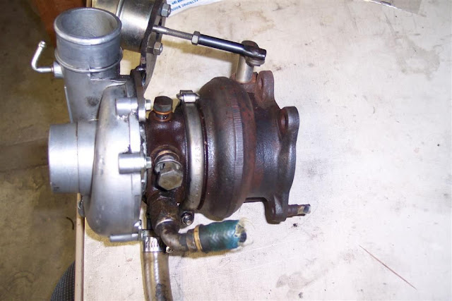

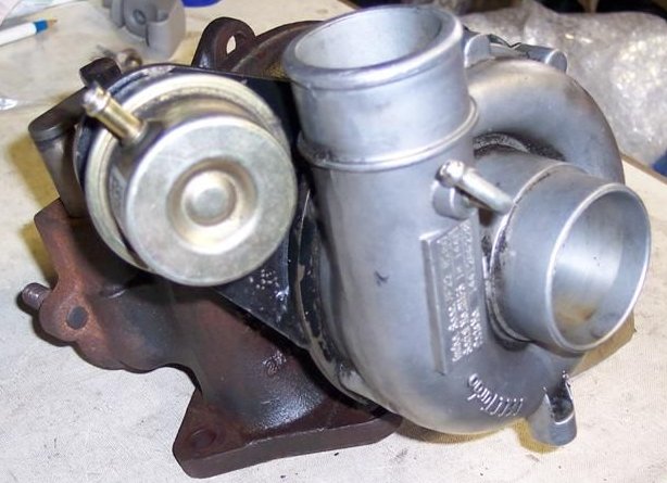

I bought a VF22 that I'll likely sell on here soon, but it came from a rotated setup.
EDIT: It's 'clocked' not rotated.
Can I just loosen the clamp on the exhaust side and rotate it back to stock location?
Thanks

post a pic of the turbo and i can tell you if you need to rotate anything.
a rotated setup usually refers to the turbo placement, its "rotated" twards the right side of the engine bay

MikeyMeyagi wrote:post a pic of the turbo and i can tell you if you need to rotate anything.
You are correct....it's clocked not rotated.
Can I move it back?
Thanks
See below:

Re: Clocked Turbo - back to stock?
Just loosen all the bolts a little bit (remove the 2 on the wastegate) and rotate the compressor housing 90* clockwise and put the 2 bolts for the WG back into the compressor housing and tighten the rest
