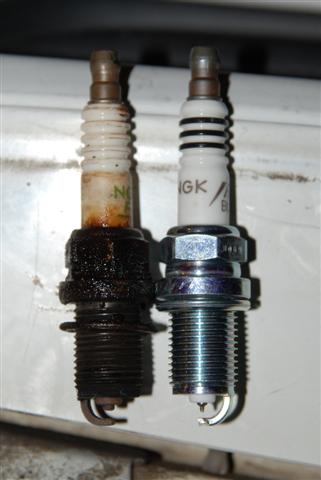

I think there was a leak between my turbo outlet and my intercooler y-pipe. The silicone coupler had slipped a bit. I have the stock '06 wrx y-pipe and it seems to be quite restrictive and a bit flimsy. I will order a cast aluminum/silicone coupler y-pipe to replace it.
The old plug weren't terrible but they had worn quite a large gap. I wanted to put some NGK iridium plugs in anyway. I have them in my forester and they are really smooth. I plan to put in a set of MSD coils soon and some better wires.
Thanks for all the help!
Here is a photo of my old/new plugs for comparison

It sounds like it may have been a combination of both, plugs and intake leak, which caused you to go too rich under boost.

those plugs were ridiculously fubar, good that you got it back to prime.

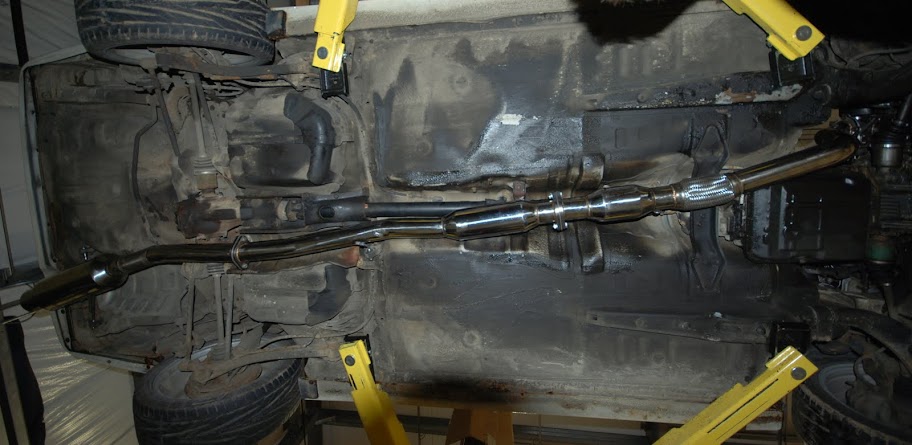

I bought the 3" exhaust on ebay. It is designed for a 2002-2005 WRX but we have the same turbo flange on the down pipe and very similar geometry. I had access to a hoist, welder, air tools, etc because I am an aircraft mechanic. However there were minimal mods required to install the system. The kit cost me $350 CAD shipped to my door. Crazy cheap and the system is actually really well built. I believe it is copied off a Borla kit. I remounted a few hangers and added aprox 6" of pipe to get my tailpipe just tucked under my bumper.
I documented the install. I should post it over the holidays. The difference in flow is HUGE! The engine has way better throttle response and the turbo spools up a lot faster. Oh and the kit also comes with a 2.5" stainless up pipe with bolts right in.
The exhaust note is awesome! It really brings out the boxer rumble but is still quite enough for a daily driver. I will do some videos so you guys can hear what it sounds like and will post the links with my install thread.
If you are interested in more info regarding the exhaust kit here is a link to the ebay page.
http://cgi.ebay.com/ebaymotors/3-4PCS-S ... 572wt_1165
Here is a photo of the exhaust system installed on my 93 wagon
