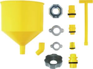

False he said he checked for blow head gasket you are going to stress the guy out
Invest in one of these
this tool will make sure you burped the system all the way. Make sure you read the directions.
This should take care of your problem if not come back and tell us what you have found when trying to burp the system.
Also if the system is burped properly the fans will come on at idle.
