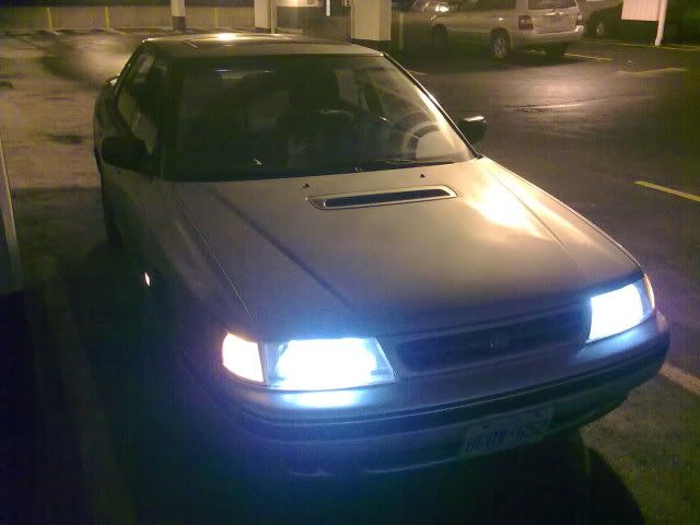

Hey guys, getting sick of not seeing the road lol. I am thinking of getting bixenon's I understand there will be alot of glare, but has anyone actually tried a kit? I want that white light, but I also want BRIGHTER light, and it seems like this just can't happen. Bought several bulbs, idk, i tried this last set and they look nice, but produce like 0 light on the ground now.....
Will there be anymore light on the ground with hid's?
These are what I am using now, and there is no light produced just looks nice since there is so much tint on the bulb's. The lights look like completely white in person and clear, not blue and blinding.

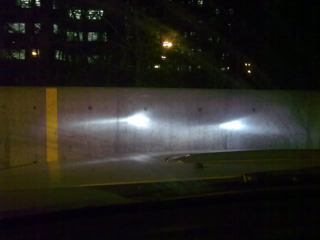

Here's an unaltered shot. (92 Legacy Wagon DDM HIDs Lo/hi kit 4500K)
Had to turn down the exposure to see what they look like:
the "highs":
about 25 feet away:
Lows:
"highs"
