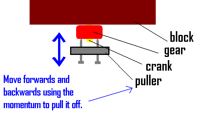

Yep. Here's what I did. I got this crappy little gear/steering wheel puller with two screws
on a bar and the big screw in the middle. You dont want to use a standard gear puller
because you can break the little teeth marks off of it.
This one:
I didnt want it to tear the living crap out of my crank bolt since mine
was pointed at the end. Take the big screw out of the middle. Screw
the two smaller screws into the screw holes of the crank gear. Then
push the bar up against the crank and pull it back along the screws
really fast. Keep doing that until the gear backs itself off.
Posts: 27930
Re: Car shut down while driving.
Just for future searching purposes, the crank gear has threaded holes in it so you can use the pullers. This is the kind I've used before.

Car is back together and running great. Thanks for all the help. My crank gear and the new one I got did not have the holes threaded in them. Used 7mm bolts and they threaded themselves in just fine and that way I was able to use the good puller and finally get it off.
