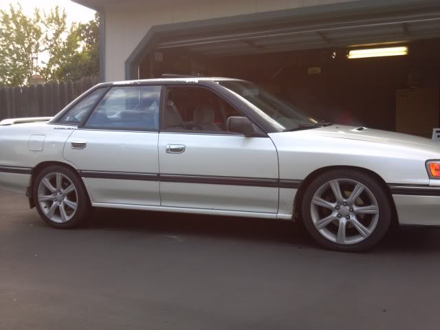

That car was a non-turbo car. The A/C is from the non-turbo setup as well as the transmission. The hood & brakes appear to be upgraded to the turbo parts....

Really? good eye. someone took alot of time on that swap then :shock:

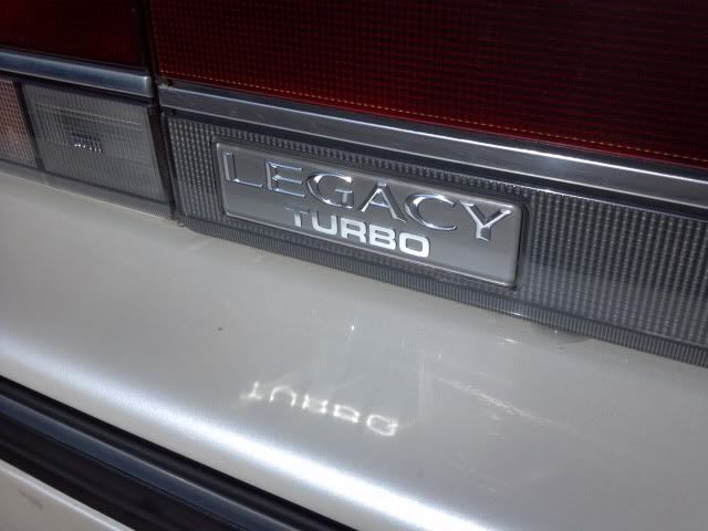

actually that is a turbo josh. Thats an auto transmission, and the 1991 turbos didnt get the a/c line with that weird bend in it by the turbo. look on the strut tower and you'll see the lines for the boost control solenoid

Yeah I thought it was a legit turbo as well but didn't have the sand to question Josh...

You're right it is. I didn't know the 91 turbos didn't get the little hump in the AC. That's interesting.
