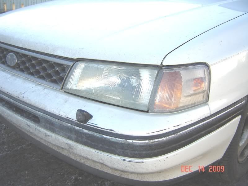

This is an old discussion, but I started it and wanted to let any one know that the washers have been installed and they work perfectly. This Monday I will try to upload photos of the squirters in action. The Euro washer tank hold a gallon of fluid, and the washers pretty much pressure wash the headlights.

It's wired directly to the battery with a 15A fuse and a relay and as long as the dash switch is being pushed, the pump runs. European setup has a "timer" that shuts off pump after 2 seconds even if the dash switch is being pushed. The switch is installed in my old Height Control switch location, next to the wiper controls (seemed a logical location) European dash switch is installed in empty cavity below defroster and cruise control switches (now you know what goes down there, next to fog light switch)
Corner lamp shown is JDM turnsignal lens (very hard to find) and I would be interested in buying a spare set. Not shown in the picture is matching JDM foglights that go below the bumper.

I have a set of JDM foglights that I can't use. I'm assuming that you have wired your turnsignals and your parking lights to the EDM corner lenses right?
