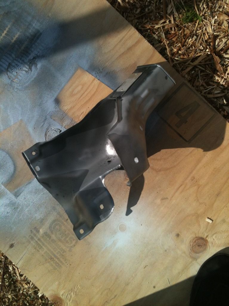

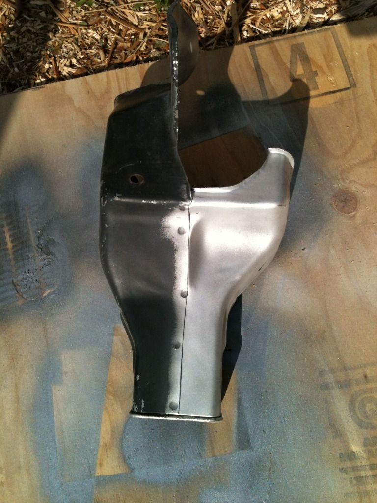

I looked around for something to experiment with, I happened to have an old Turbo-Chimney Laying around.
A little bit of time and It really cleans up!
Kinda a Before and after shot

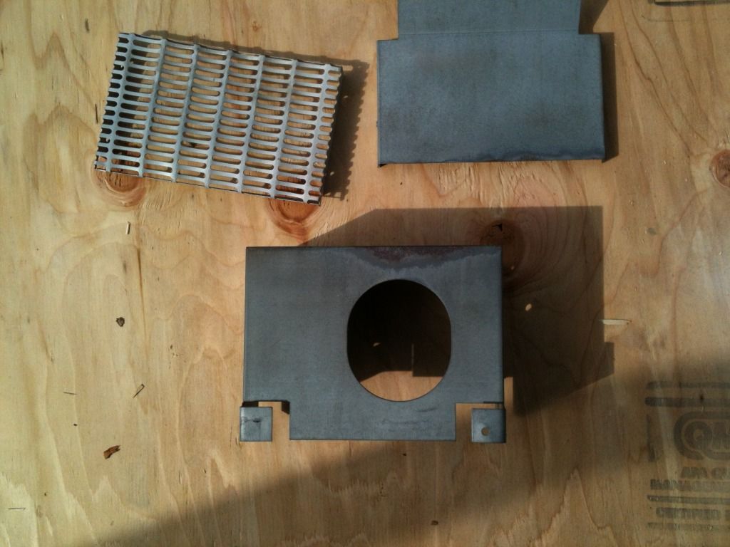

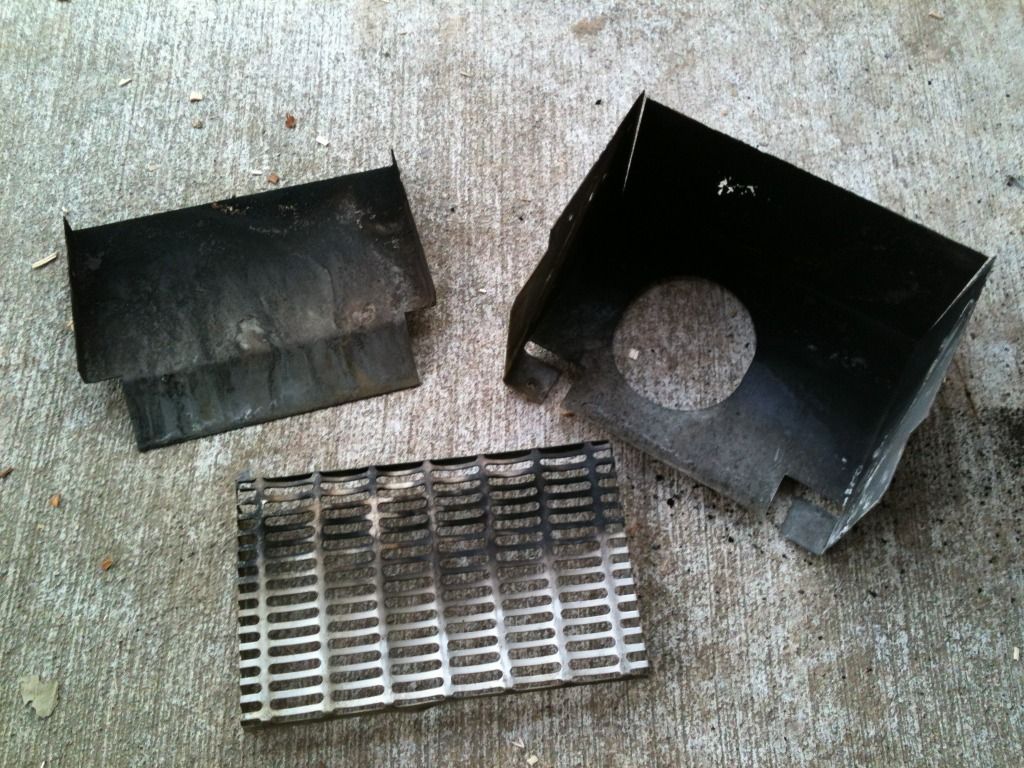

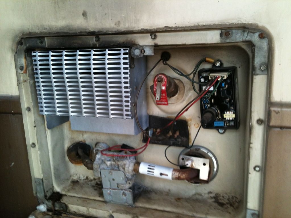

Decided to clean up the chimney on my RVs Propane water heater
Before
Blasted
Painted and installed (you can see the smoke stain above this pic. Which prompted the rebuild)
