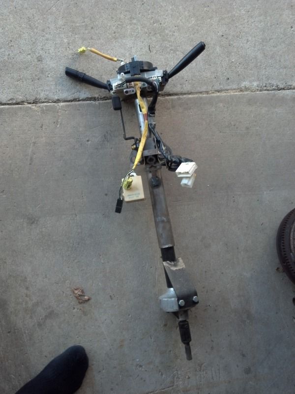

MConte05
Posts: 380
Joined: Sun Jun 26, 2011 6:50 pm
Location: St. Louis, MO
Re: RS Steering Column on an Legacy Turbo
Post by MConte05 »
Yea, the mounting is what concerns me.
That is the RS column that I am looking to buy. Trying to find a picture of a legacy column out of the car to compare mounts.
