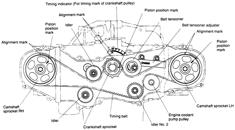

I know you said you checking timing, but just to double check, did you use the mark on the back of the crank gear?

well i even pulled the timing cover off the cam gear and lining up the harmonic mark with cam gear mark.Legacy777 wrote:I know you said you checking timing, but just to double check, did you use the mark on the back of the crank gear?
everything is lining up to where it needs to be.
used this for the timing marks

Yeah if you followed that, your alignment marks are good.

Is it possible to get the left and right cam sprokets swapped and still get spark? In other words does the engine reference the cam, crank or both sensor at startup.
I'm having a hard time grasping why you wouldn't get something with proper cam timing, spark, starting fluid, and compression.

It should be pretty obvious if you have the correct cam sprockets on as one has bumps on the back of it for the cam sensor and one doesn't.
As for as whether it would still get spark....possibly.
Re: car wont start, got spark but no fuel
They are also labeled L & R, but it might be worth a quick check. Easy enough to see.

The other day when i did a head gasket on an ej22e i had the cam sprockets on backwards (before torquing everything down) and noticed the pass cam gear was rubbing on the back timing cover. Took it off took the cover off cleaned the crap out of the cover around bolt holes. Put it back on and still rubbed. Took it off again and noticed the cam sensor spots. Pulled the other gear off and flat on back. Compared the two together and the marks for timing are in the same spot. I thought that was interesting.
