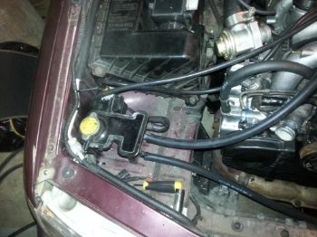

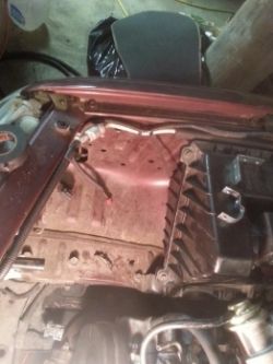

So I relocated the canister to where the wiper fluid is. I never used that anyways.

Then I put the turbo coolant box and my boost control solenoid in that area. this is keeping my engine bay more clean.

I fixed your original picture.
One thing to note about your coolant reservoir location, it really needs to be at the highest spot of the cooling system so air bubbles will go to that and then can escape. Additionally, with it in that location I'm not sure the convective cooling to the turbo will be effective or as effective.
