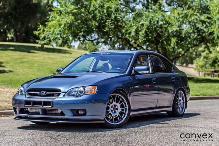

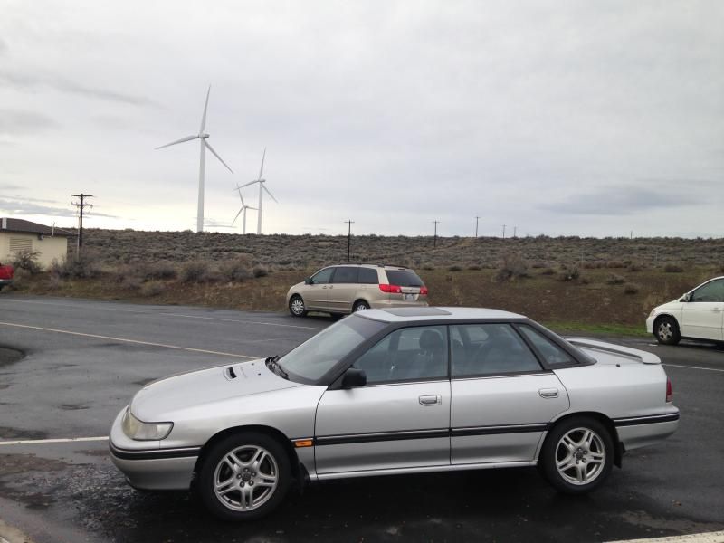

I have been a Subaru fan since I was able to drive, growing up in the pacific NW didn't help the urge either. I am the proud owner of now three legacys. A built 2005 Legacy 2.5GT, DD 1997 Legacy Birghton Wagon, and my new/old 1993 Legacy Sport Sedan. All of my friends had WRXs and STis but I wanted something different. I had been pushed internally to try to out do them by building my 05 to the point of unreliable. Blouch 20GXT, built block, full Suspension, loud external, and plans to make it crazier still. I had purchased another legacy to DD that I ended up falling in love with and then it happened.....my GT spun a rod bearing. It started to remind me how much I loved older obd1 cars and how simple they were and the really fit what I wanted in a car. The search began for the perfect SS and rebuilding my GT.
I made a deal with wtdash for his SS in Idaho and for all intensive purposes, the car was perfect. The few mods that were done made it perfect and I wanted a mostly stock legacy with zero rust and a good history. It has receipts like no other car I've ever seen and meticulously taken care of. I just picked it up today and now the journey begins to drive it back to Southern California from Idaho.
Here are a couple photos of my other cars and some pics of parts and parts list of what I've already purchased for the SS.
Stay tuned :)
My 05
My Brighton
And my new baby
