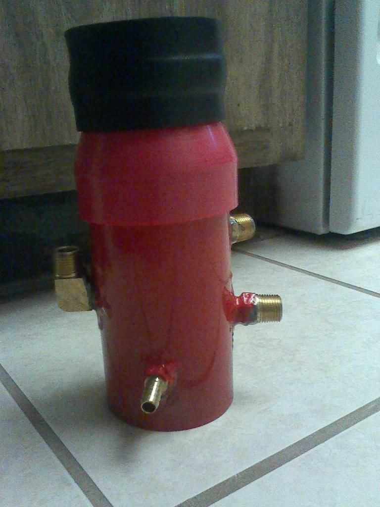

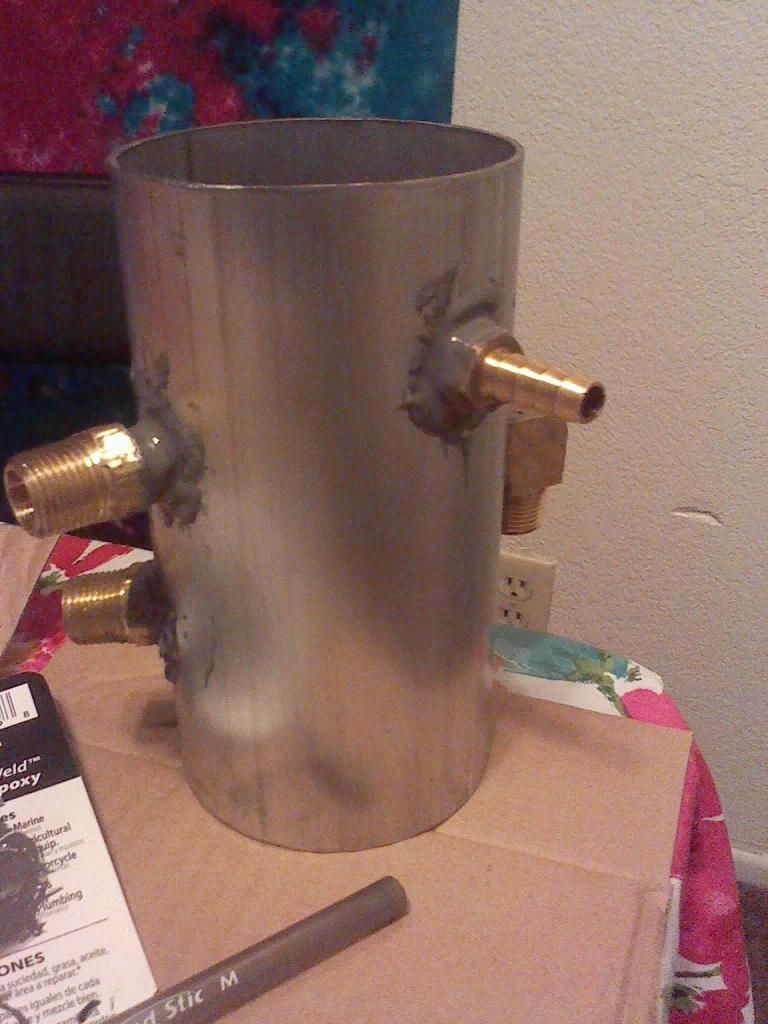

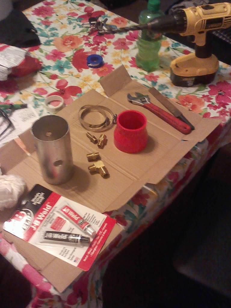

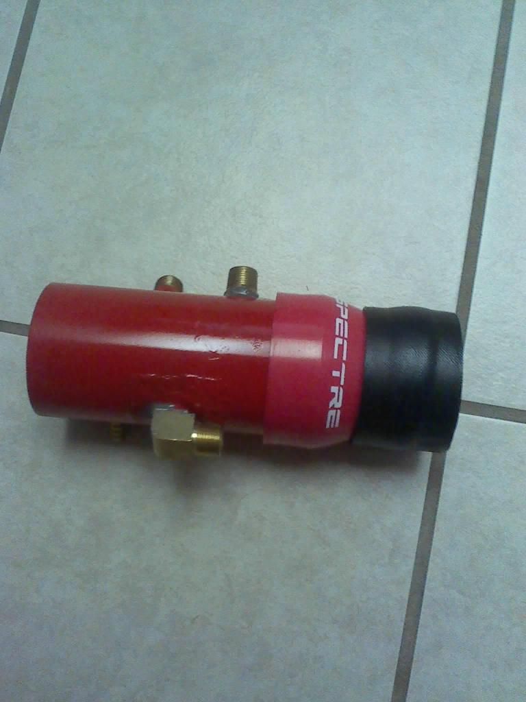

Its been awhile since I posted......(got busy at work). So here is what I came up with to fix my vacuum line issue.
I guess I would call it a coffee can mod, but I used a short piece of stainless steel 3in. Bought some brass fittings to fit the hoses.
Drilled some holes, and got some taps together to fit the holes and threaded my new fittings in tight. It worked better then I expected!

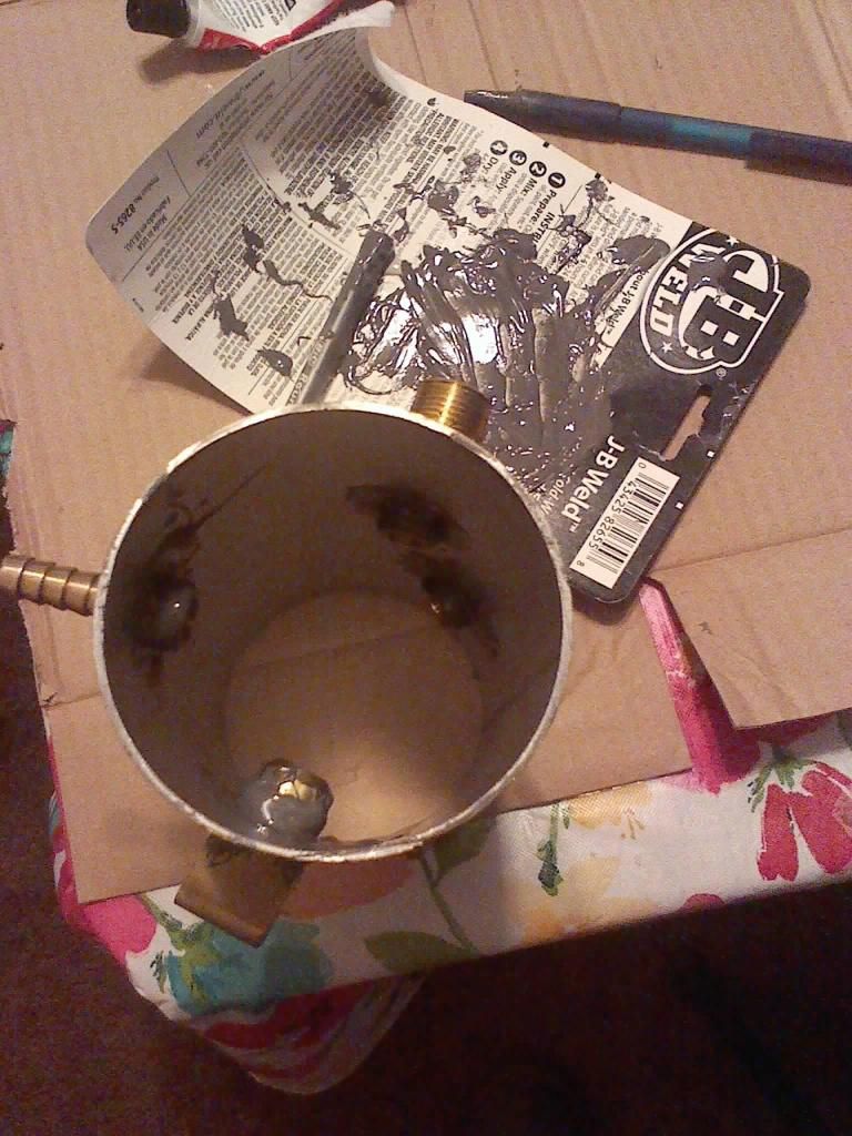

I was going weld the brass to the stainless at work, but I could find the right rods to do the job, so I picked up some JB weld. It worked just fine...
Finished product...........
Threw some paint on there and called it good. Its raining outside today so I wont be installing it on the car yet (wish I had a garage!) but I will get some more photos up when I can.

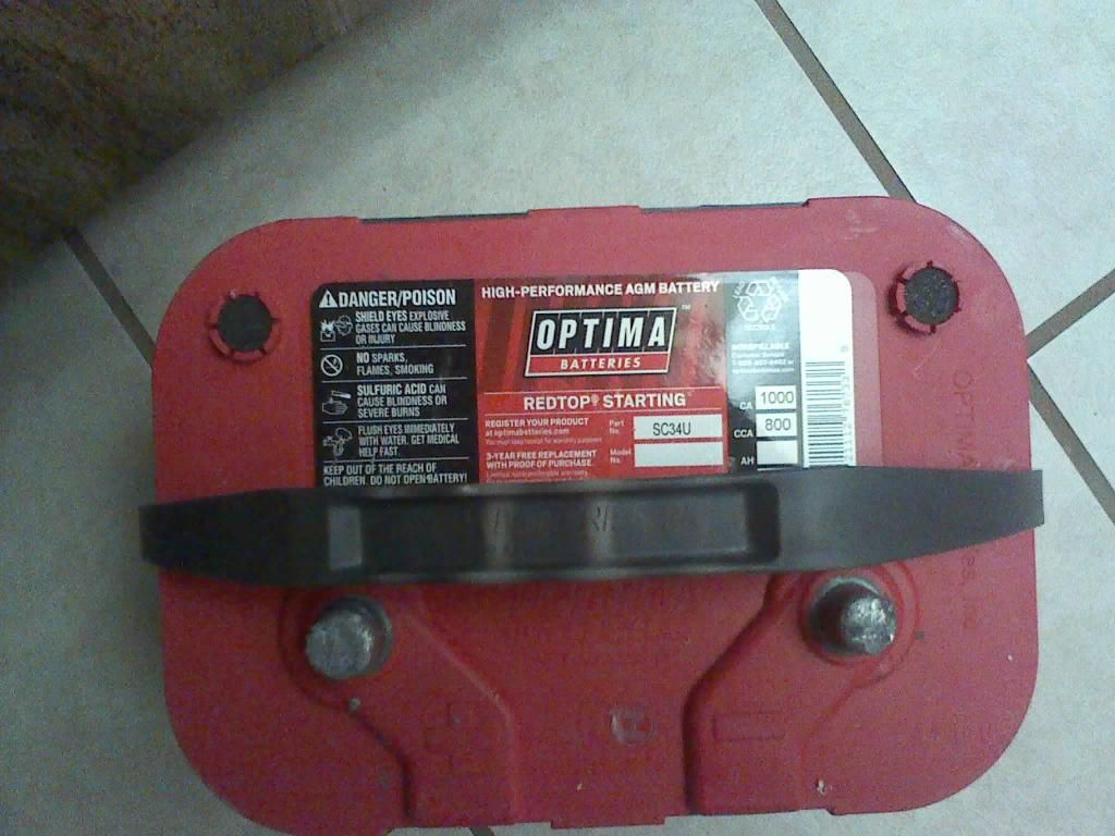

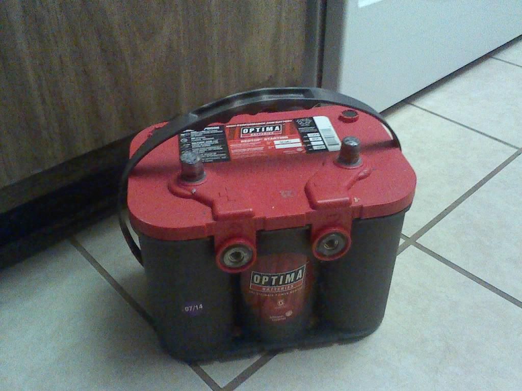

I also picked up this bad boy for FREE! Thanks to my buddy....
