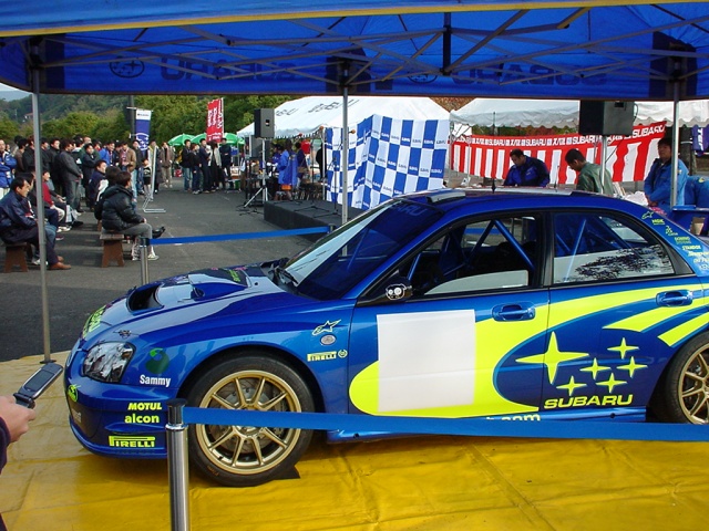

The Subaru WRC cars do have slotted brake rotors:
http://weakycars.free.fr/galeries/x_jap ... oto_01.jpg
http://www2s.biglobe.ne.jp/~edoyama/imp ... /wrc01.jpg
My personal take on it is that the extra cost of slotting isn't worth the improvement (if there even is any). Stock WRX front rotors can be had for as little as $55 new, and even cheaper lightly used. Slots usually cost nearly twice as much.
