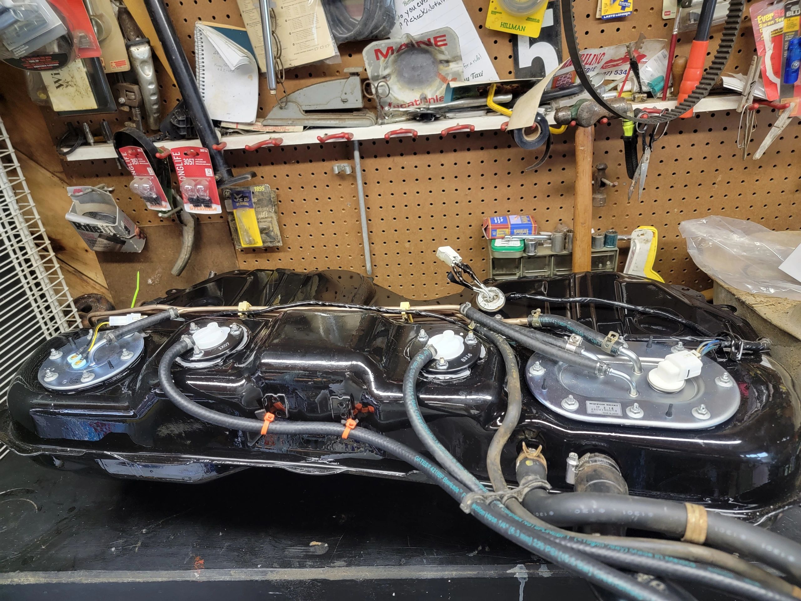

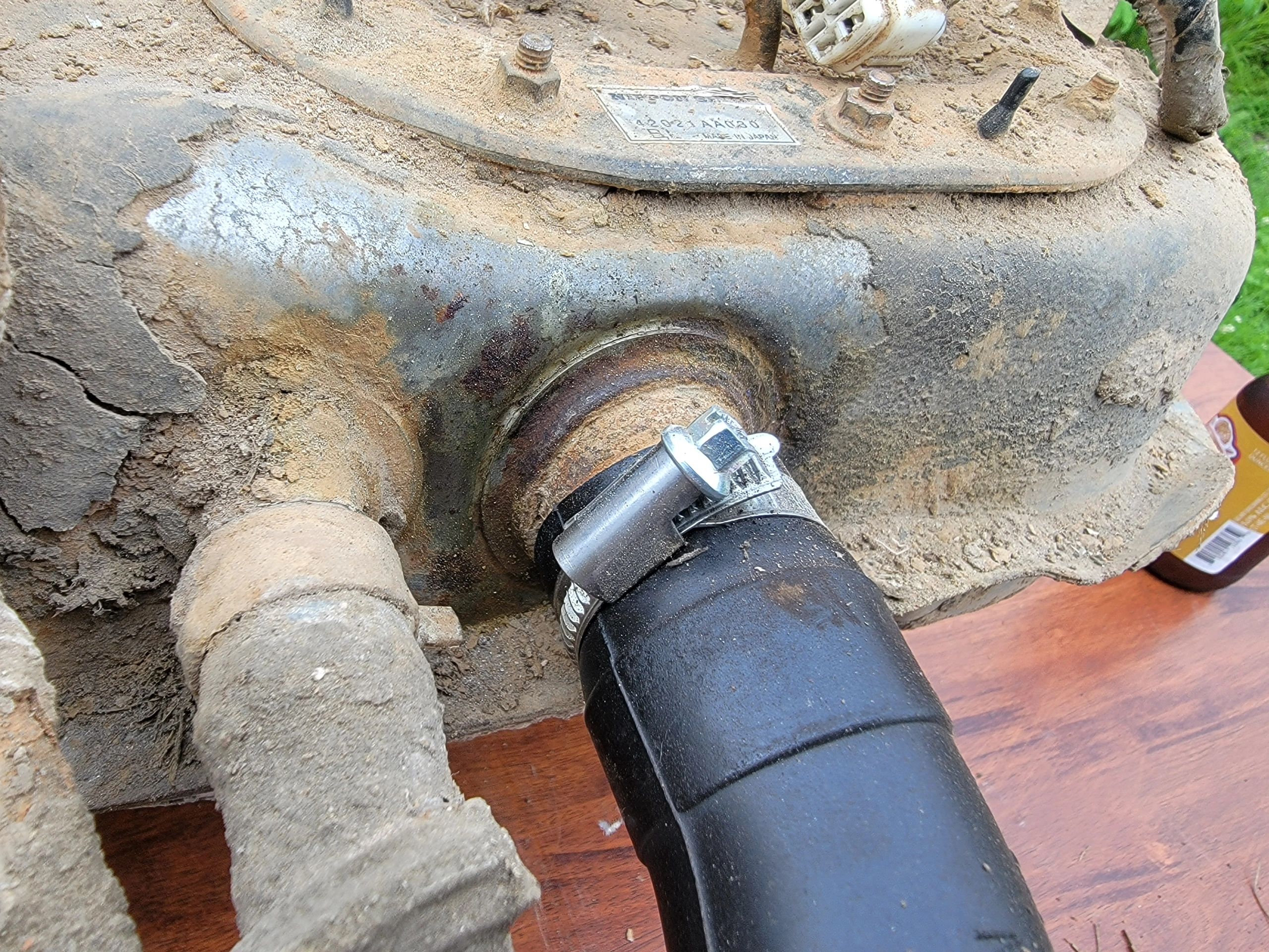

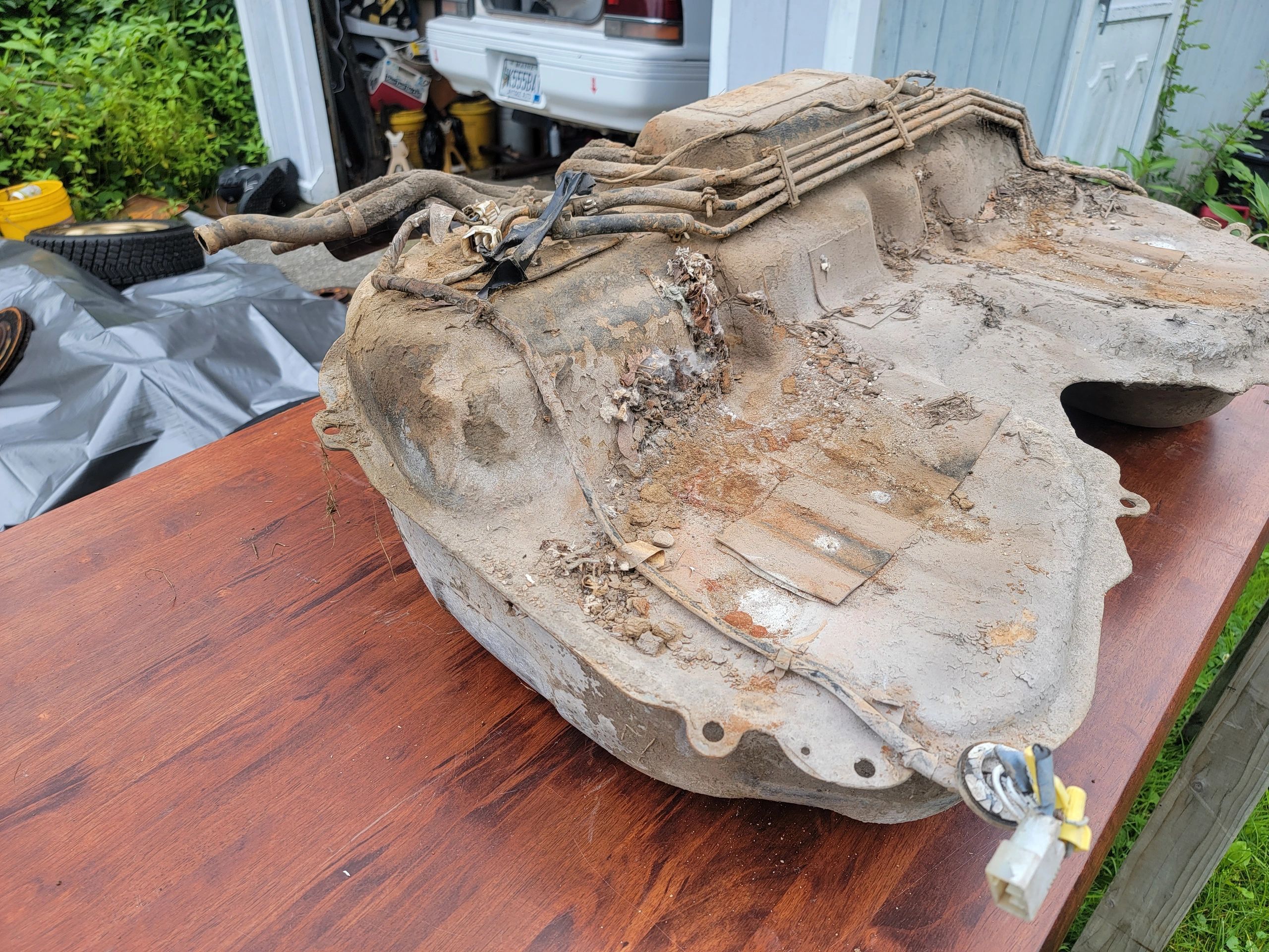

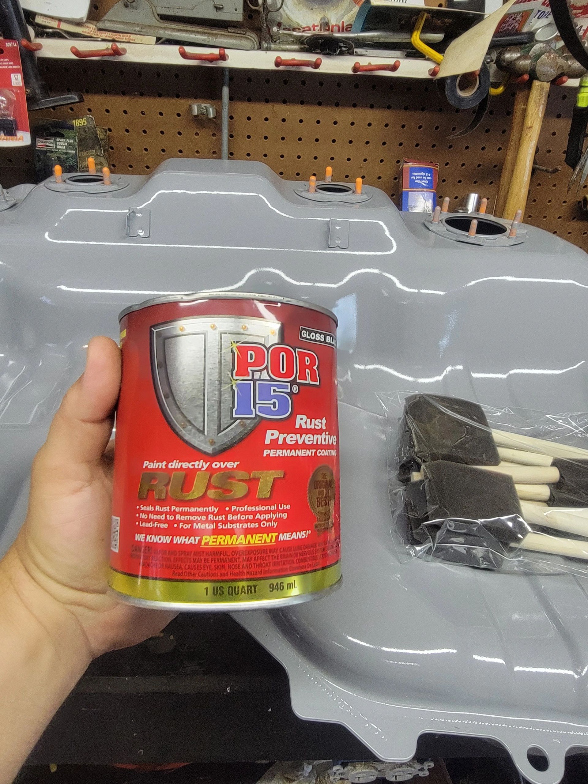

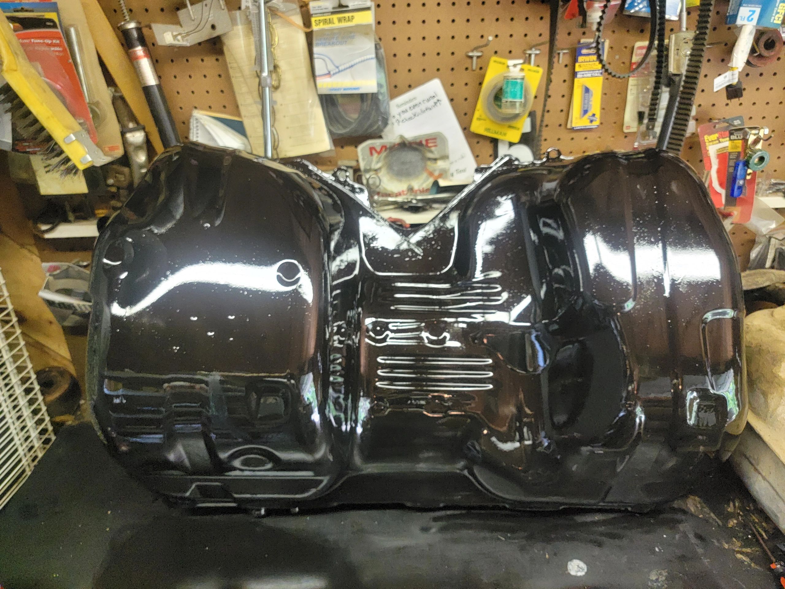

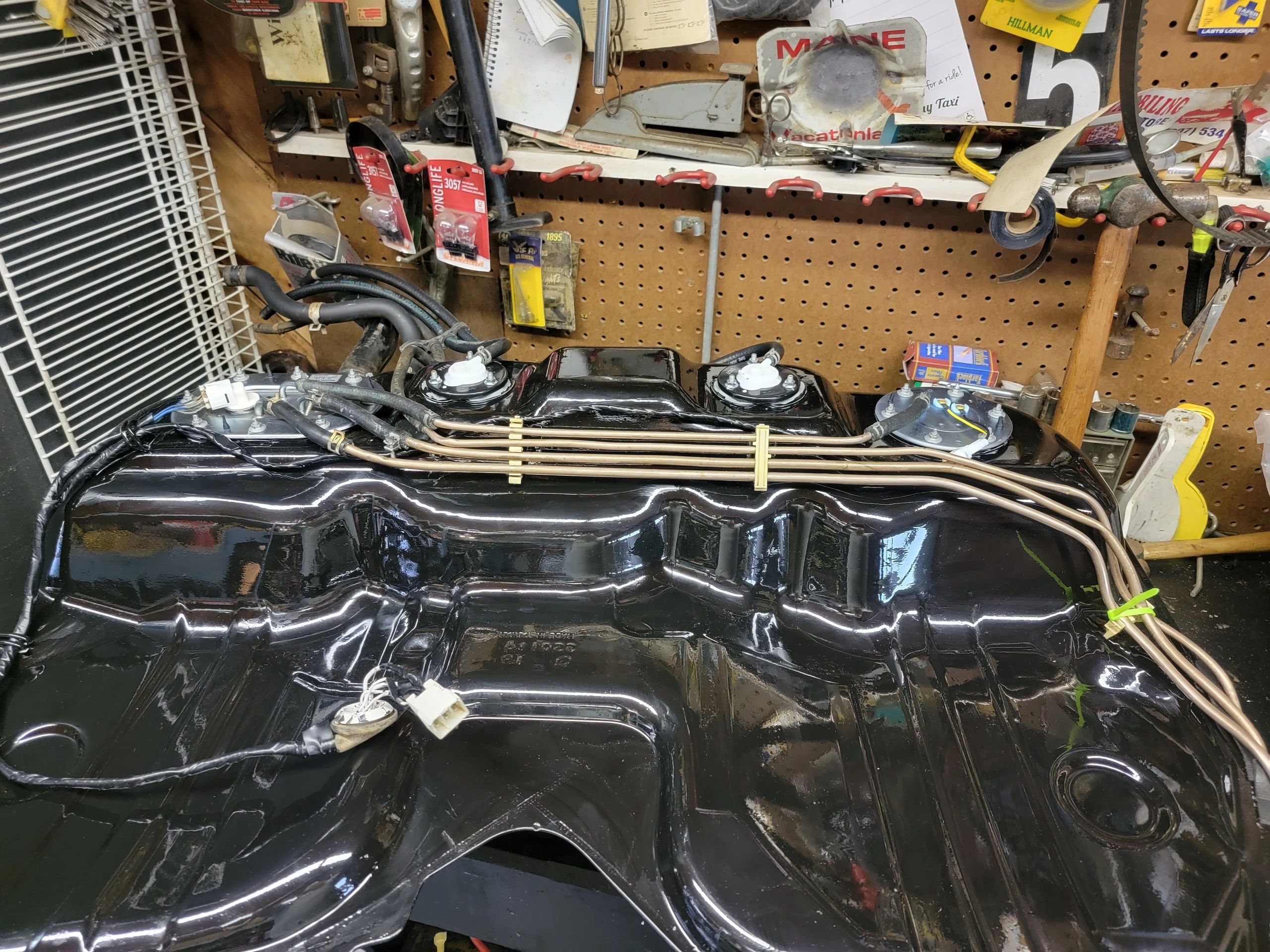

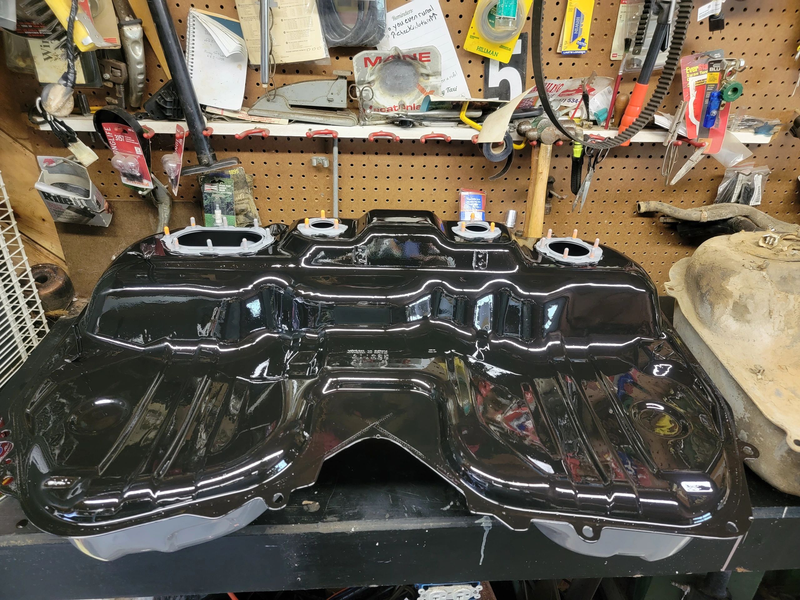

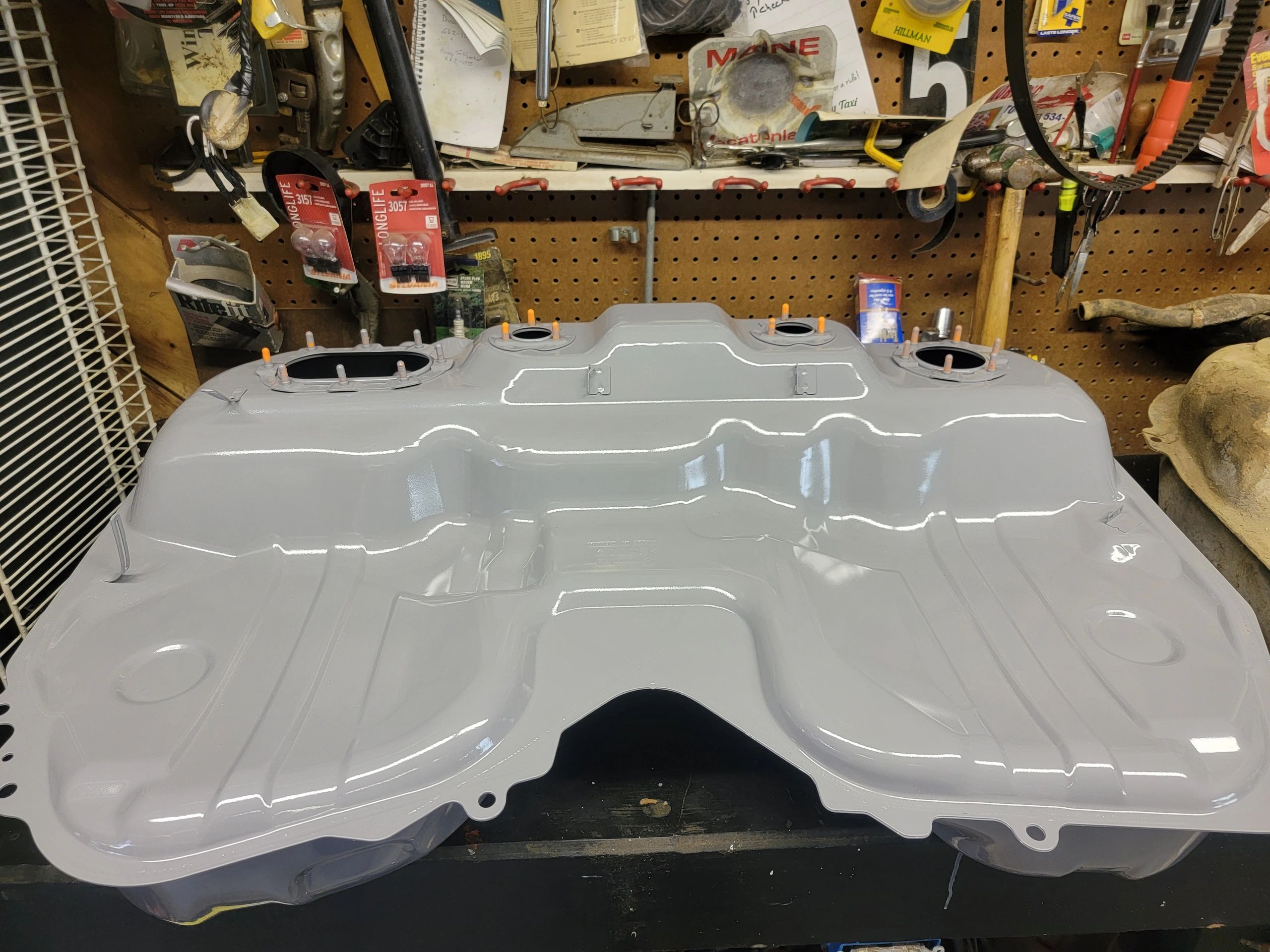

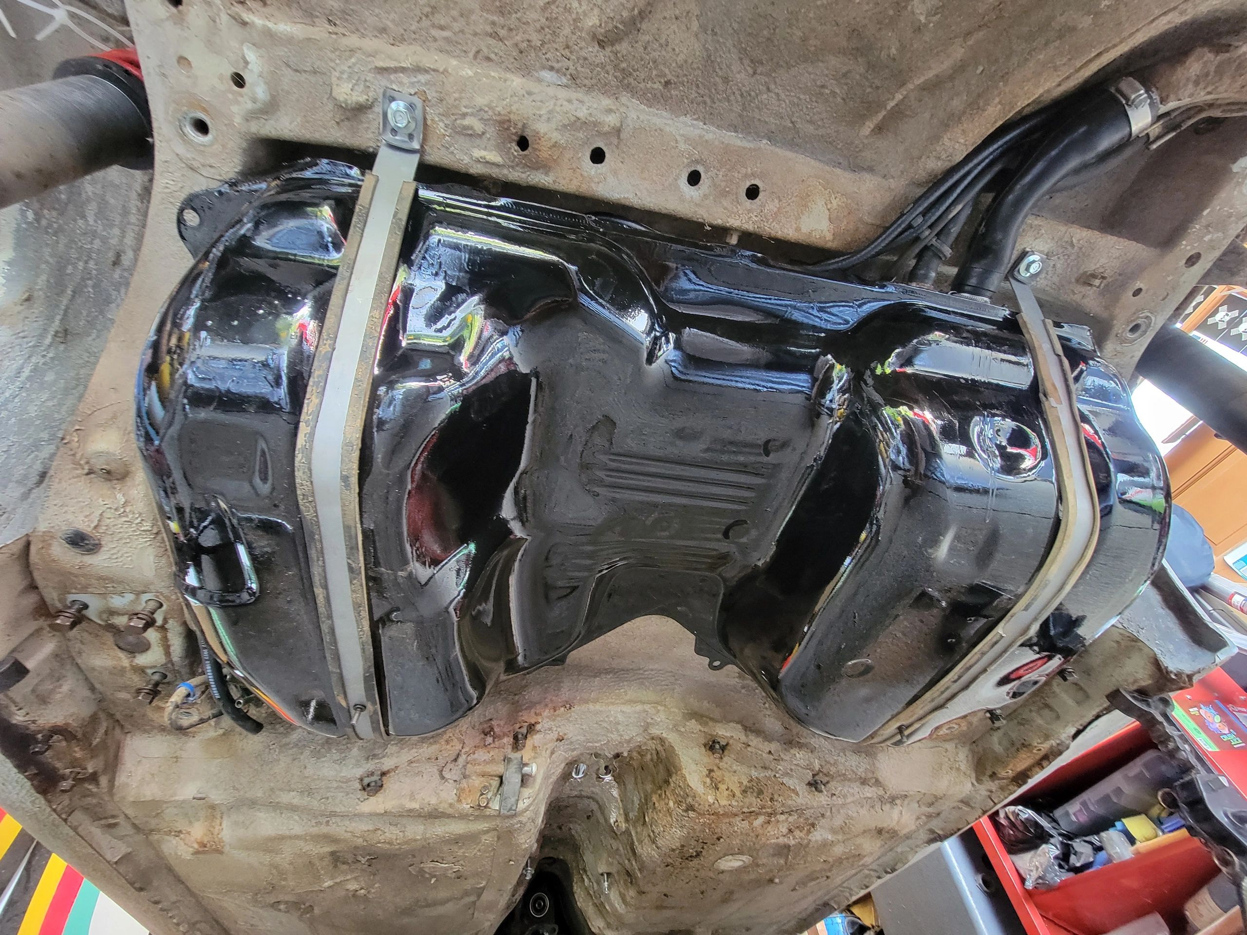

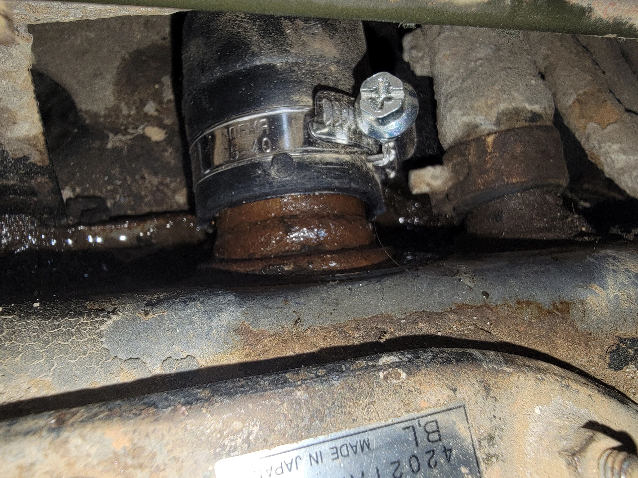

Now that the car was mostly built I took it out for some testing and to a couple RallyX events. Things went well until after one of the events I noticed a strong gas smell in the car when filling up. I did some investigating and found the metal around the fill tube on the tank had a hairline crack. At this point it was about finding a replacement. as well all know first gen legacy tanks are unobtainium. I ended up using a second gen legacy/impreza tank.

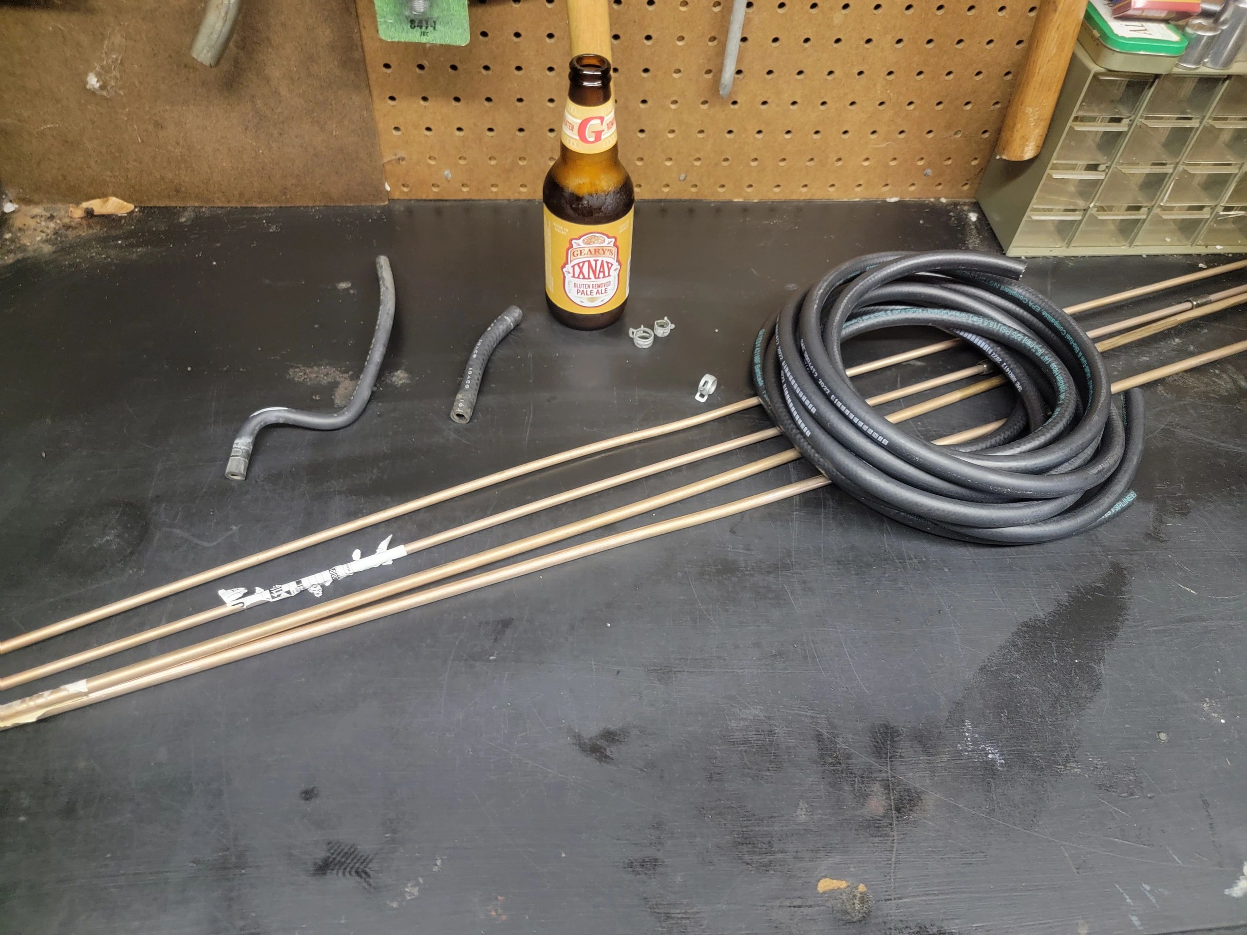

Then came the process of trying to figure out the built in evap stuff from the first tank that was not built in on the second. Once that was all said and done. I bought a brand new fuel pump and fuel sender, new copper nickel line and fuel hoses so I could bend my own lines, and a couple roll over valves. Then it was time to set to work getting the fuel tank out and replacing everything tank related.

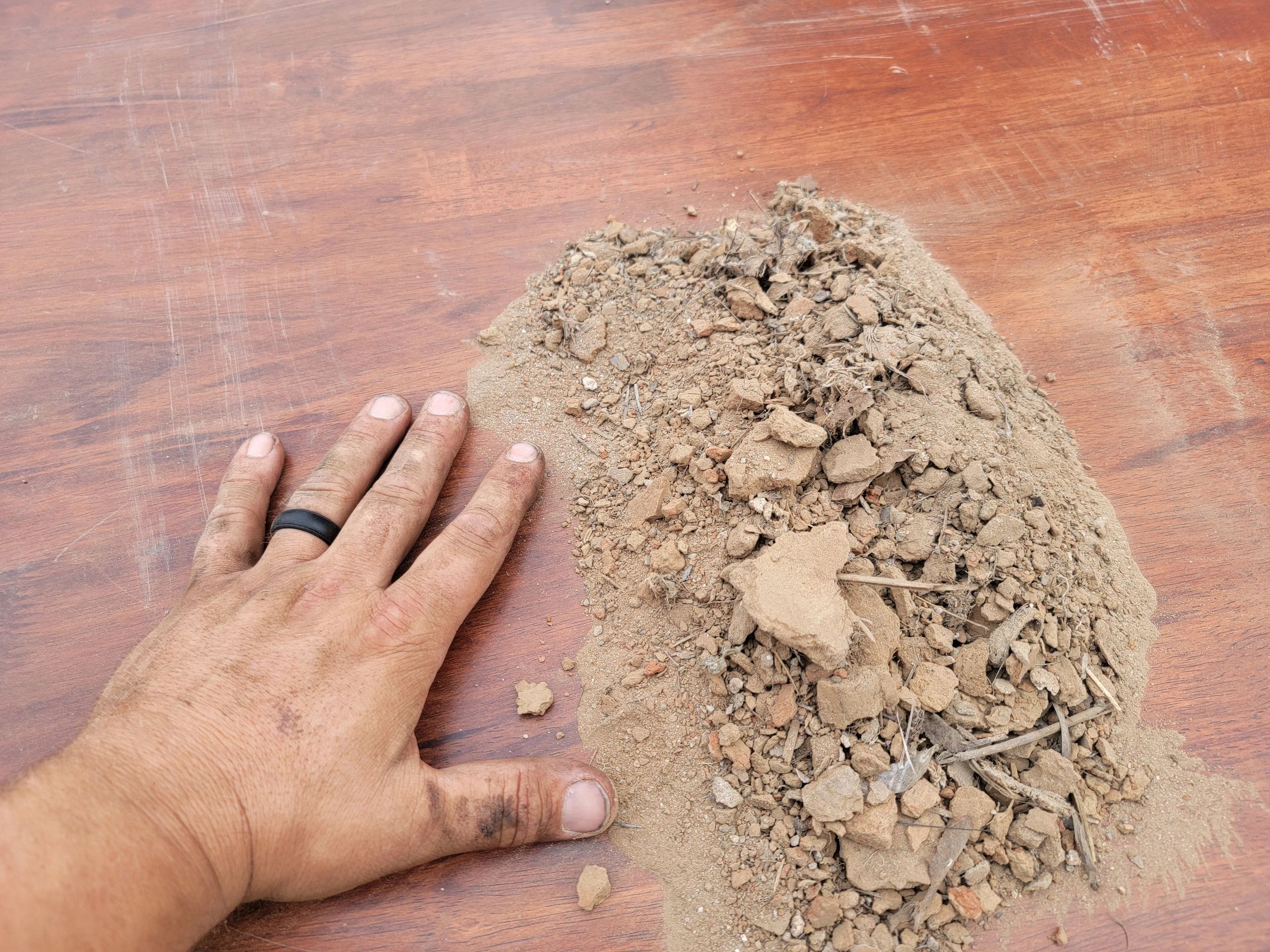

The amount of caked on dirt on the top of the tank was crazy!

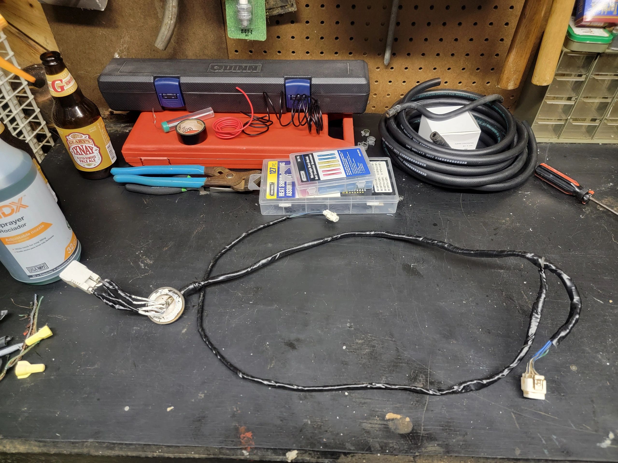

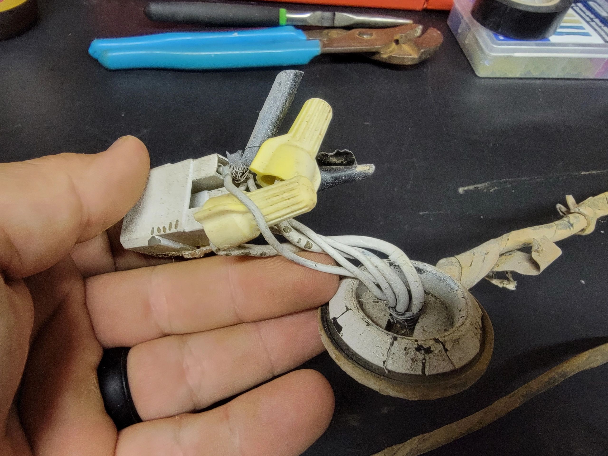

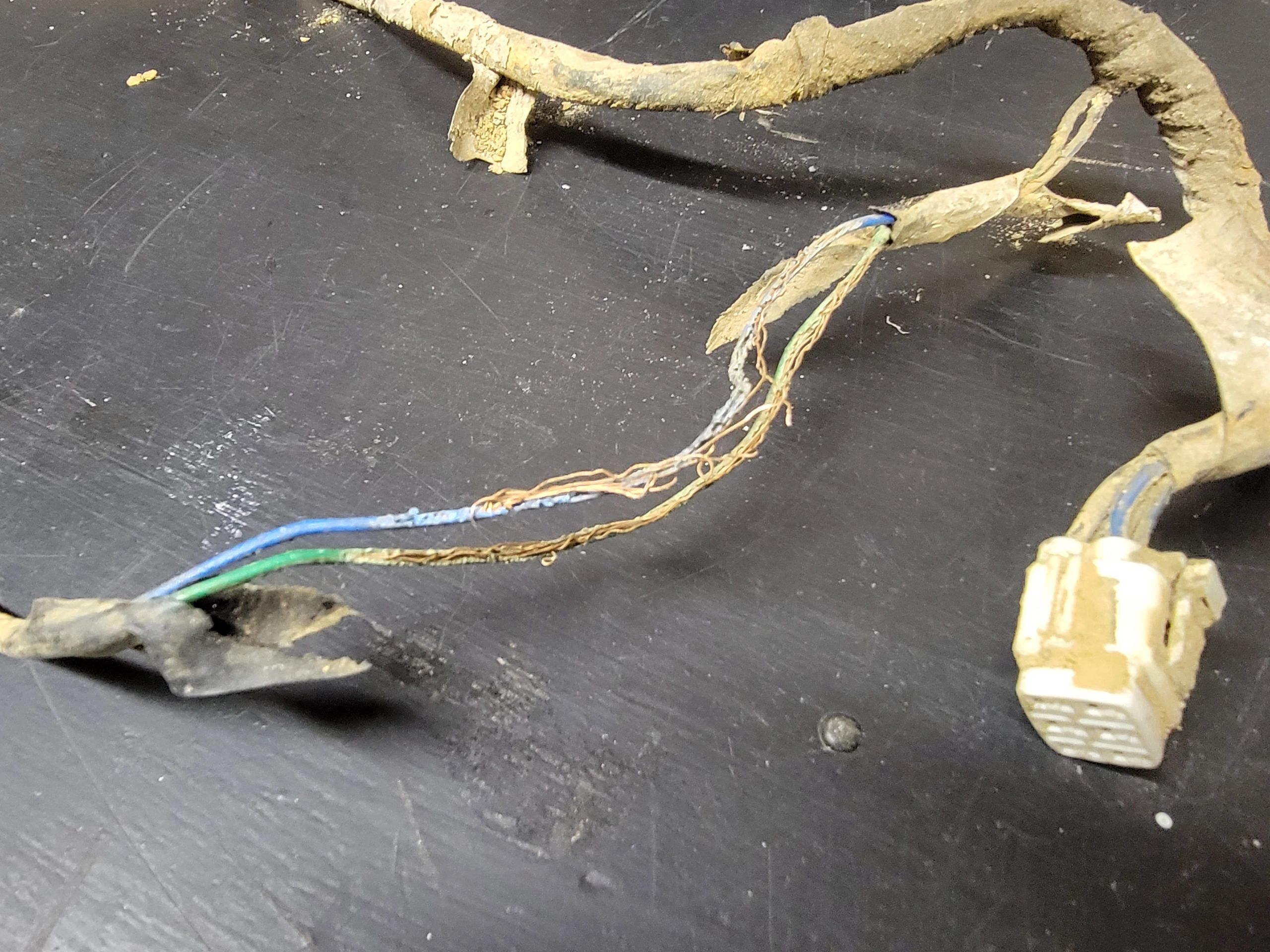

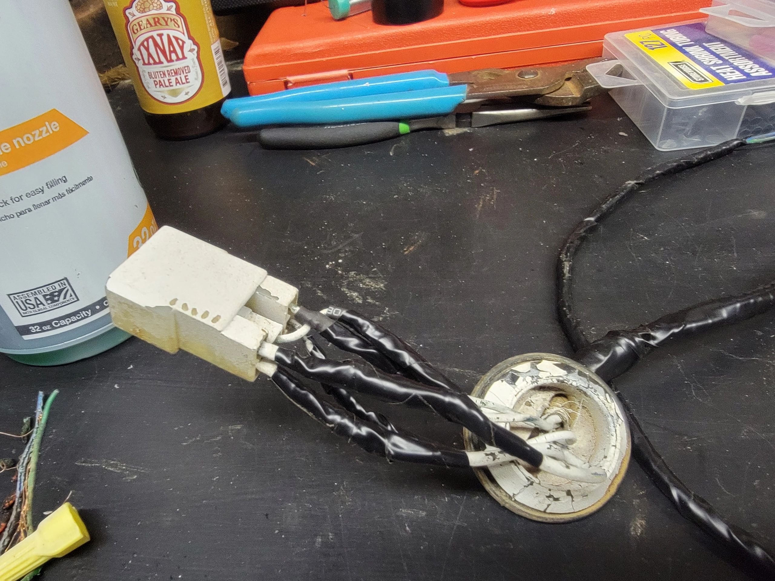

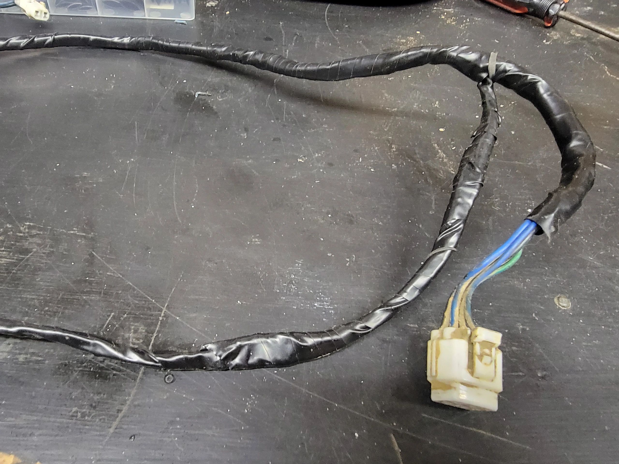

The Messiest wiring EVER
