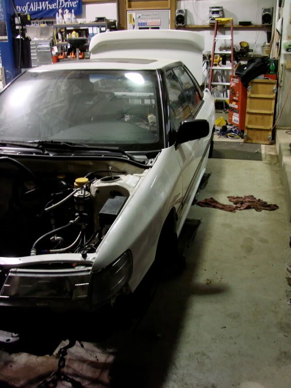

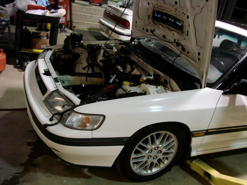

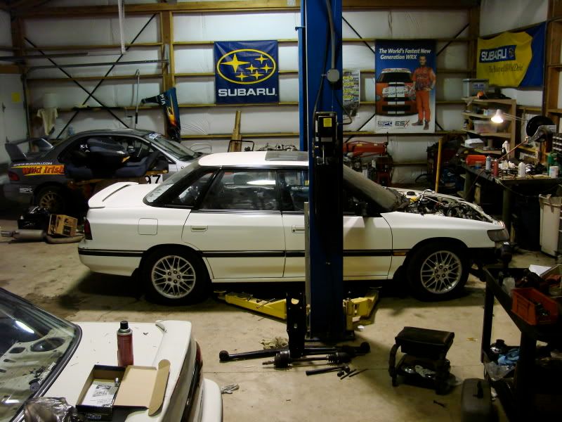

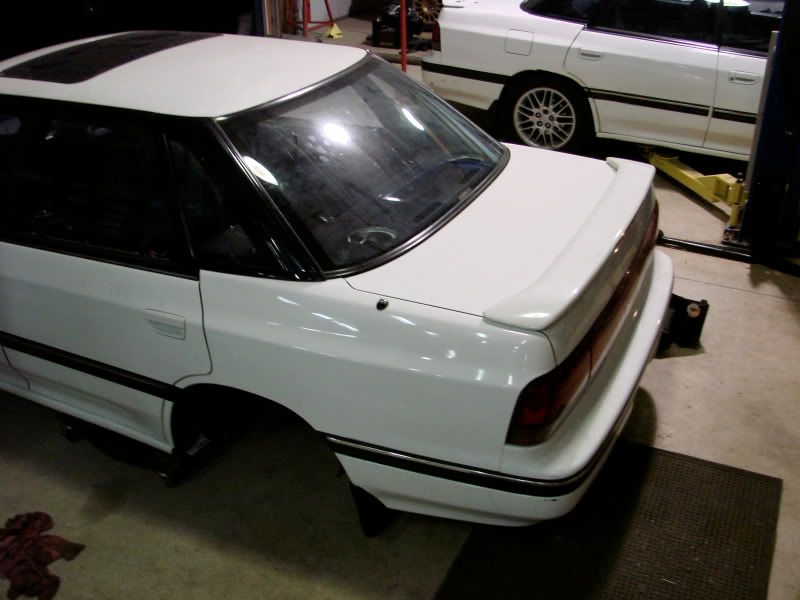

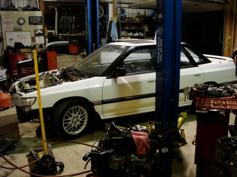

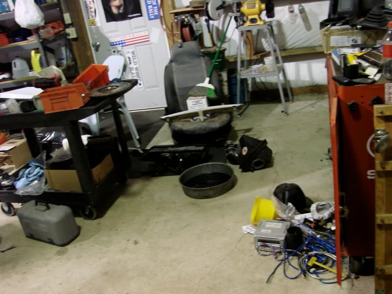

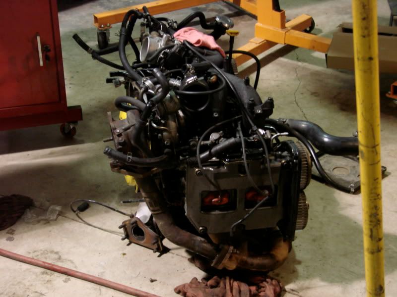

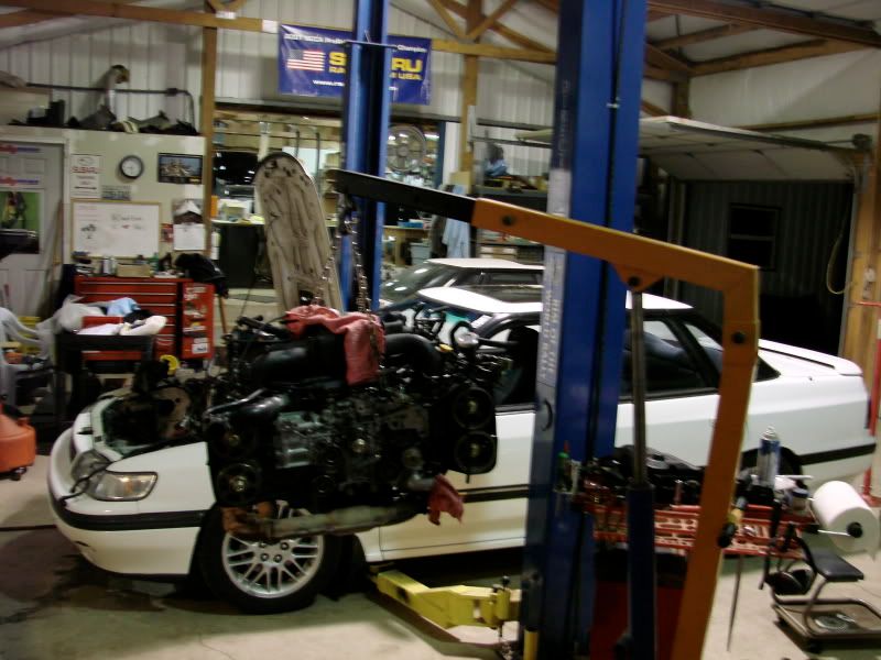

Here are some pics from today!!

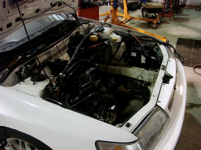

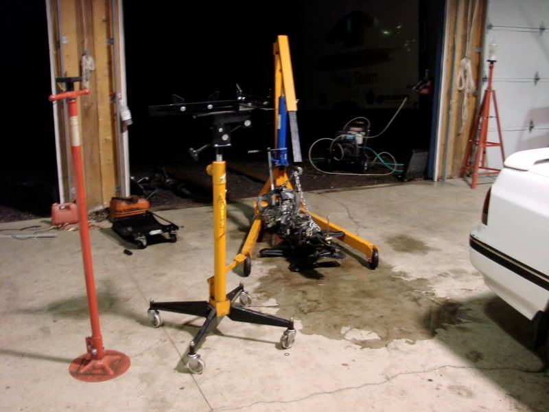

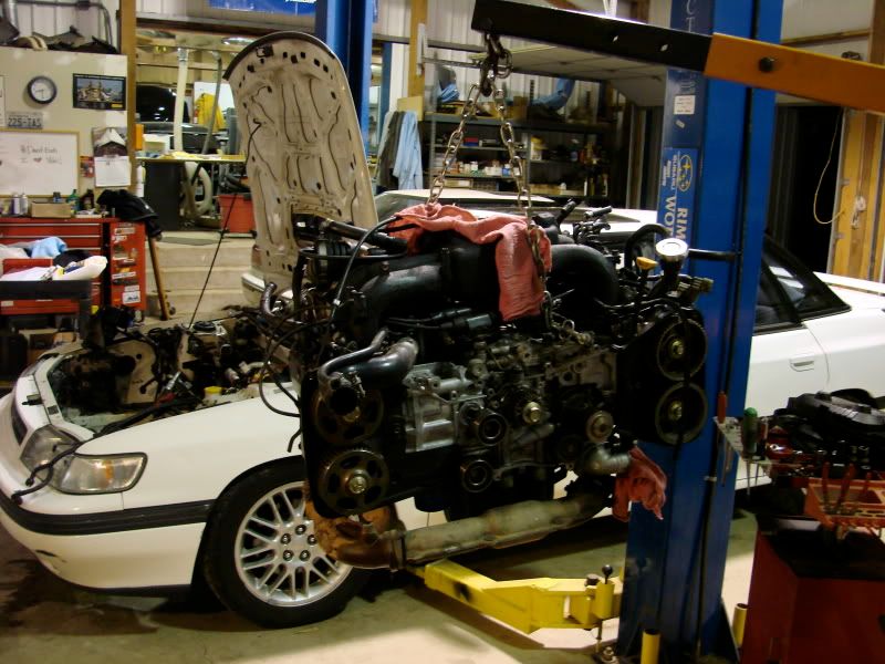

Got the car into our shop and then started stripping my car!

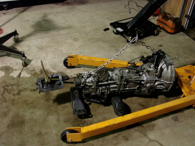

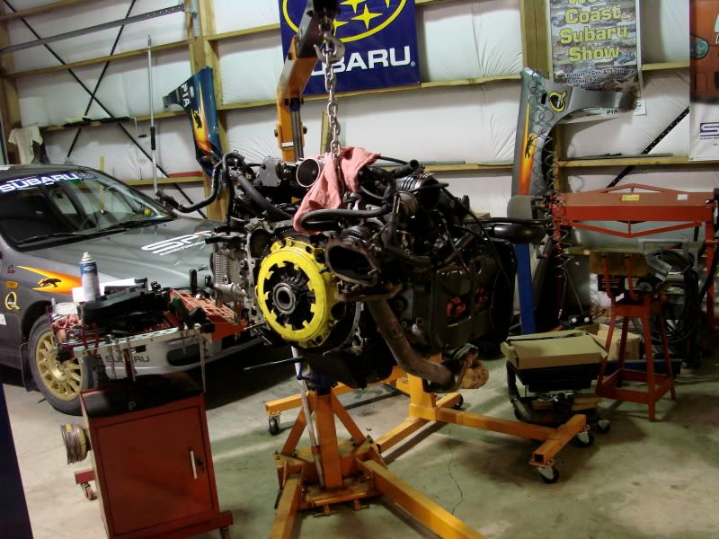

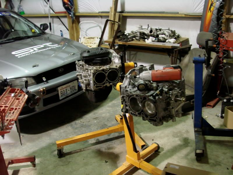

Got the tranny and engine out... Discovered a problem on my motor... back timing cover bolt worked its way out and damn near broke the timing belt! Yikes! I'll post some pics of that later!
Oh and got a bunch of suspension stuff out to.
I'll get some more pics tomorrow of everything else... Camera died tonight.

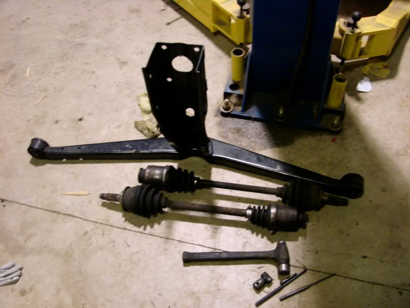

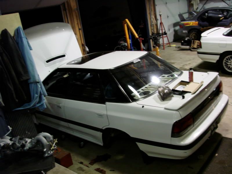

Lazy... dont feel like putting up the pics.. I'm tired....

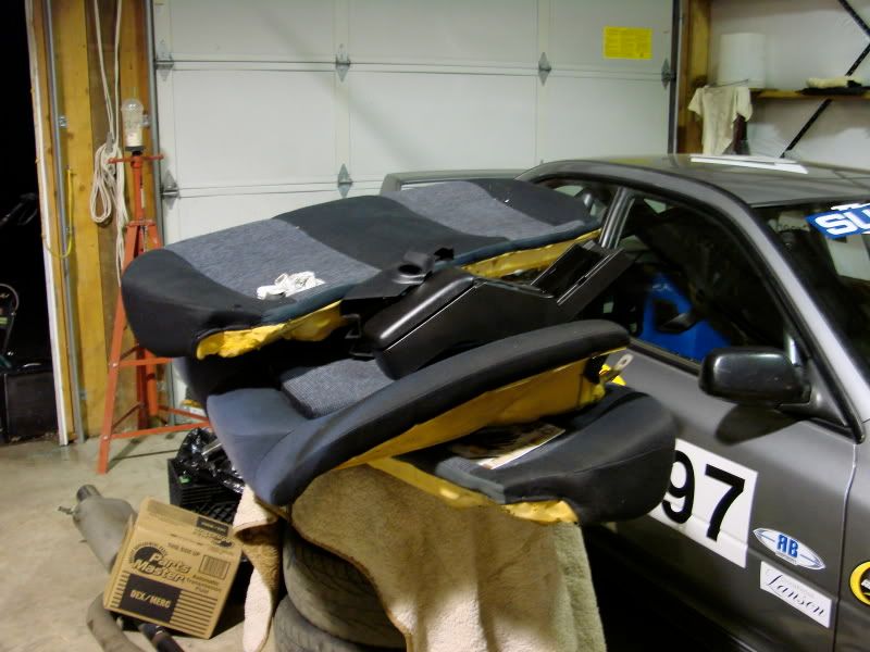

Pulled Interior, Suspension, Front and Rear subframes... cleaned everything... moved cars around, put on rear subframe and suspension on new car.

ok who in the fuck parts out a car like that. :evil:
props for saving it!!!

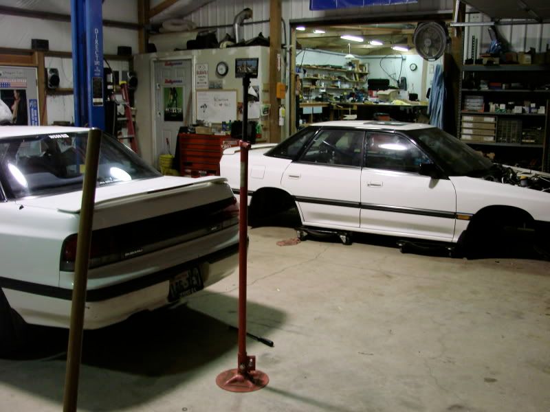

Yeah, I can't even pull my car all the way into my garage! Look at you wheeling it around on carts! It's probably warm in there too. I bet you've got a compressor too. Must be nice.
Posts: 3335
Post by 555BCTurbo »
That sure looks a lot like Steve Greer's shop...

Haha... omg Zach... teh pics make it look better... I was telling you truth! lol
And how observant of you Nick... Indeed it is Steve Greers shop :D
And Brandon... Dont hate :lol:
And Kimo... yes... there is a compressor... but we dont turn the heat on until the dead of winter...

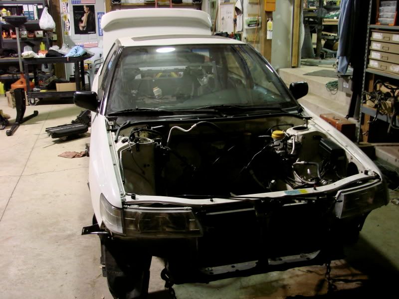

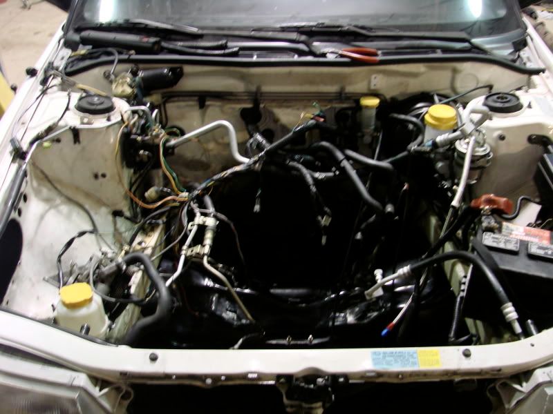

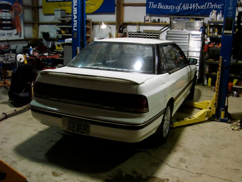

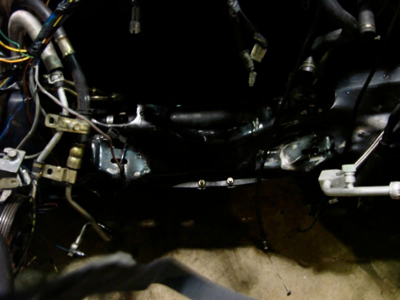

Here are some pics from yesterday....

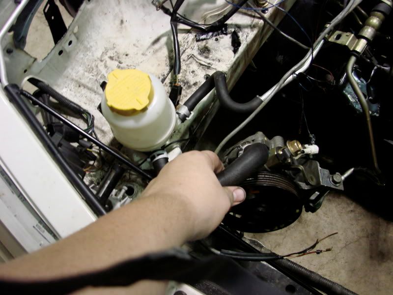

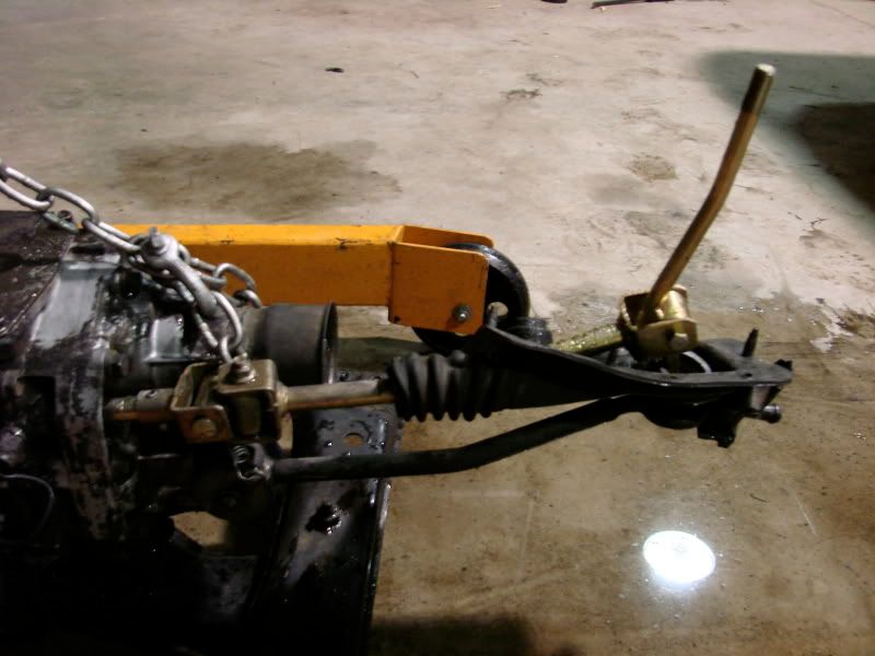

Got the front cross member and suspension in today

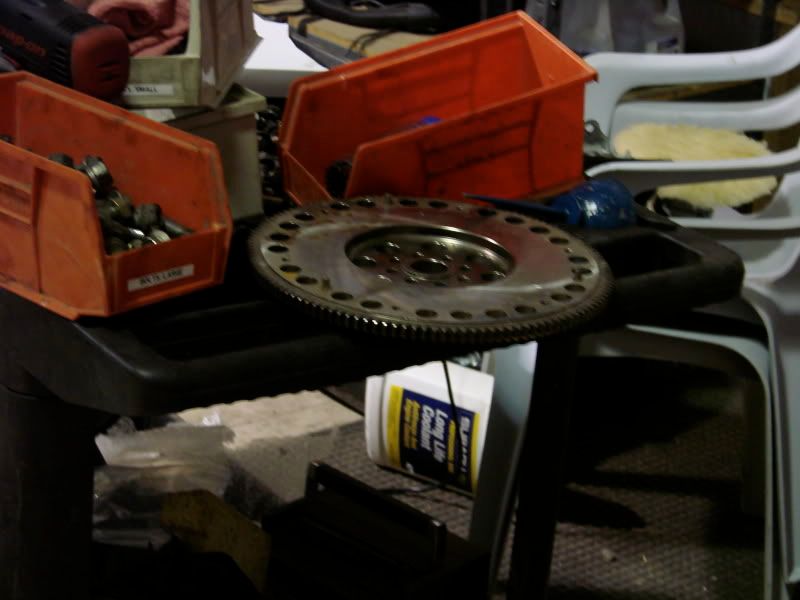

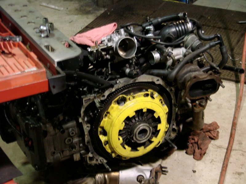

And the Had to do some running around for parts... LW Flywheel... WRX Steering Rack, Shifter Bushings, WRX Shifter Assembly, and a WRX Coolant overflow tank.
She is now standing once more on her own 4 wheels lol
Today will be getting the wiring fixed, engine and tranny in and she should run by the end of the day...
Tomorrow will be Stereo and Interior then we'll be done :)

And the real reason I upgraded the steering rack was because WRX racks are a shorter ratio rack... other wise I would have left old leaky alone lol.

What got done today... Tranny and clutch all setup in the car... driveline... axles...
