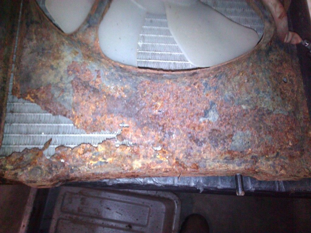

the original....
rusted to shit, nothing I am not used to already ;)
Re: Xise's 1993 Legacy Turbo
Wow that is pretty bad.

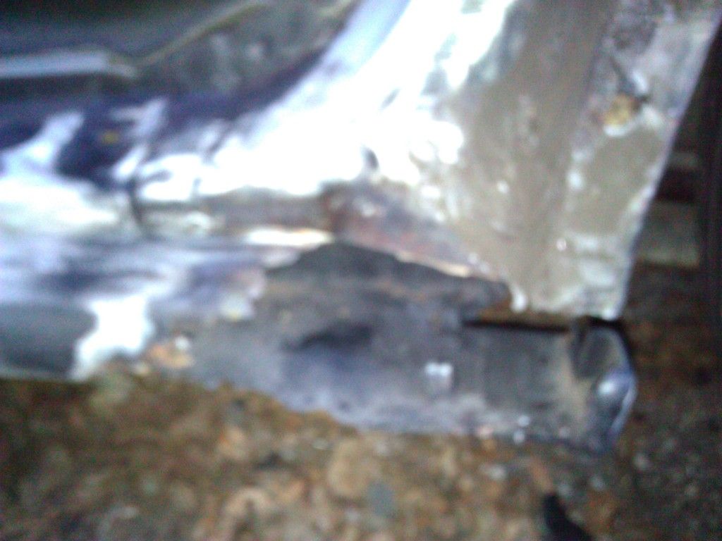

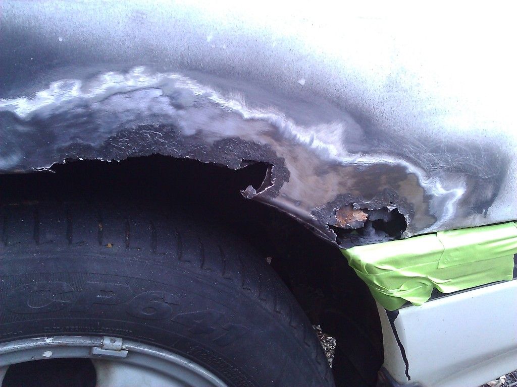

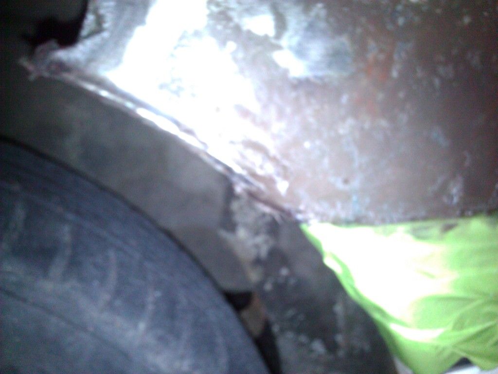

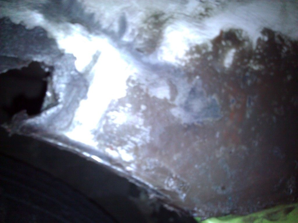

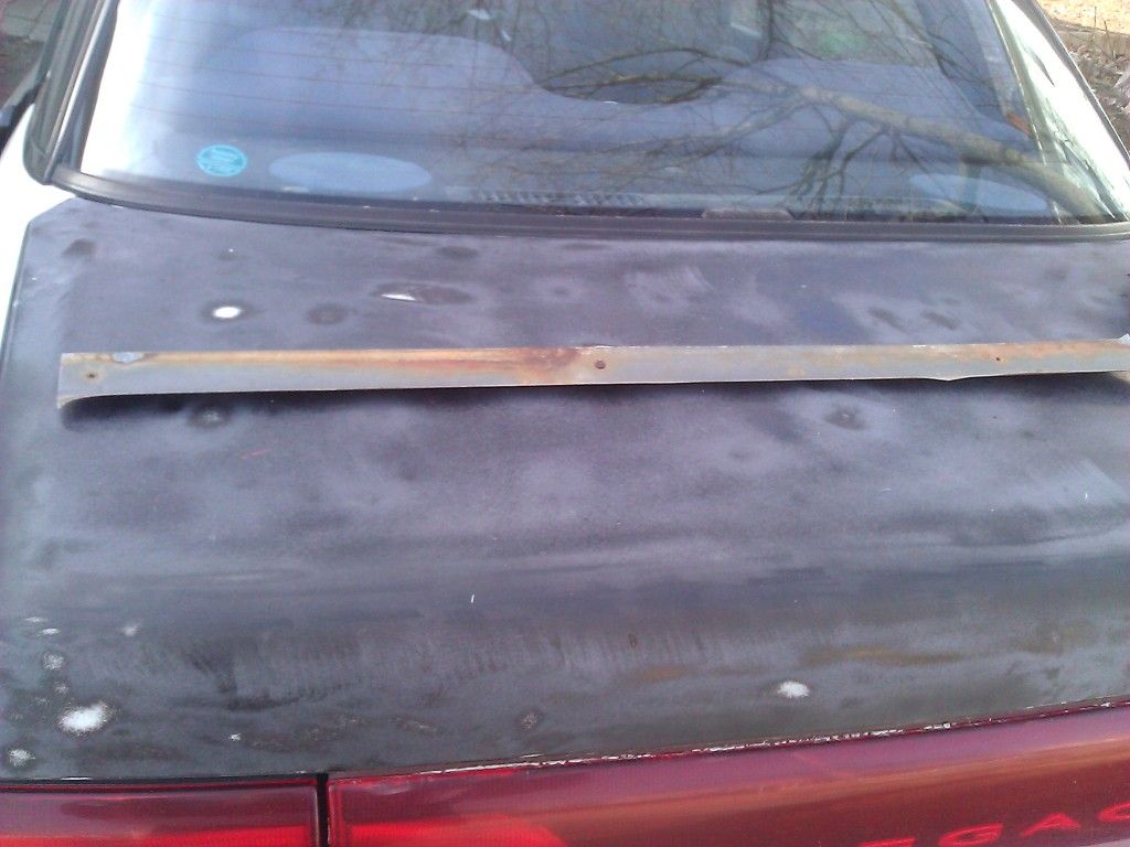

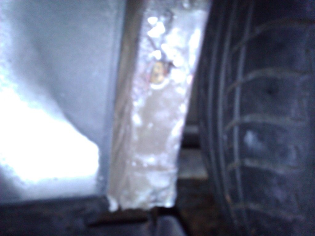

Today was a bust, sure it was nice enough out but my 3 year old was all ADD today. I kept having to stop and come up with activities for her to do in the backyard. Anyway here is what I did get done.
exposed the rust for what it really is
the rocker panel is nearly gone towards the end of it, but the rust stops so it isn't completely gone
it was dark and on a cell phone so excuse the crappy pics, but I only able to patch the one hole near the green tape, it filled it really well, I need to sand it down obviously but I had to quit today b/c I was getting nowhere today....HOPEFULLY next time I have a nice day off it won't be windy and i'll have a sitter lol

wow haha you can't see shit in the "after" picture haha, I assure you it looks better than that.....anyway I was actually anything I can do for this rocker panel, the little plastic end cap is held on by one clip the other is just floating. I was thinking either be ghetto and rivet in some metal Rocker panels of my own creation or, if I could find just the dog leg or a wheel arch and stick that on there....anyone know of a place to get repair panels?

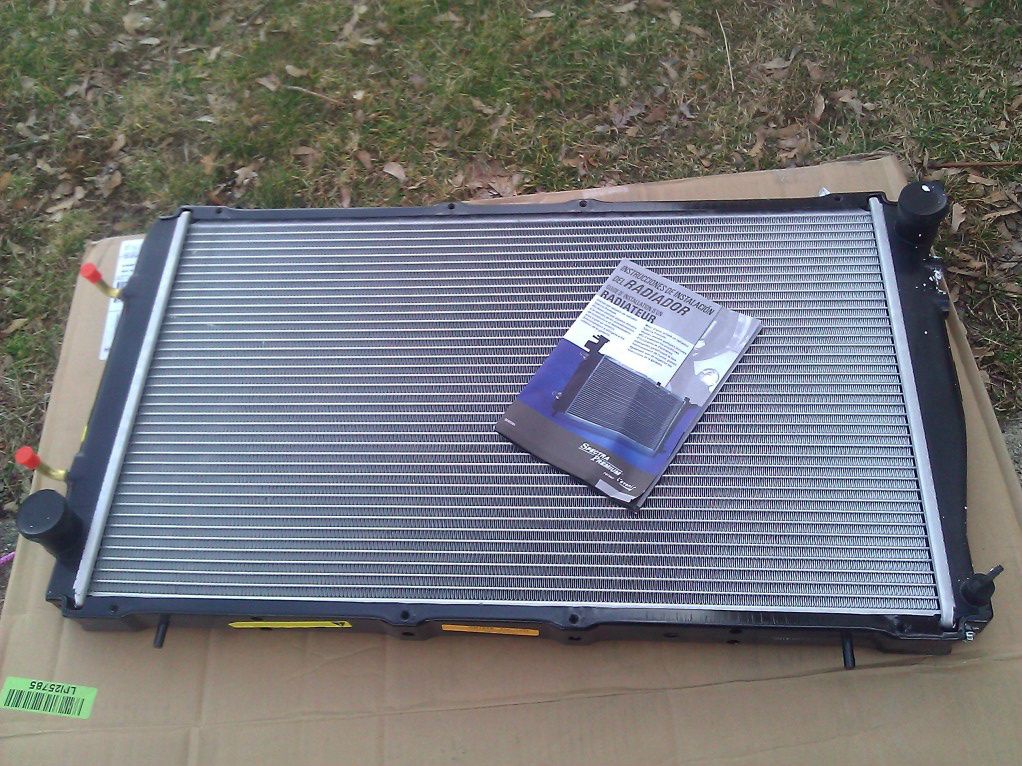

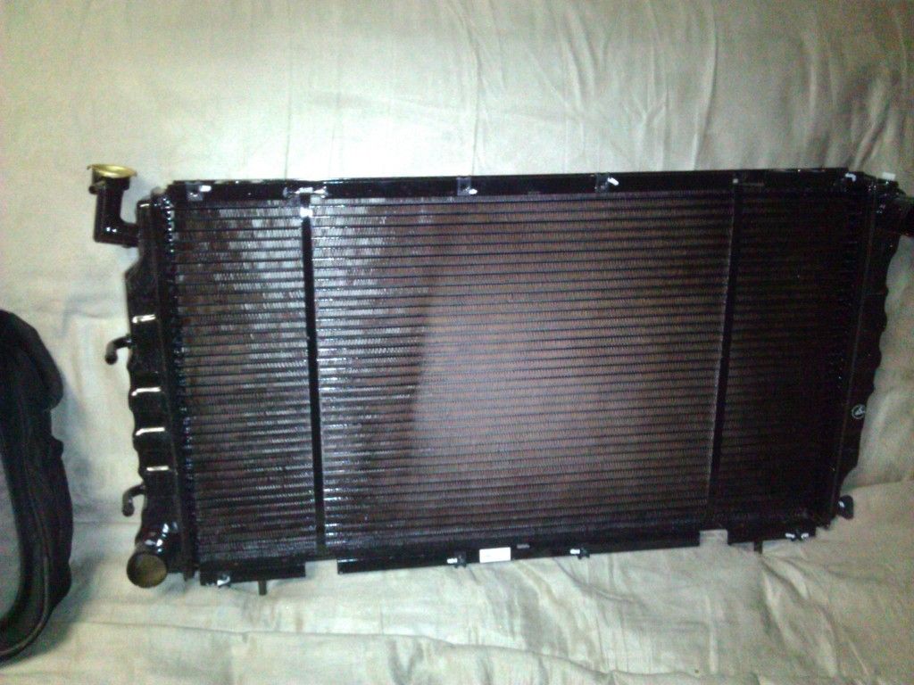

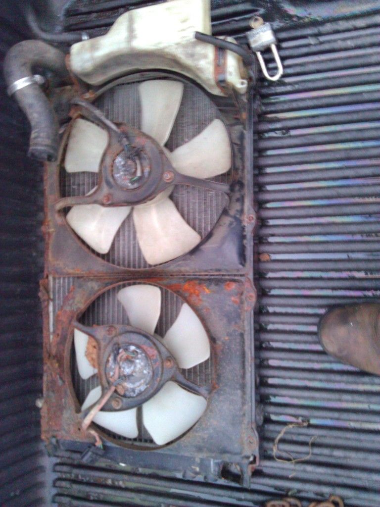

Ok well I was getting ready to cut up this piece of flash to make a wheel arch when fedex came with my radiator
holy shit it is the correct radiator!!
all buttoned up

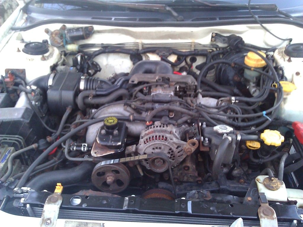

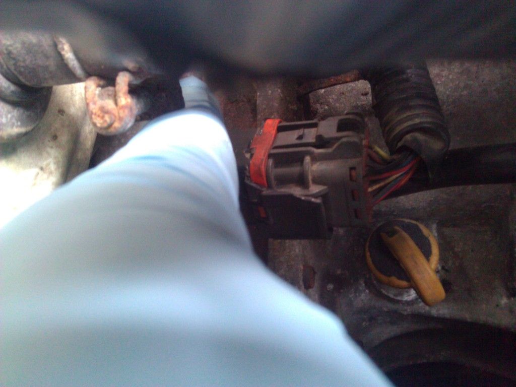

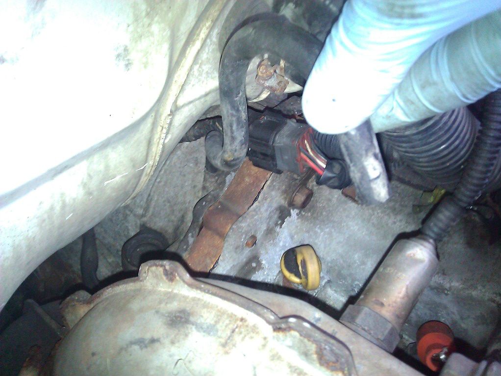

So I installed that and put all the hoses on and put some water in the resovoir and tried to start it...nothin won't even turn over. So I check all the regular things..I notice the ground on the pitch mount to the firewall was broken, so I made a new one and put it back, still won't start but now the light for the gear select is on the dash showing that it was in park.
Everything looks correct and I haven't touched anything really hooked up to anything that would stop it from starting....it is acting like when you try to start It from drive or reverse.
anyone know where it goes?? This hose is in the top of the trans and goes nowhere....is this a vent or should this be connected somewhere? I can't imagine this would cause any problems with starting
it is right near the downpipe and that connector for the trans
for now I will get back to the body work until I think or something...

Ok n/m I guess the auto trans has 2 vent hoses at the top of the case...so today after work I am going to fill the radiator up and hopefully be able to drive it somewhere where I can get it on jack stands and finish bodywork and paint

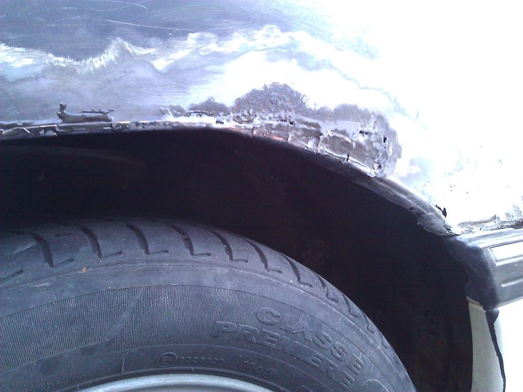

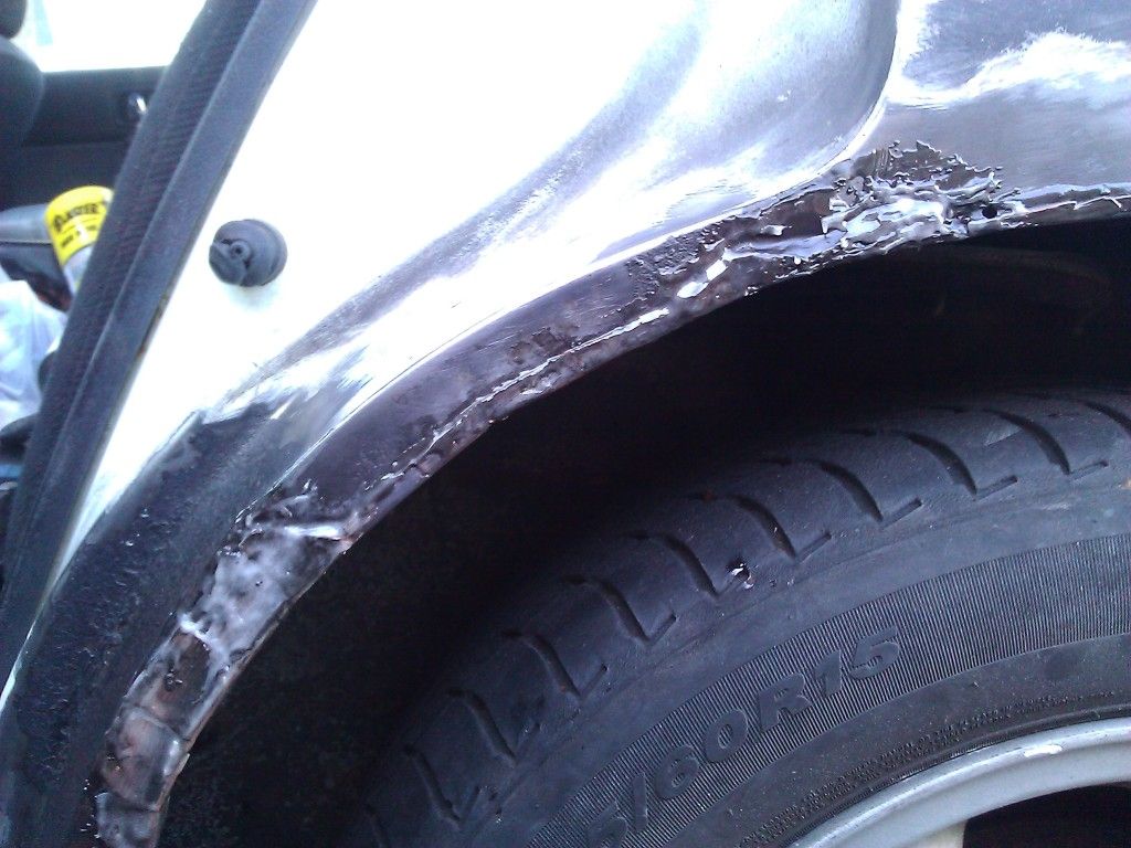

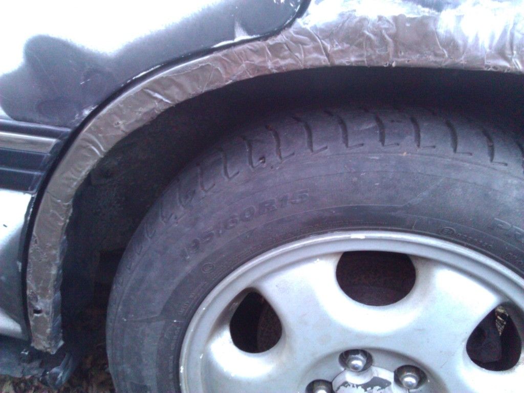

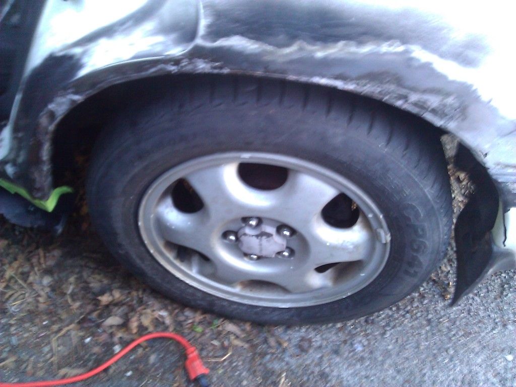

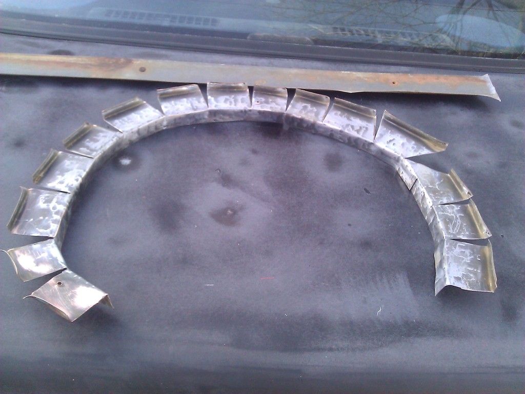

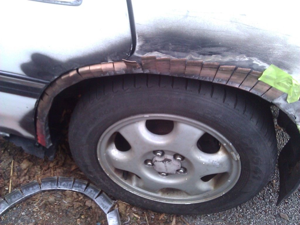

Time for some wheel wells! I got one of these
and cut it into the shape of the wheel arch
it it was pretty easy to shape to the original size of the wheel arch
I didn't take any pics after this b/c I was movin along and didn't want to stop, plus it was getting dark. Basically I cut them to "height" in accordance to where the metal was missing and then jb welded it in place. Not time for any body filler today but the driver's side is nearly done

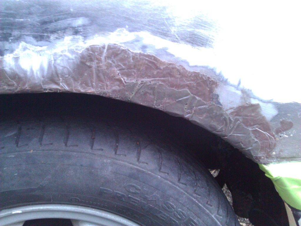

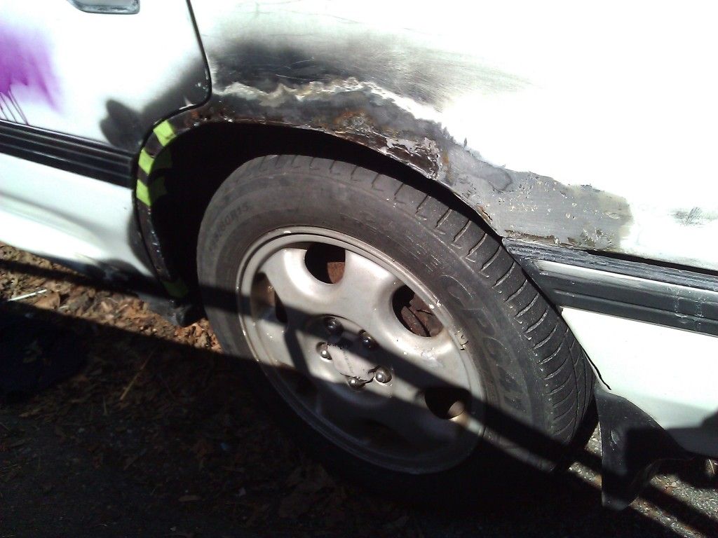

Got some more done, slow goes it as I am only getting a few hours every so often to work on this...
the metal all in place here, all epoxied into place
sure ain't pretty......yet
some fiberglassness goin on here...
still not sure what way to go at this rocker panel...probably some metal and fiberglass cloth....i'll figure it out though :D

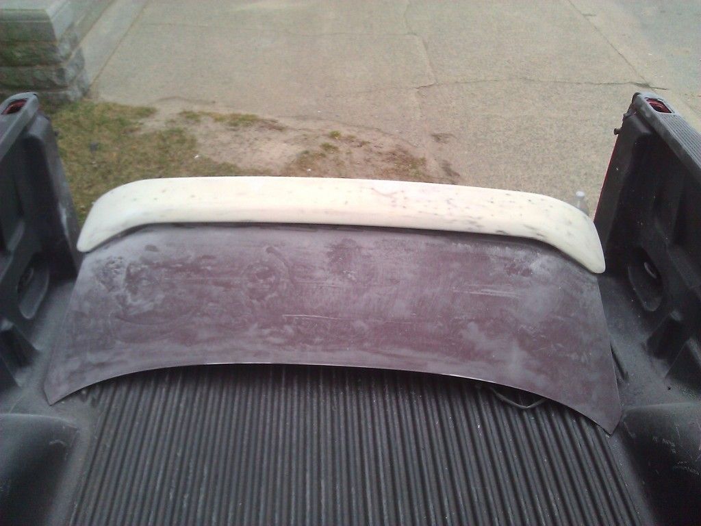

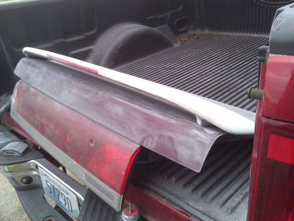

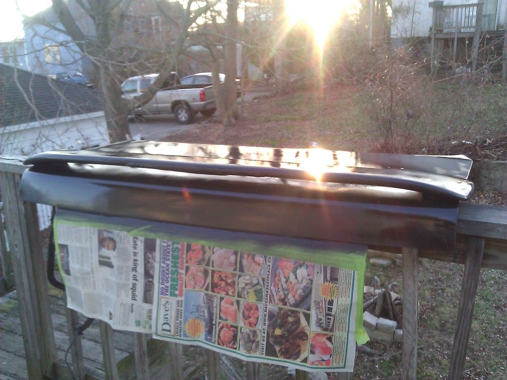

man it pisses me off not being able to just finish this and paint, I did get to paint the trunk though, at least one coat of bas after sanding and primer...but to give you an idea of what little free time I have, in order to just get this trunk to have a coat of paint I had to prep it at work, sand it all down and wash it at a carwash self service place...drive home and do the rest. Even that I was only able to do b/c I had it on my porch so I could just step outside, spray/sand it and go back inside...major PITA not being able to sink some time into this. But anyways....some pics
got to work...while at work...lol

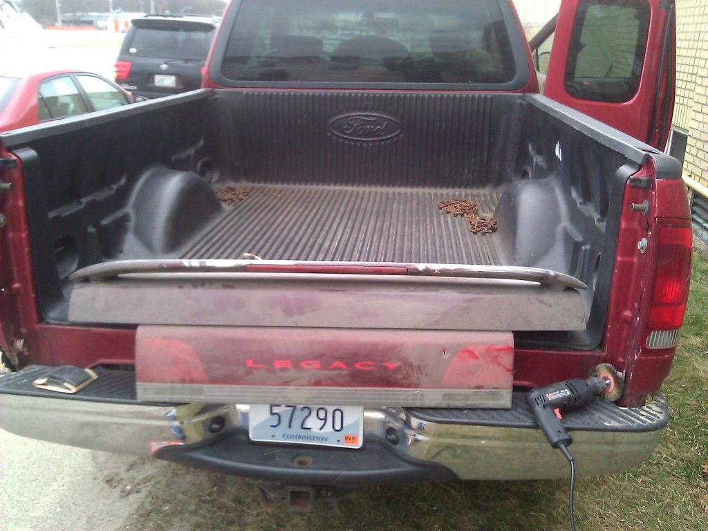

sanded down all nice nice, right down to the plastic on the spoiler
guess I forgot to snag a picture of it with just primer and after I painted it with a coat...but here are some brakelines lol
purple per request of the wife

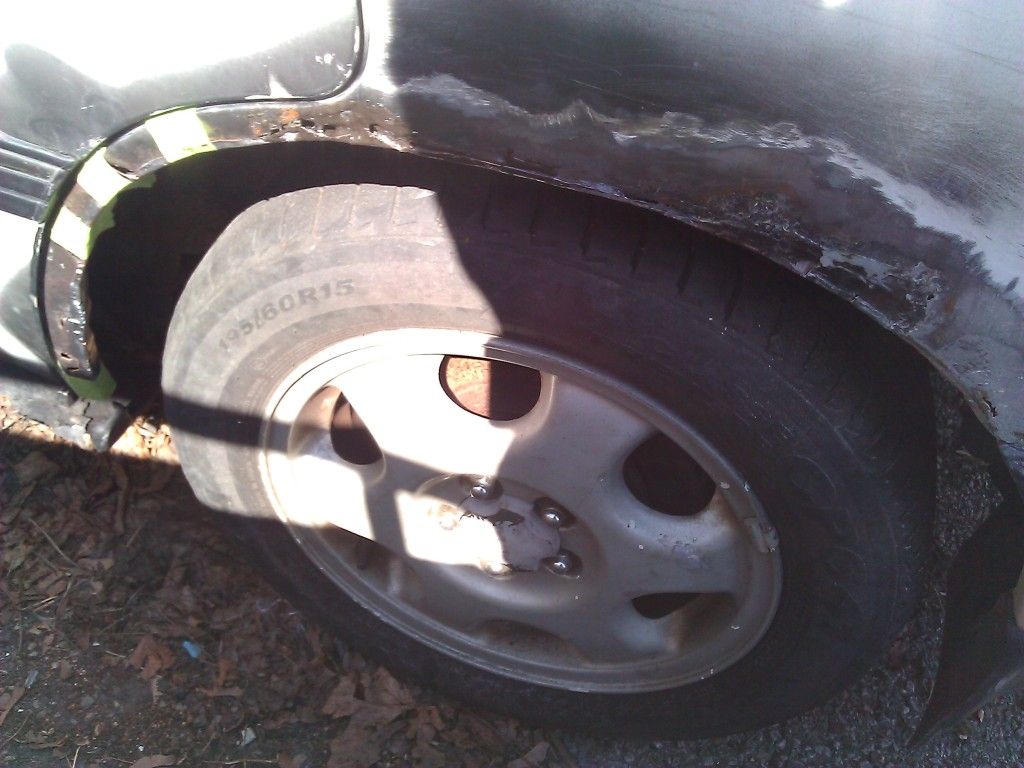

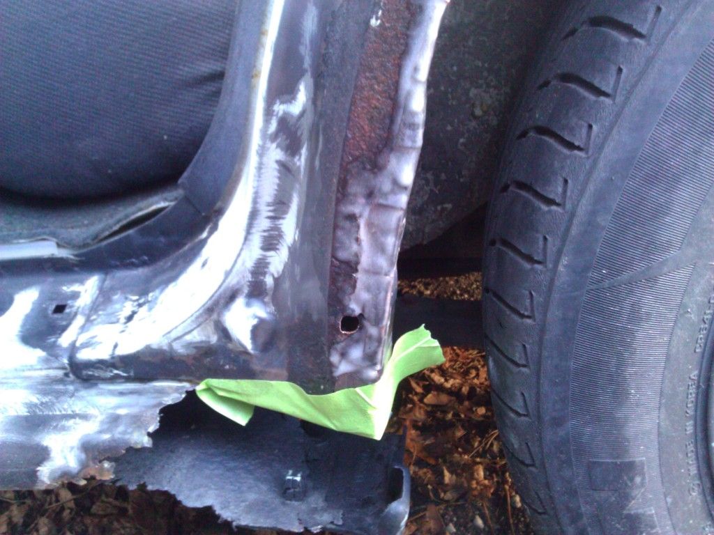

rust is all patched up now, filed it down some today, hopefully I will be doing the body filler soon, then paint...gotta move it first though, otherwise i'll paint it and birds will shit all over it...so first thing is first..I need to get it started :D

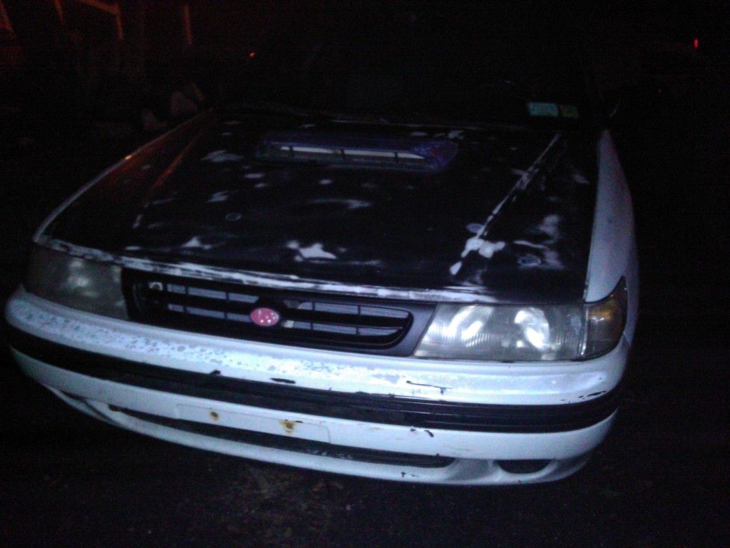

Got to paint the trunk some more today, also pulled the grille off and painted that, might end up doing the same with the fenders as well. I also took the liberty of scraping the paint off the badge to make my own custom pink badge seeing how I couldn't find an aftermarket legacy badge.
need some chrome paint and some pink paint
trunk has about 2 coats right here

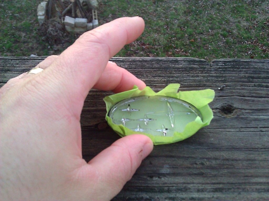

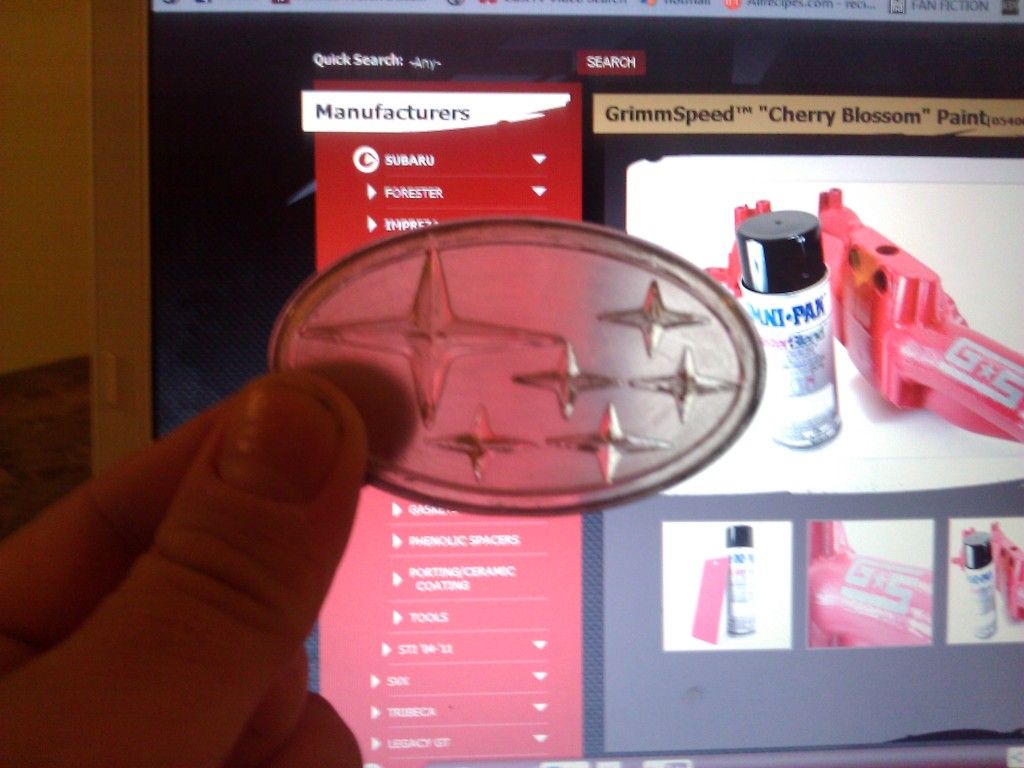

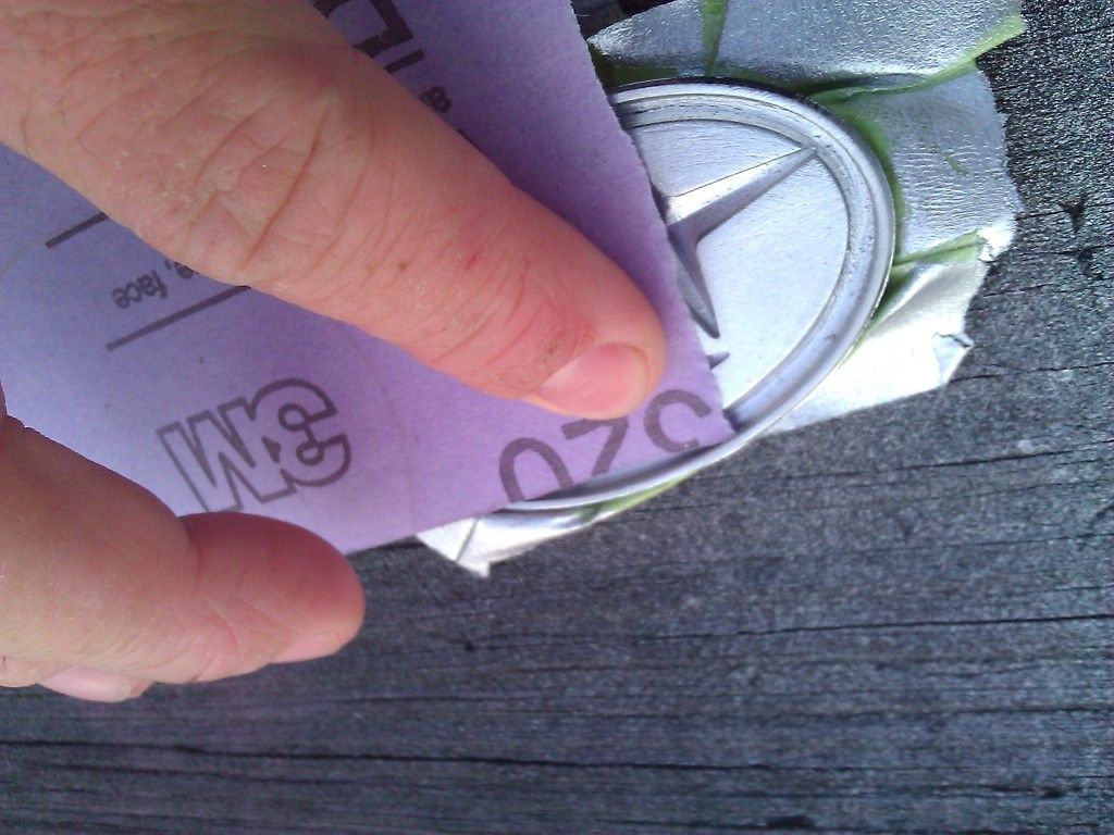

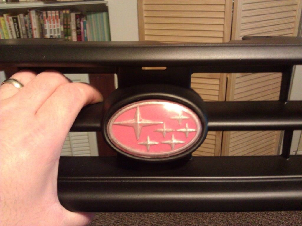

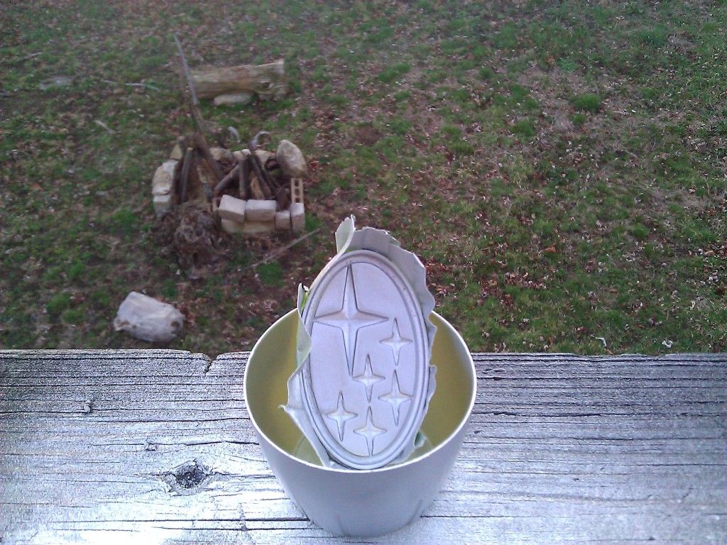

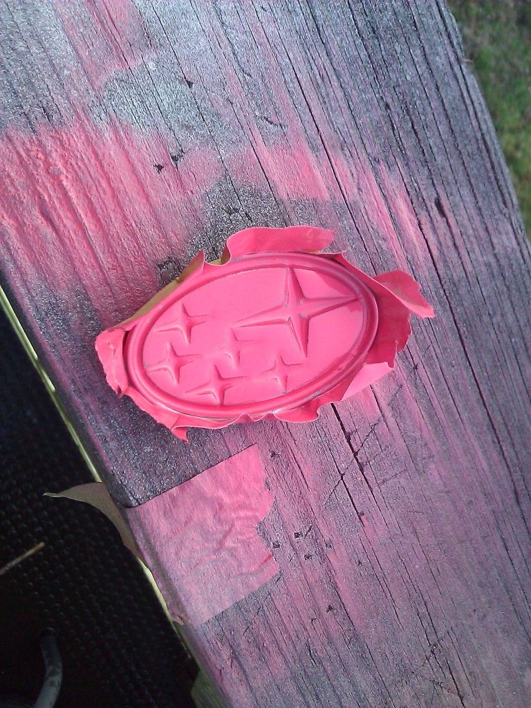

Today I decided it was time to get this emblem done, I just wanted to see how it was going to look in the grille really and couldn't do much else b/c it had rained today
got it all taped up and sanded down.
went to walmart to get some paint and saw this
back to the house with the paint
then I got busy with some metalic silver (no chrome paint @ walyworld)
then I sanded the paint off the face of the emblem
the correct color pink being applied here....took forever to finally dry
here is the end product...not too shabby
all in all it didn't really take that long, would have taken less if I never scarped the chrome off the emblem in the first place, but oh well it still came out very nice :D

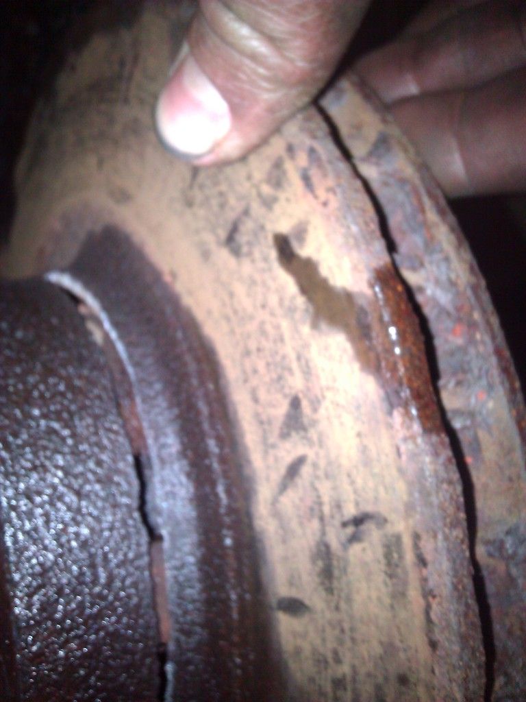

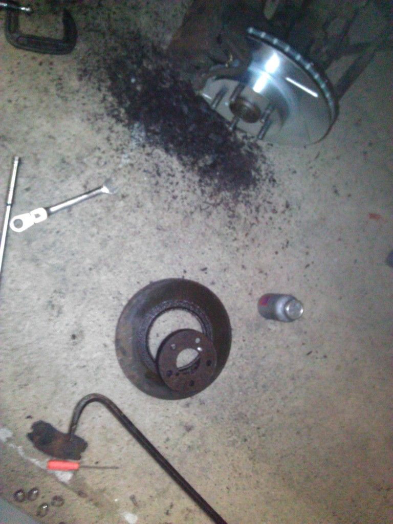

finally found a small amount of time to get my brakes done, had to hold off on doing the lines and painting the calipers though. I was very short on time and need this thing roadworthy by the end of the week or I have to pay for the F150 for another month worth of insurance.
everything went very smoothly until I got to the last rotor, this thing was stuck worse than any rotor I have EVER done. so bad I broke bolts off in the 2 holes used to remove it, and hitting it with a sledge only served to break the rotor, with the barrel STILL STUCK to the hub!!!
a little more violence and they came off
now a custom 2 piece rotor lol
new rotors in place
the calipers were all pretty tight compressing them, borderline seized....so I am going to get new calipers all around, how are the factory calipers anyway? Is it worth an upgrade? will 4pot/2pots fit these rotors?? All in all all new setup will only cost $154 not too bad after I send the cores back.
At least if I get some new rotors the paint will take to them really nicely, I already bought the rotors so if no calipers will fit on these rotors I am sticking with the SS brakes. I am planning on putting some lettering on the legacy calipers if it looks nice. Maybe something along the lines of:

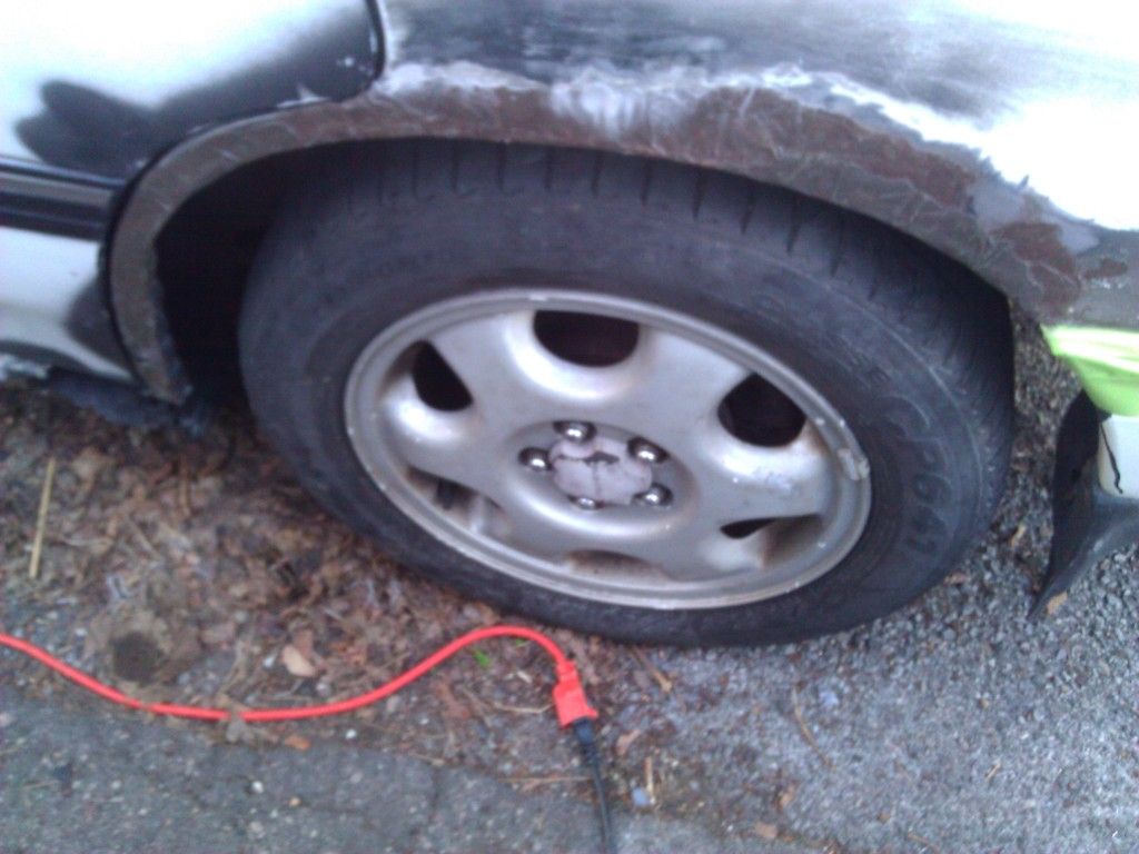

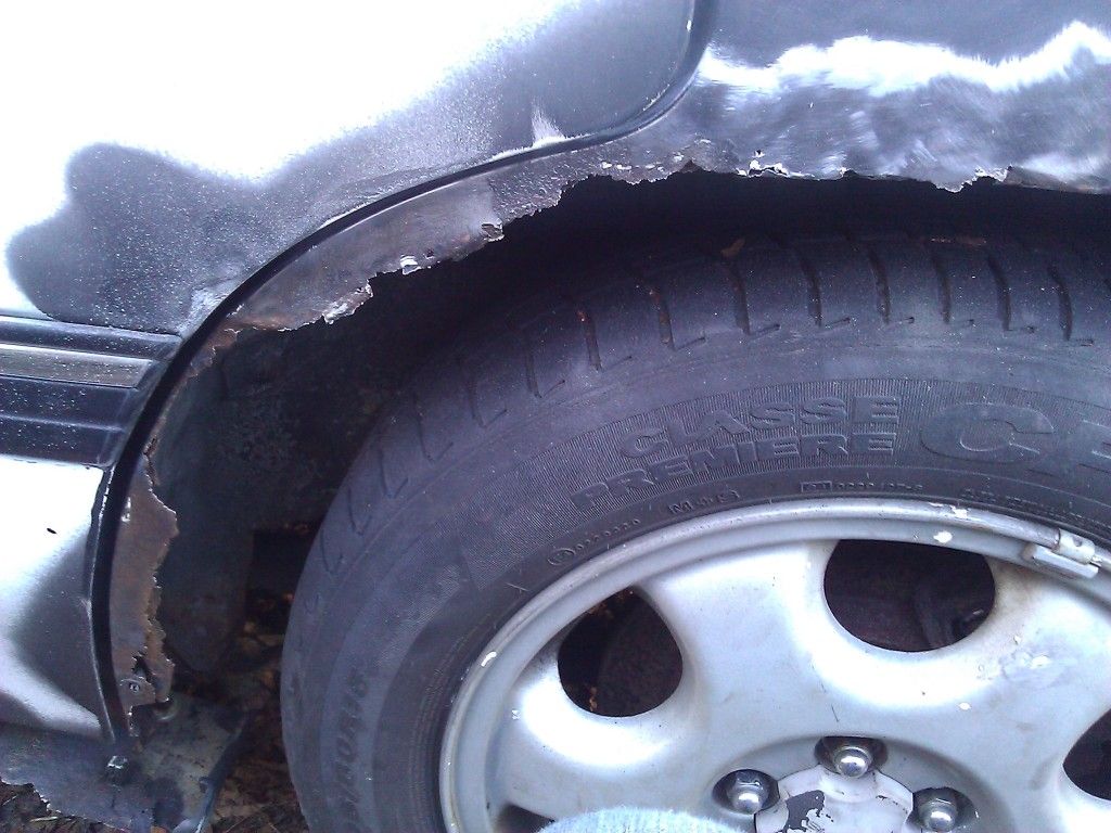

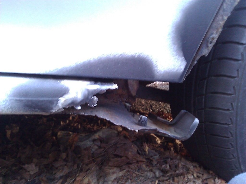

Anyways got a bit more sanding down done, I sanded the surface on the wheel arch even with the rear door, ready for some bondo now...my daughter helped me out a bit too lol
I still need to do the other side and a few fiberglass patches are needed underneath, the rocker panels are pretty toasted....this is probably going to end up being a shell until I can grab an unrusty legacy somewhere and swap over the goods.
