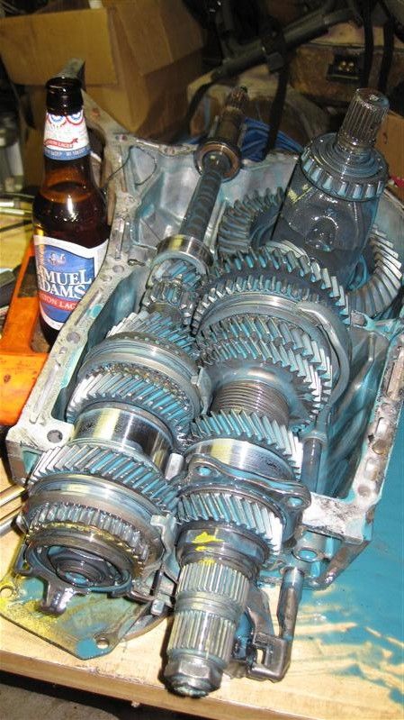

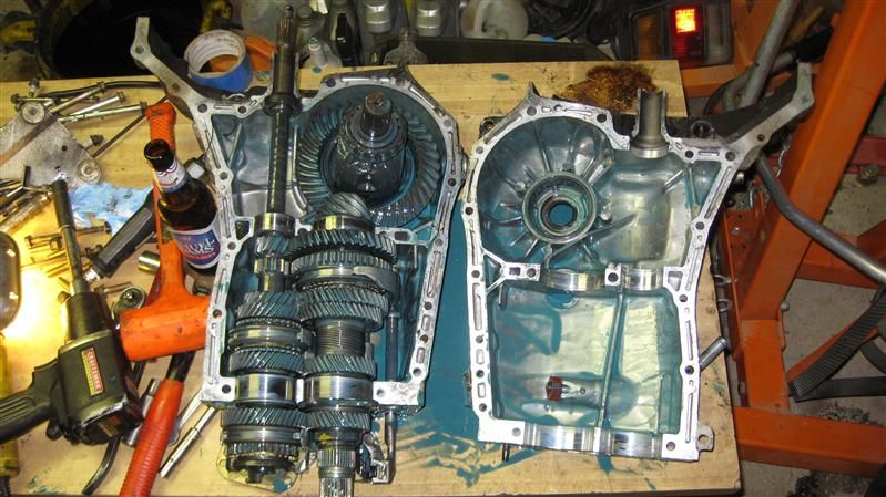

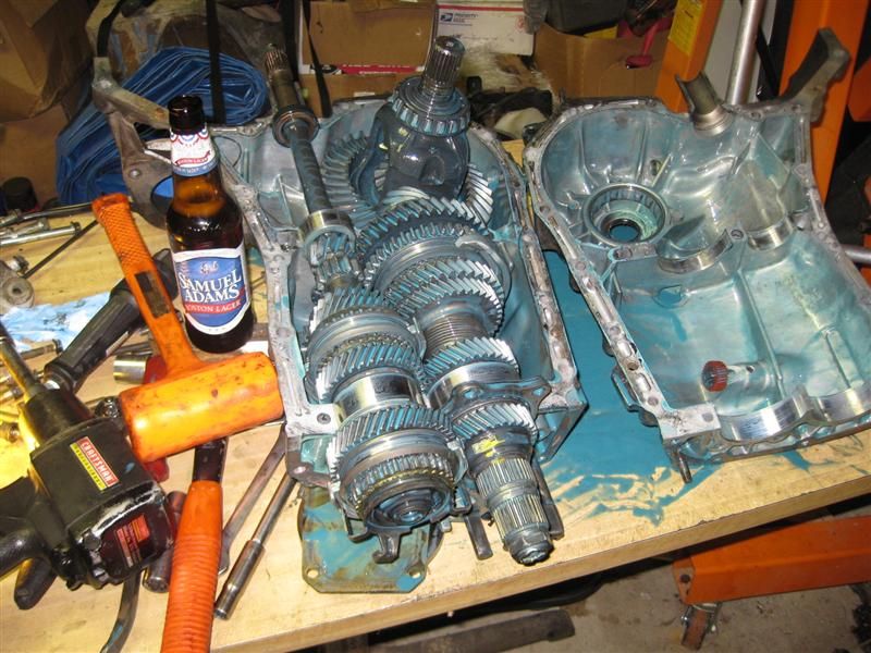

Finally got to work on my car. First time in a long time. Didn't get a lot done but it was interesting. Took the trans apart. Hoping to get it back together properly with a new trans case as soon as Jeff ships me his. Worried a bit because the FSM says 17 bolts to split the case and I only counted 16 so there might be a difference between the SS case and the JDM forester case....hopefully not, that would suck.
Wow, cool pictures. Looks hella messy.
Indeed it is a big mess. Half the parts I wanted to replace are not in the system so that is pissing me off now. I guess I'll be keeping these synchros and bearings after all. Stupid.

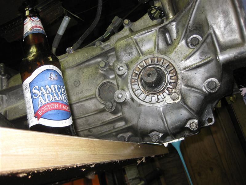

That Sam Adams is getting a good work out holding that trans case up

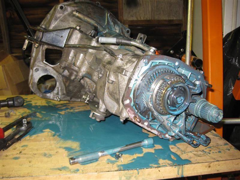

Yeah I spilled half a beer accidently while wrestling with the transfer case trying to remove it. Is there a trick to getting the shift selector thing lined up so it will come free? I ended up pounding it into the transfer case to allow me to pull the transfer case off the trans far enough that I was able to wiggle it free but it was a pain and I felt like there was probably a better/easier way of doing it.
Also, anybody know how I can get the gaskets for the case? It's no longer in the parts system. And I can't find the input shaft bearing in the parts system either.

Is that blue stuff Motul?
No but there is a quart of motul 300 in there. The blue is from redline lightweight shockproof. Didn't help the synchros at all. Waste of about $90.
