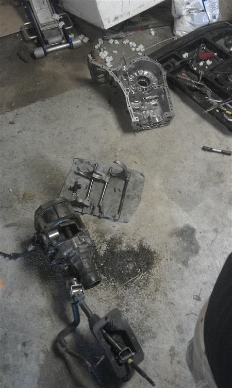

Yeah screw that noise. Its not that hard except removal and install of the trans and its pointless because there's not a speedo gear that going to fix it.cj91legss wrote:Hmmmm......... Well i guess we could just crack it open again. But thats a shitty process as you know.
Thanks stephen. The flywheel isn't really heavier than stock I don't think. Its just a tiny bit larger in diameter and the clutch should be stronger.

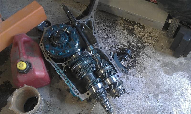

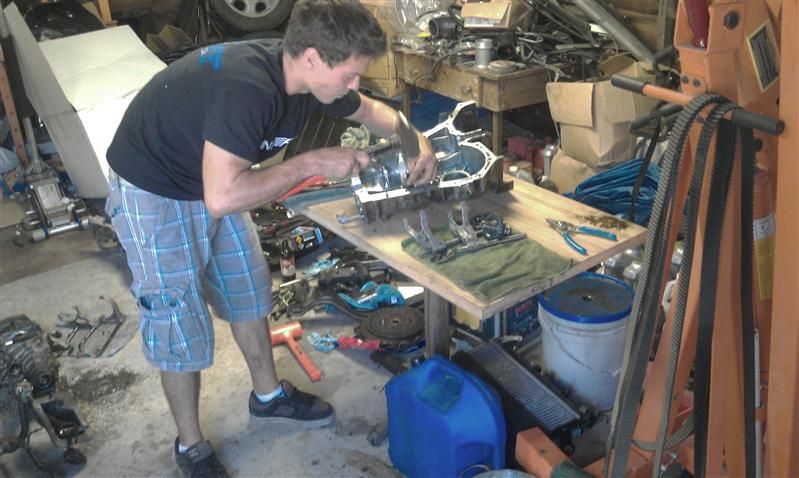

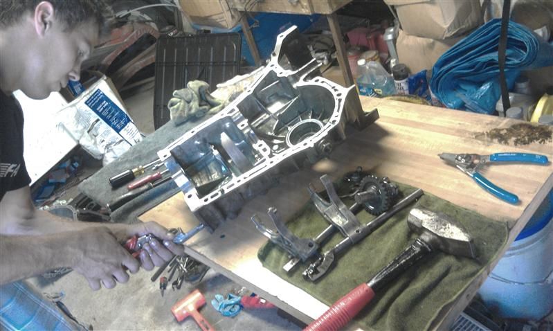

Working on the trans before we got it back on the road. Don't know if I mentioned it already or not but CJ came down to my place weds and helped me swap my internals into the new tranny case and Patrick also came down and helped and my friend max. I worked on that car from 10:30am-12:30am with an hour break to pick up parts and eat lunch. 13 hours basically non-stop! Fired up first try though!

Kimo was being pretty meticulous about cleaning his trans case. Very good thing to do...

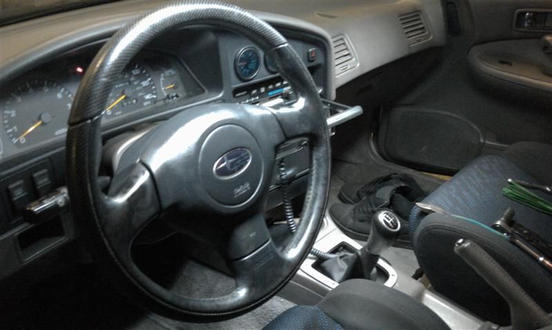

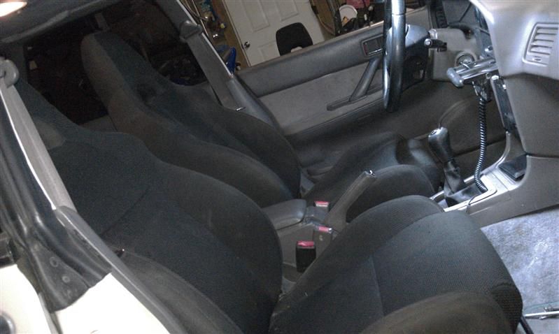

What's this?? Unexpected mods! Yay. These 05 WRX seats sit much higher than my 02/03 seats
. Wondering if maybe I can swap the seat rails or something or at least chop and weld the existing rails. They're also heated with airbags so they are heavy as can be. Don't know if it's possible to remove the heating part or if I should just try to wire them up. The seats and steering wheel came out of a rolled 05 WRX my friend parted out. The driver's side seat was bent pretty bad but we managed to bend it back almost all the way and we're gonna reef on it some more. The back needs to be swapped still and they need a good cleaning but they sure look sexy.

The seats and steering wheel look good. The heater elements are not that heavy. Plus I would wire them up to use for your winters. The airbags are probably the heaviest parts.
I don't know. Those the airbag from the steering wheel wasn't that heavy but these seats are much heavier than the 02/03 and the side bolstering isn't nearly as deep so it doesn't keep you planted nearly as well and I miss that already.

Really? I thought they go back pretty far already. Crazy. I'm about 6ft tall too. I really hope I can get these seats lower somehow. I don't like gangster leans and the added height can be felt a lot in the corners. Tye car feels like its rolling more but it may just be me that's rolling more and the smaller side bolsters. Overall its basically a sacrifice for looks and that's usually not my style...
You could try to swap the rails. I think they just unbolt from the bottoms of the seats. I know one bolt on my STI was loose and it was a pain to get to it to tighten it.
I'm going to try swapping them tonight. I'm skeptical however.
