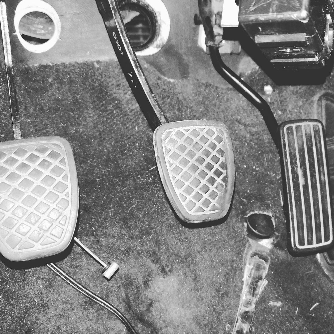

Post by RckyMtnLegacy »
Pulled brake pedal last night. Going to try install tomorrow night. My last has a business trip for The next 4 days so I'm trying to get as much done as possible.

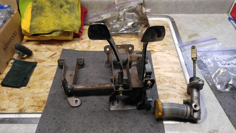

RckyMtnLegacy
Posts: 739
Joined: Sun Aug 06, 2006 6:25 am
Location: Littleton, CO
Re: RckyMtnLegacy's 93 Turbo...EJ20G swap in progress!!

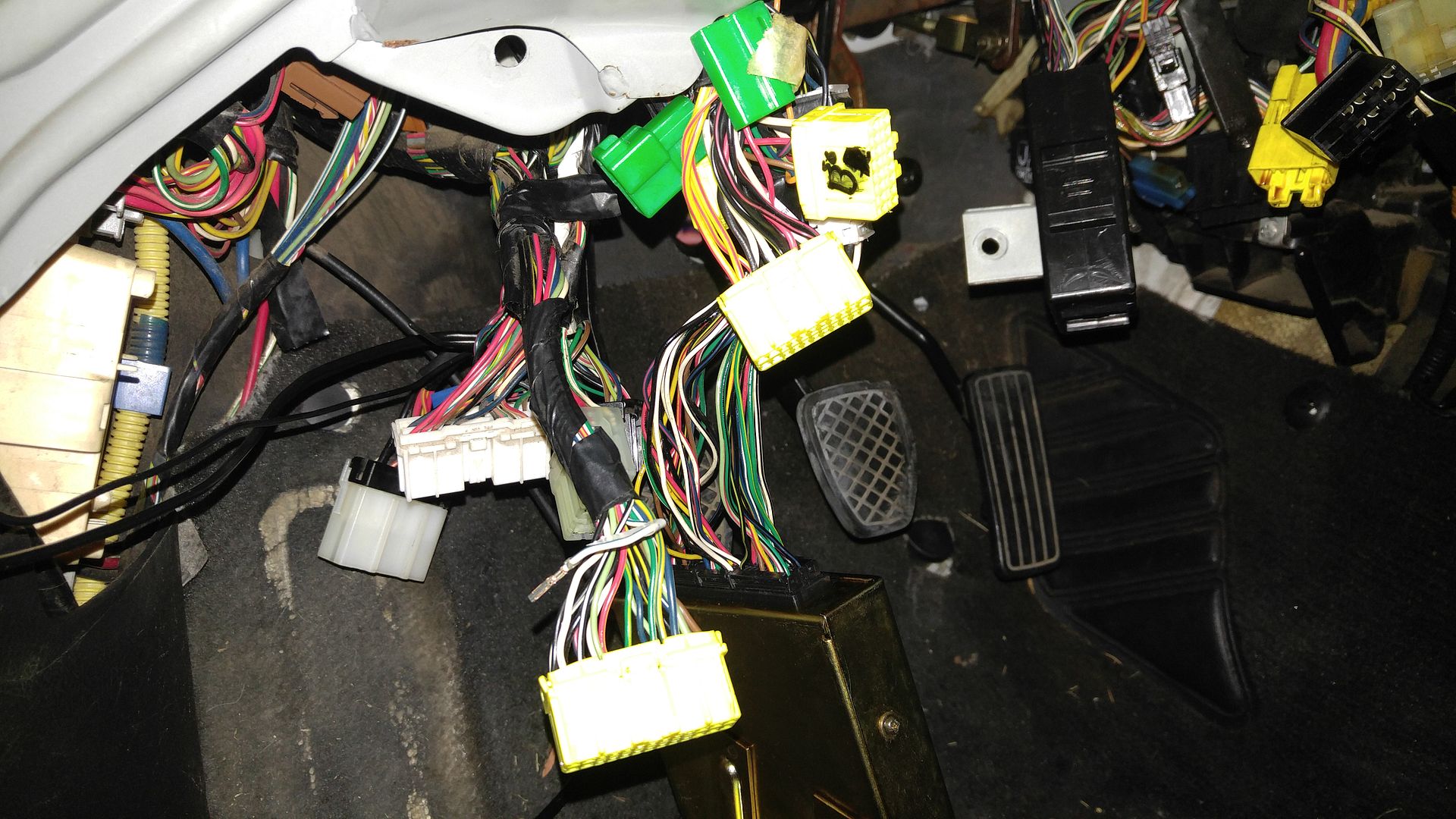

Boom pedals are in
They were a pain but it helped to have the full dash and column out.I loosened the harness on top that is ran under the cluster pulled it up and put a pipe under it to keep it from falling while I pushed up on the pedals to line up the mounting bolts. I did get every bolt to fit though
Had a helper too

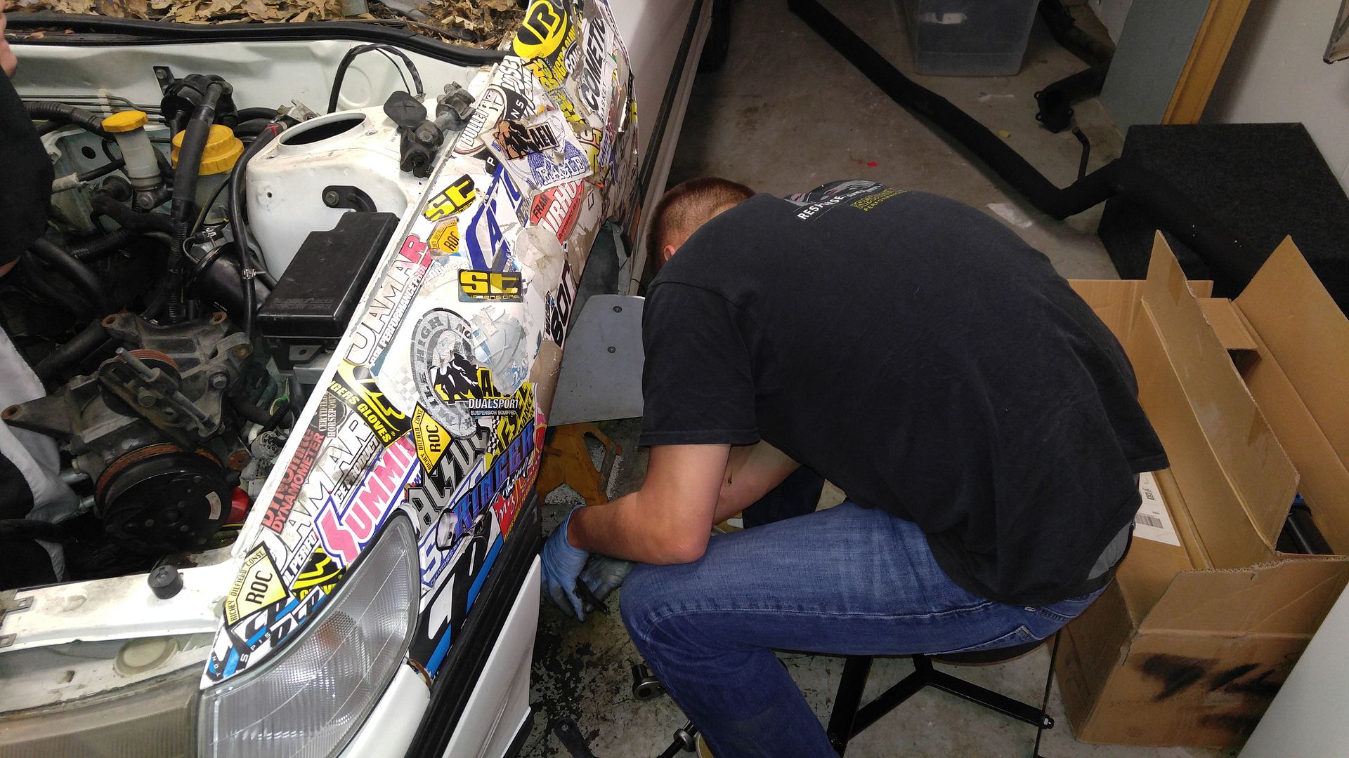

Ya I still firmly believe I could have got her running by then but we decided a couple hours ago that we didn't want have to do anything twice so we are going to do the COP conversion now and clean up the engine bay and paint it black instead of trying to clean it up later just to get it to the show.

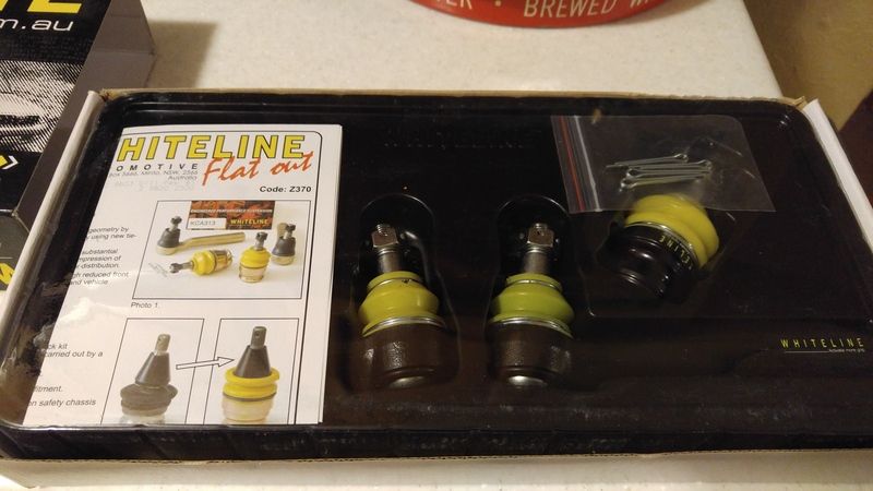

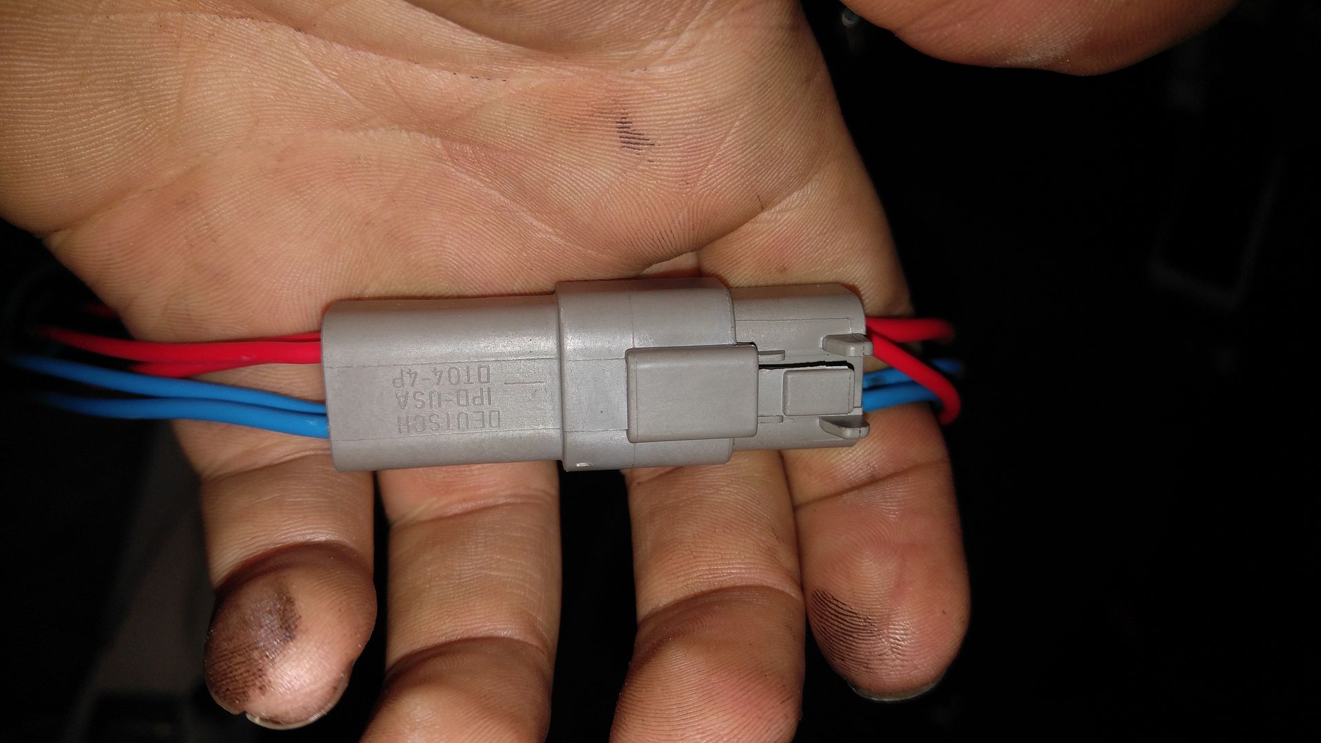

Installed Whiteline Ball joints
Started ECU fun too
Thanks Kimo on the connectors and crumpets highly recommend
Almost ready to get this under the car too. Ordered some Motul too.

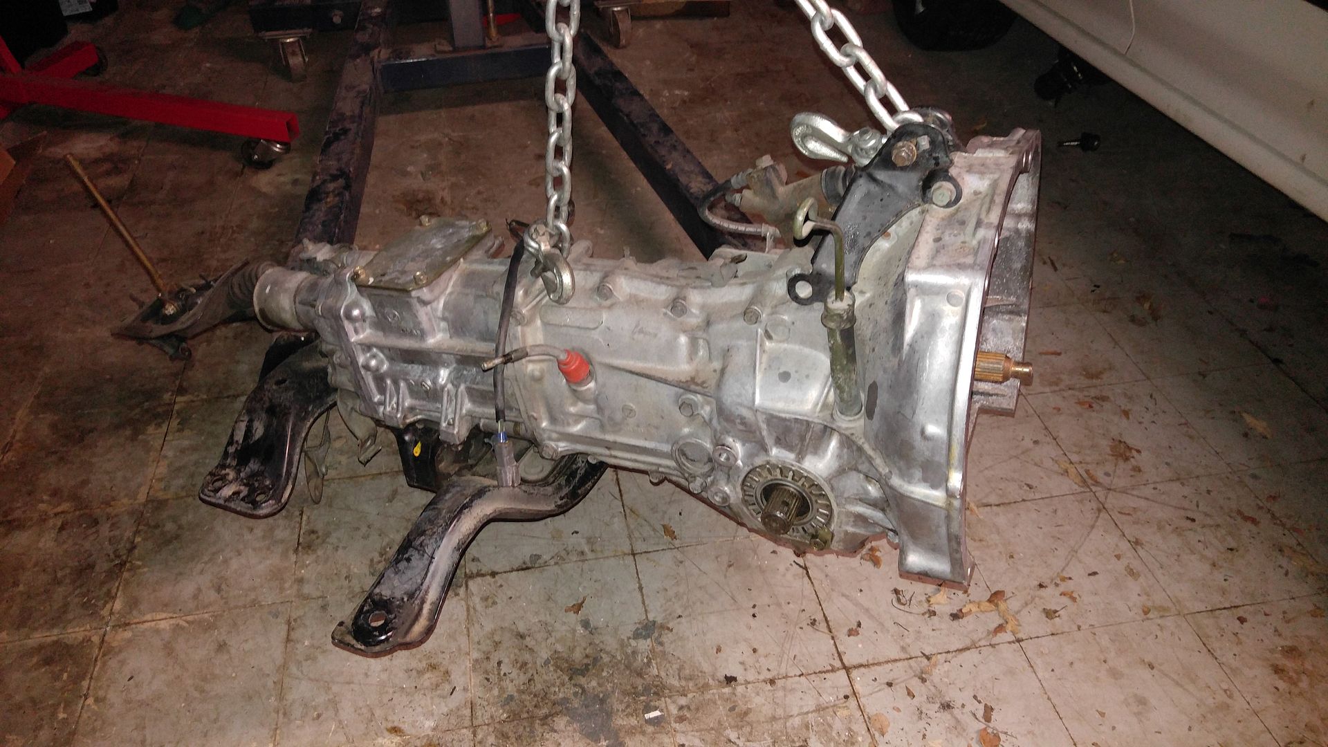

Which tranny is that? I hope you don't need an engine hoist to move it about ;)
RckyMtnLegacy
Posts: 739
Regular 5 speed. I was draining it, plus I was sick of lifting it every time I needed it moved. The 4EAT on the other hand is a beast

Nice! I was considering putting the trans in by itself before I get the motor in, good idea or bad? Also reminds me I need a new crossmember because mine broke.
Parts Needed:
Manual Cluster
Front & Rear bumper Chrome Trim
RckyMtnLegacy
Posts: 739
Floor jack will make it much easier

Cool, so thats not a bad idea? Figured I could get the tranny in and do everything needed for five speed swap before I put the motor in.

Nope not bad that's what I'm doing
Way easier to install engine when tranny is in place.

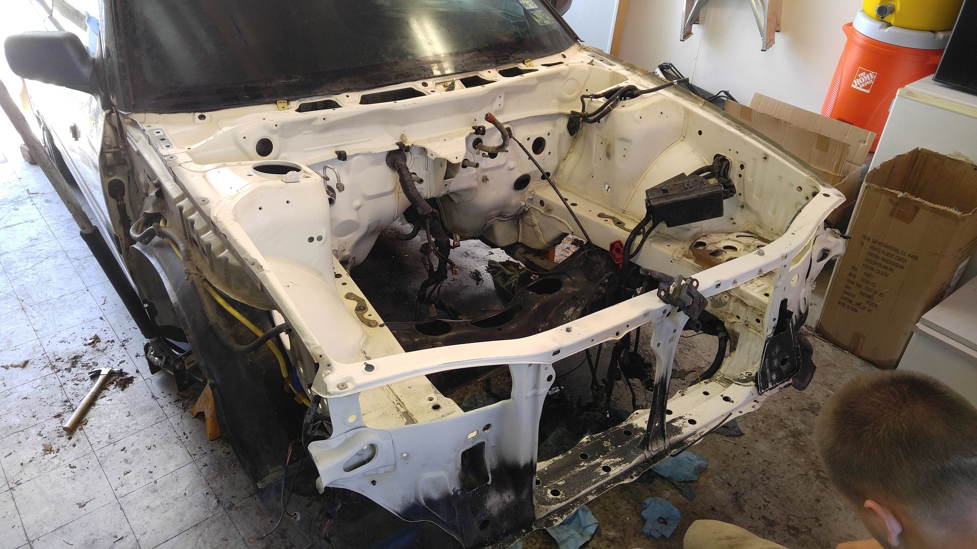

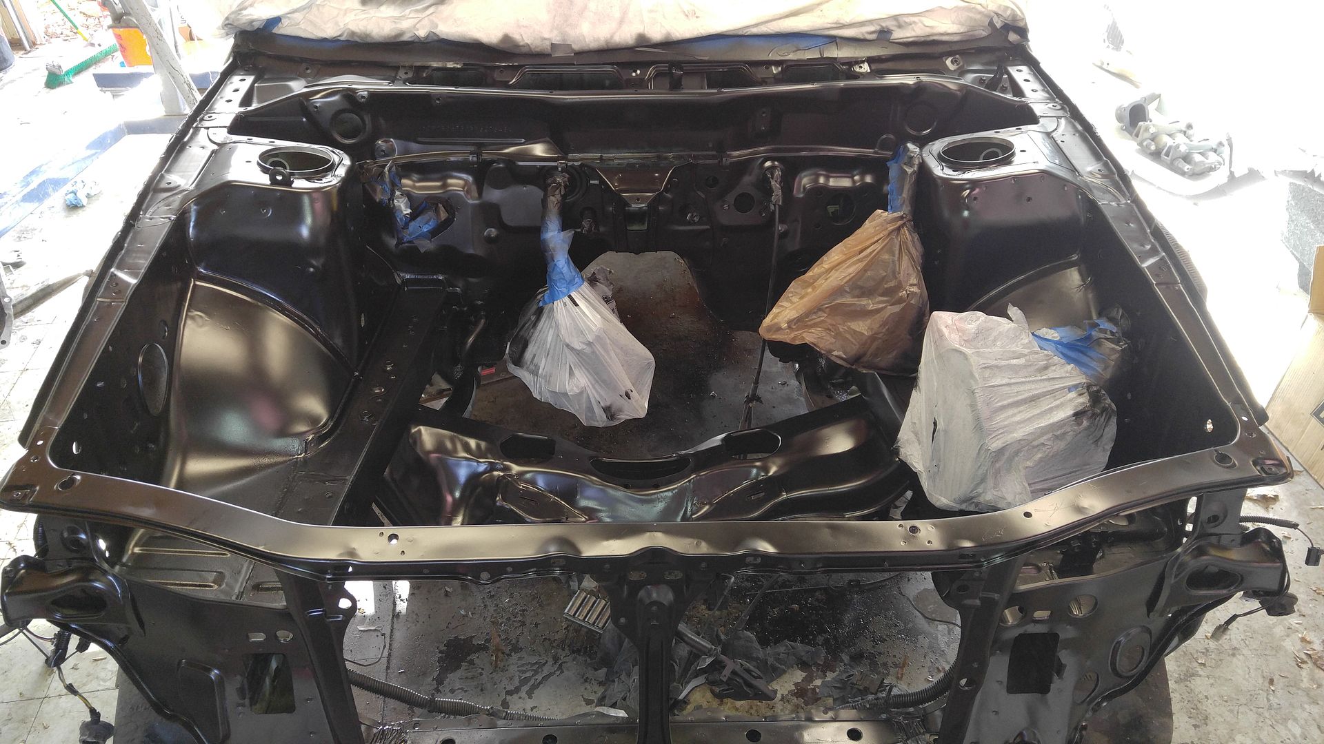

Another full day

mike-tracy wrote:l love the look of a clean block. I always let degreaser soak in and hit it with my pressure washer, but yours looks much better than what I can do. What's your secret?
mine
http://bbs.legacycentral.org/viewtopic. ... 32#p418232
A parts washer works well and then I usually will hit any stubborn areas with brake cleaner.

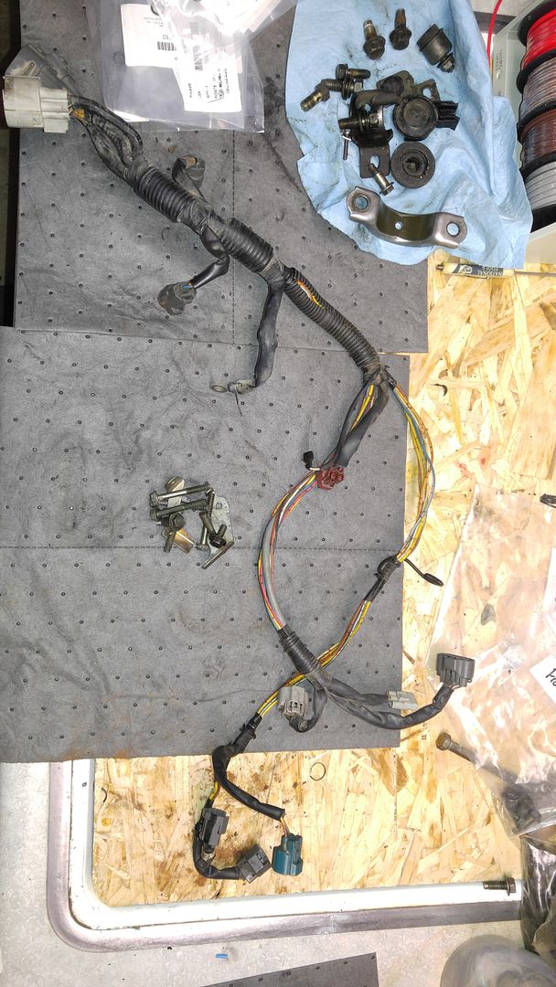

Cleaning up my harneses
Ordered a set of could from SubieLandImage
1990 2.2l Legacy--RIP
