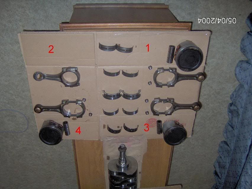

getting ready to split the case tomorrow - this thing bent so-much i wasn't able to tapout the wristpins
the bend is so severe it restricted the piston from bottoming out so i had to remove it first
serious warp in the rod , the sound from the EJ22T Suicide was MASSIVE rod knock
tomorrow i will actually pull the case apart and see whats in there
i ve already found som large pieces of pison in random places

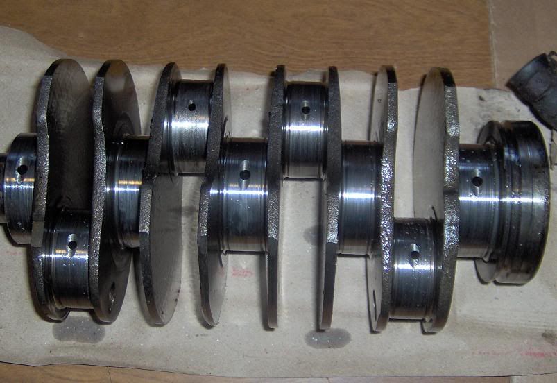

it spun a bearing and began a reaal bad knock, i imagine at high rpm
i thought it was HLAs to begin
i guess nott !
it was just oil starved ..
i guess nott !

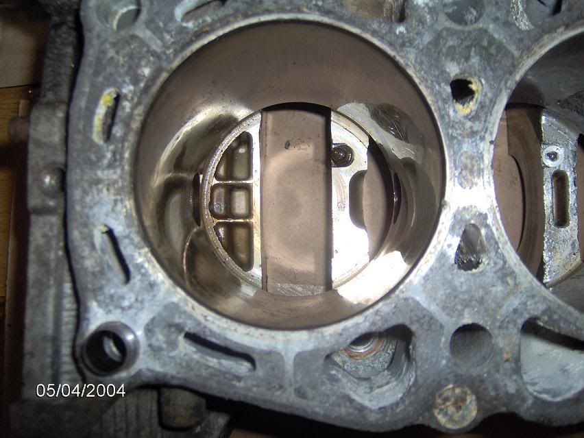

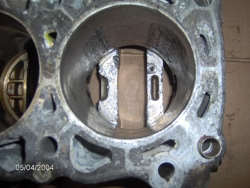

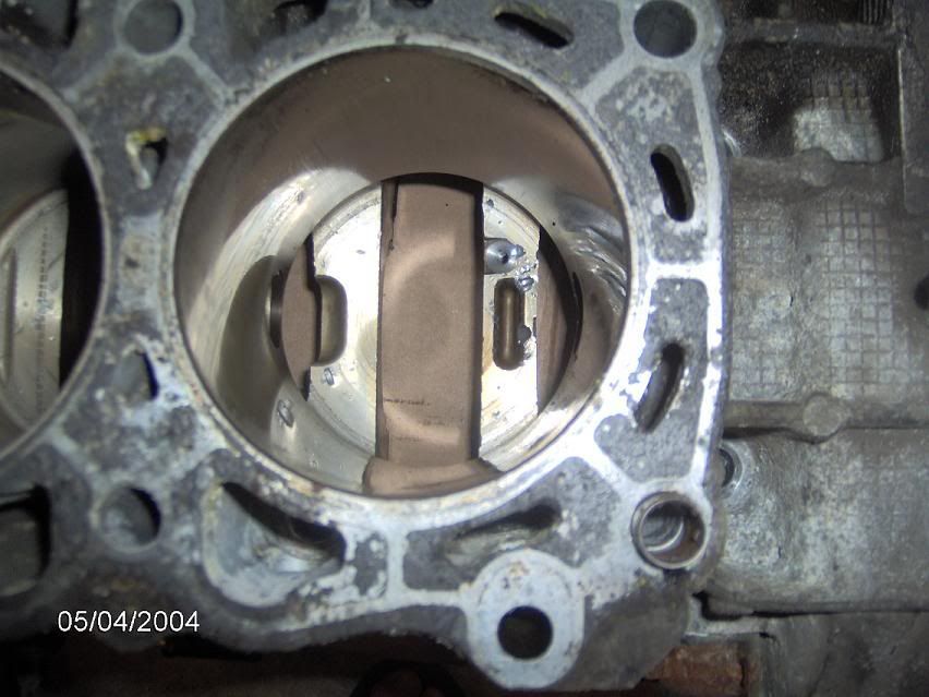

Cyl#1
Cyl#2
Cyl#3
Cyl#4
Cyl#2
Cyl#3
Cyl#4

i m still looking for the oil squirters ..

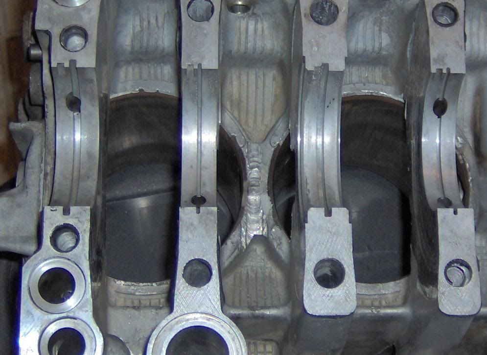

Re: N1446's '91 Legacy SS
I accounted for all squirters but one , it possibly got crushed in the # 2 cylinder
After spraywashing the case halfs with oven cleaner i ve come out with this, there is no other damage next to the rod smacking the inside of the case between the number 1 and 3 cyl
it s not too badd and should be no problem for the new engine
the real damage is at the head and of course in the cylinder wall which are both being replaced
