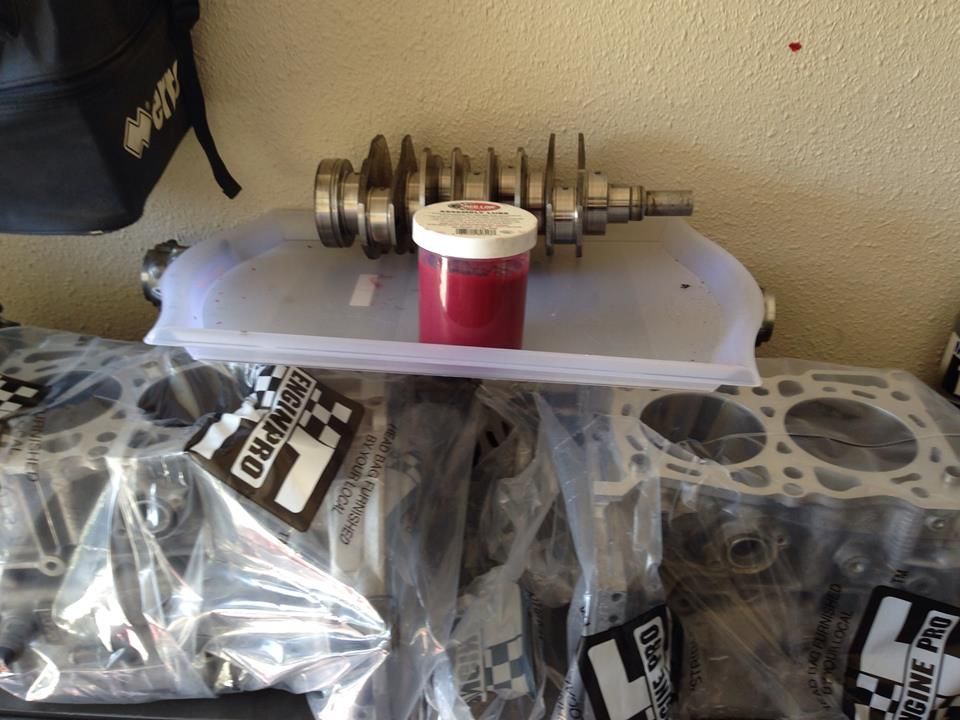

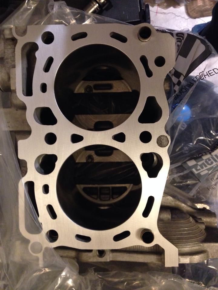

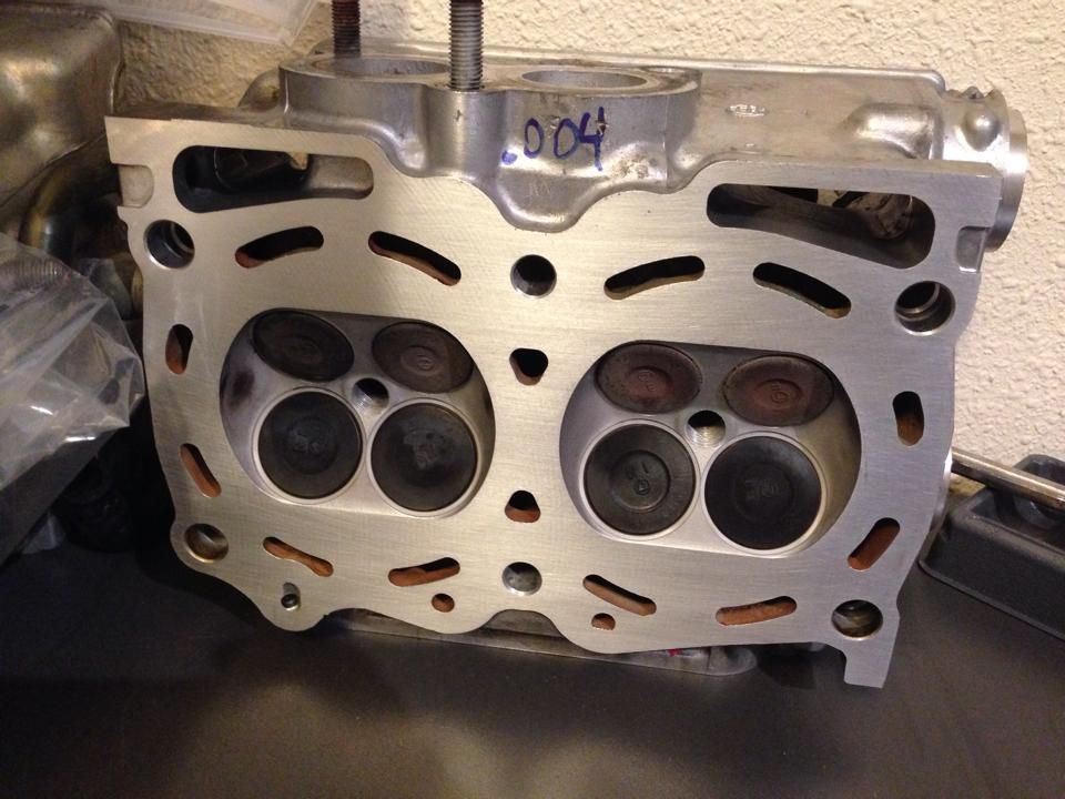

Here are some pics I have meaning to upload. I dont have pics of the heads I am using yet as they are at the macine shop but here are a few pics in general. Teardown of some and new parts.

Josh, in that picture is a torque plate, used to machine the block so it stays round and in shape basically what I have been told. Keeps the cylinder in its shape so when you bore it out it does not change the diameter like taking it out of its roundness. My buddy at his shop recommended them as he does motors and motor builds all day and has seen some negative impacts when those were not used. Also I did source the power steering lines needed so appreciate that as well. Mike-tracy thanks on that info I will need to check it out and double check for the valve cover gaskets. I am waiting by either tomorrow or early next week for the machine shop to be done with the motor and then I can reassemble everything and get it going.
