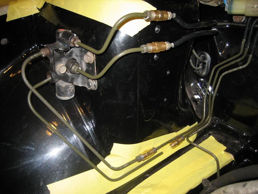

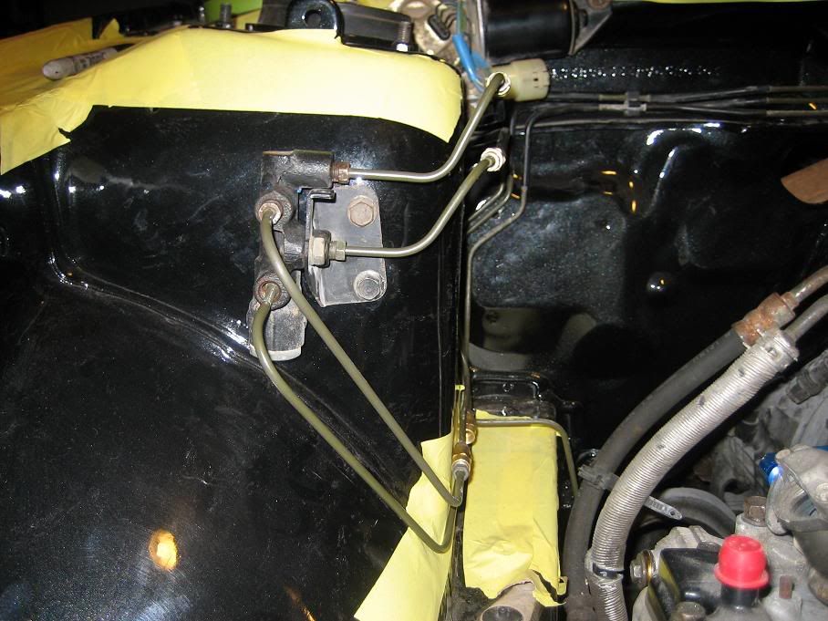

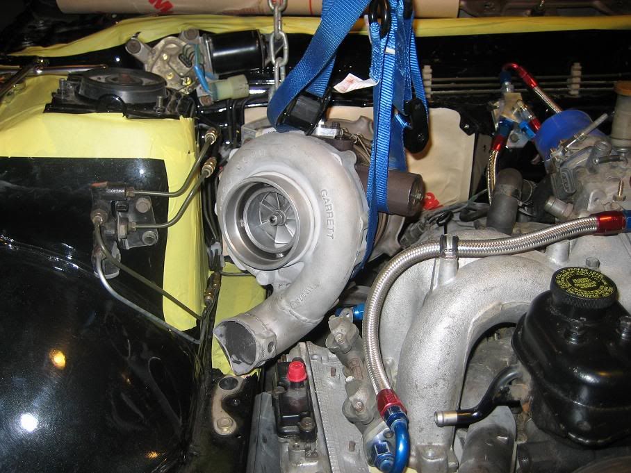

Brake line fun!

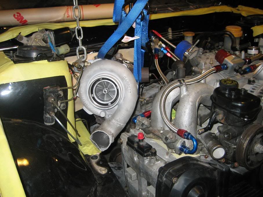

It's actually not that bad with the proper tools. I had to plumb the proportioning valve before moving ahead with piping. As the valve sat in the stock position, the brake lines inhibited mounting a good sized turbo in a rotated position. Moving the proportioning valve to the front of the strut tower gives me around three inches of extra room.
I came up a little short on the last line since I was trying to use pieces from the engine bay lines from the old car. I need about two feet of line to finish it. I'll get it tomorrow.
Now I just need to figure out how to hold a 40 lb turbo in place while I plumb it. I think the engine hoist, a home made bracket, and a ratchet strap or two may be involved.

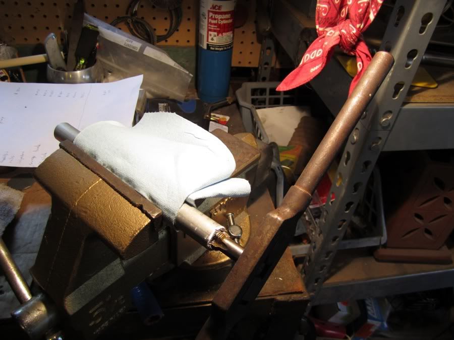

Practicing with the new inverted flaring kit...

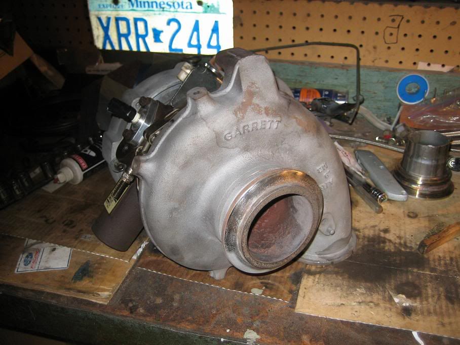

The turbo is clocked and together. I do not have many pictures, but clocking this turbo is quite involved. Since I'm limited by the vane system, there are only nine possible positions I can clock the turbine housing. After a lot of rigmarole, I got it together.
The vanes and unison ring were cleaned up with carb cleaner and 1500 grit paper. The turbine housing was treated the same at the vane posts and where the vanes slide.
After that was done, I had to drill and cut a new spot for the alignment pin. After double and triple checking, I drilled a hole and then cut, reamed, and filed the rest of it out like the OEM slot.
The rest is isn't too big of a deal, but lining up the pin and the arm that actuates the vanes took a few tries. Anyways, she's ready for some piping. It will be interesting when I try to hang a 45 lb turbo where I need it to plumb. I think the engine hoist and a couple ratchet straps will be in order.

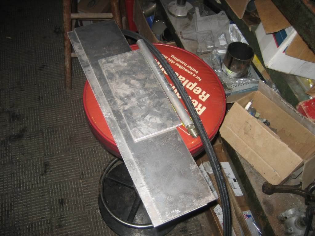

The makings of a fuel surge tank.
After a conversation or two, and some other digging, I decided it would be a good idea to have a fuel surge tank. I happen to have some material laying around, so it shouldn't be too bad expense wise. I have some 3/16 aluminum laying around, so I'll make a tank out of that. I know its a bit overkill, but free material is free material. Also, I have some aluminum tubing here that taps out to a 3/8 NPT beautifully so that'll make my connections. I'll use hydraulic hose and steel fittings like I did with the power steering to keep the cost down.
Basically, I need a Bosch 044, some line and fittings, and to do a little welding. With the trouble Subaru's can have with fuel delivery below 1/2 tank, I think its a good idea.
Here are some materials laid out. With those pieces, the surge tank should be about 3 liters, which is plenty large.
