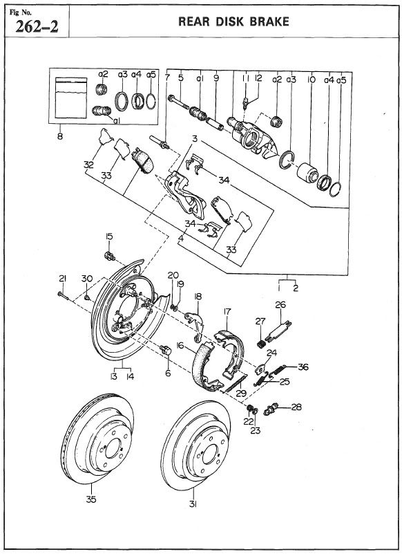

the adjuster on the very bottom of the ebrake assembly, on my picture it is the silver metalic tube with a spur looking gear to adjust the brake shoes. Yours is very short on the non threaded end, mine is long on both ends so I can't adjust it down enough to get the rotor back on.....

this dealy here
Re: Xise's 1993 Legacy Turbo
Oh that's dumb. I see what you mean. Its aftermarket I'm assuming? Can't you just reuse your old one? Mine didn't want to work on their own so I took them apart and hit them up with the wire wheel and lubed them and they look and perform good as new.

I'm not sure what you're looking for exactly but that's all the rear brake parts with OEM part numbers.
For the whole brake caliper kit it's $216 per caliper not including the rotors from 1stsubaruparts.com.

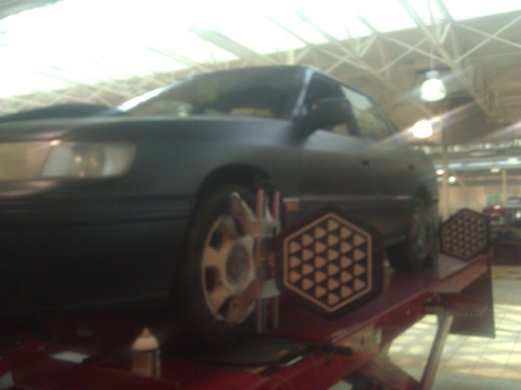

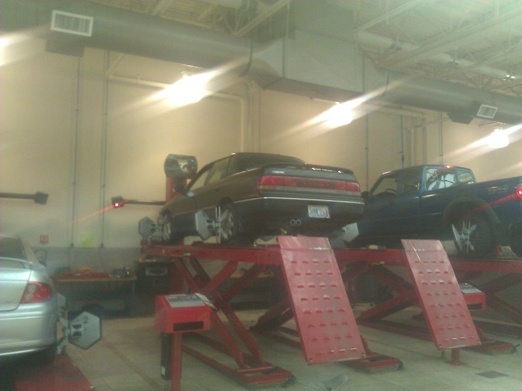

Very last day of suspension class I snuck this guy in there, got the rear toe adjusted, that bolt was a bitch to turn, I bet the entire sleeve rotated inside the bushing when it did budge...it required heman strength. Front toe is all set. camber was in spec and front camber set in the green.
All lined up, the rear camber is out, but I can't adjust that anyway so whatev...maybe the suspension will settle a bit, if not i'll get some camber bolts for the rear.

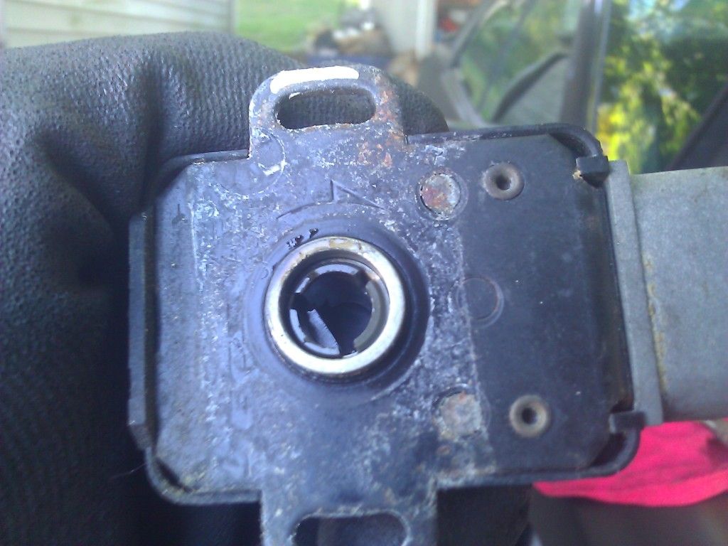

Gave SP a tuneup today, I also swapped the TPS sensor from the other intake mani I had lying around, hopefully that does the trick, revs seem to come down quicker when I let off the throttle so it seems ok, just got to clear the check engine light.
the old TPS had oil in it somehow

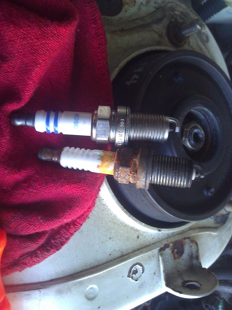

On to the spark plugs
not too bad
NGKs good plugs a wee bit old, they did have some life left but meh..i changed em anyway.
old vs new wires, they looked pretty shitty lol

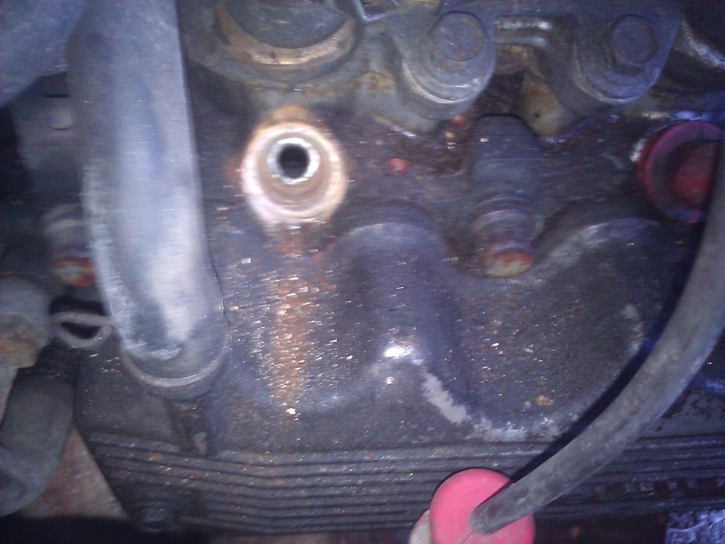

The second plug was one of these types that just give you greif
had to clean all that shit outta there with a rag on a screwdriver after I scraped the first bits of rusty sludge out
theres a winner

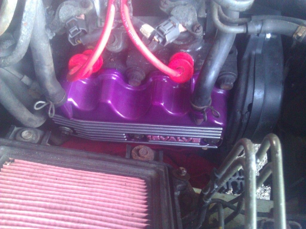

Valve covers on with new gaskets
New Wix air filter while i'm there
and the other side.

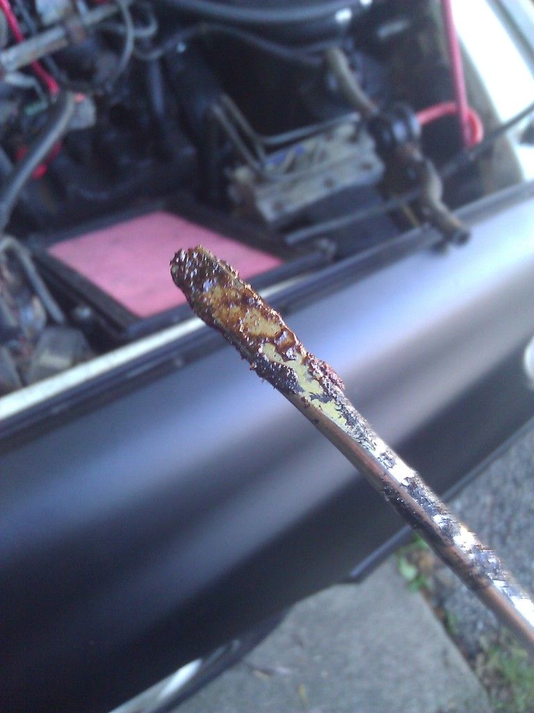

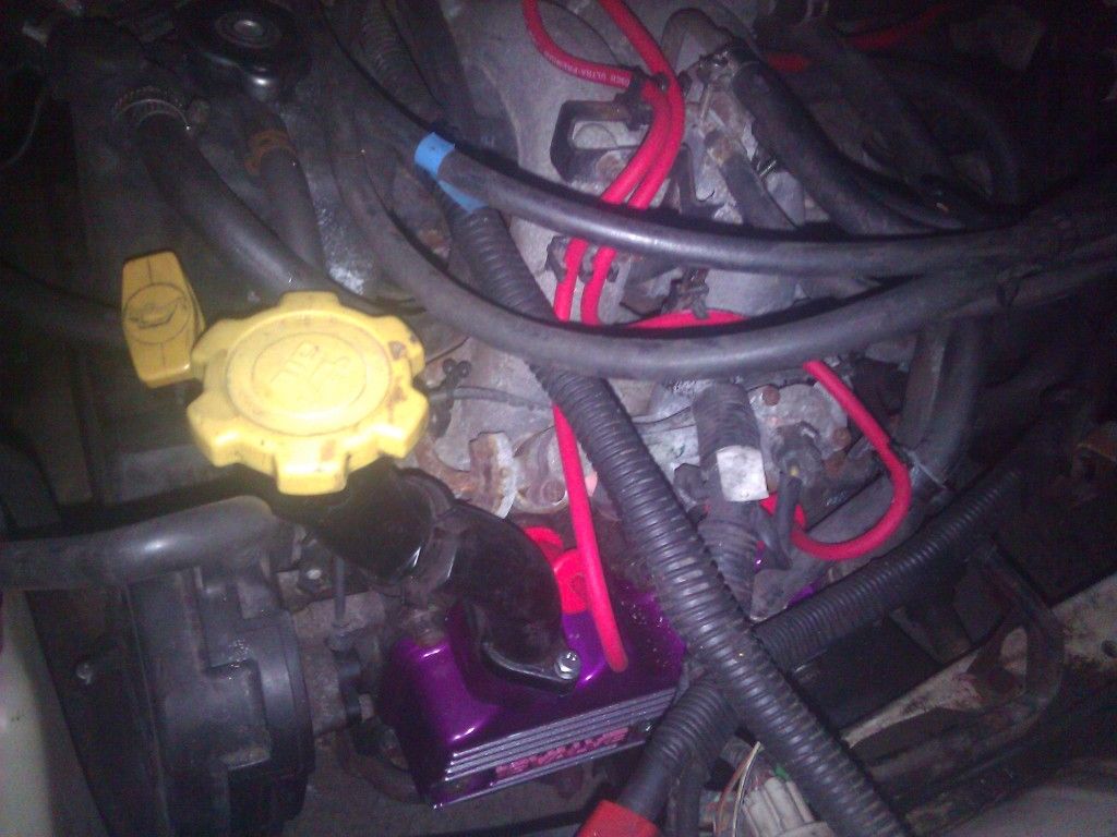

I have a question for you guys, Has anyone else ever had trouble with their dipstick tube not being able to get all the way aligned and have trouble with the dipstick itself being a bitch to get all the way back inside...it is a serious PITA to check my oil... :roll:

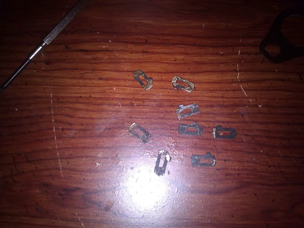

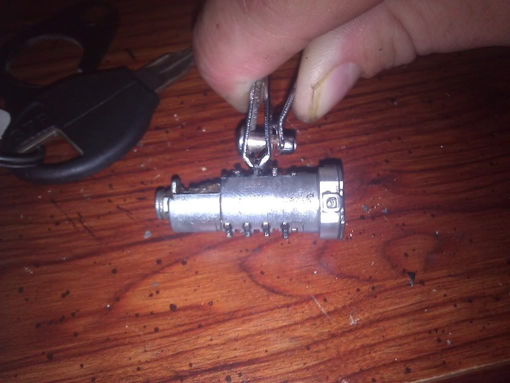

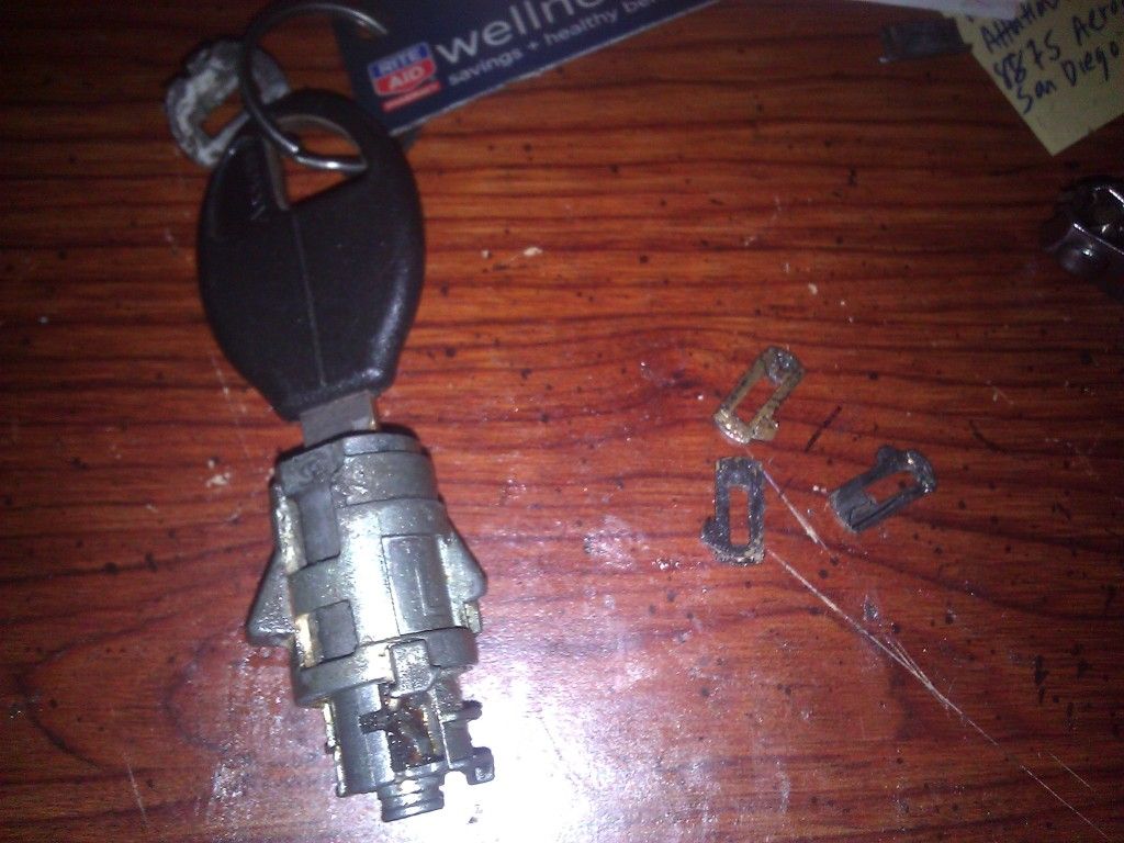

Still haven't gotten to the struts today, I did however repin all my locks to the ignition key. I initially called the locksmith but they wanted more than 1/3 of what I paid for the SS so I said fuck that and tried it myself.
it was easy enough to get the handle out.
dissasembled
removed each one that would not allow the cylinder to rotate
Done.
after that I had a bunch of spares from a spare subaru lock I had lying around
Put em back in....what a fucking de-backle that was, they are such a pain to get the door handle back on the stupid plastic clip thing....fuck that plastic clip.. If anyone is interested I can make a writeup for this, I took a bunch more pictures.
