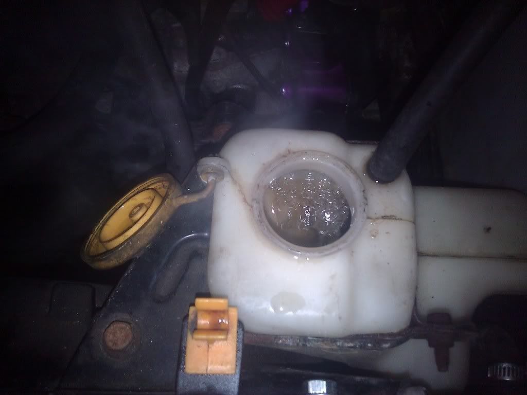

I do have a new issue though,the car runs hot after a while of driving it, might be just because I have only water in there right now. I am going to get some coolant and see how that goes, as of right now if I driver for more than one hour I get this in the overflow tank.

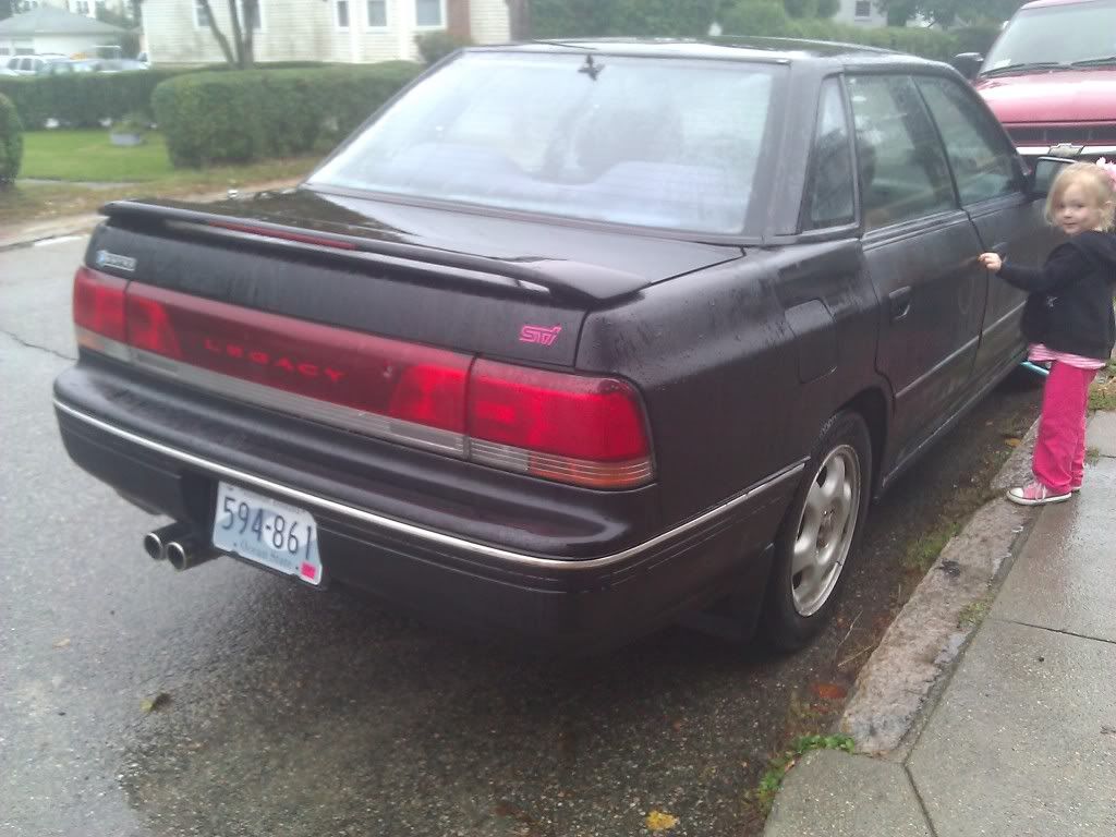

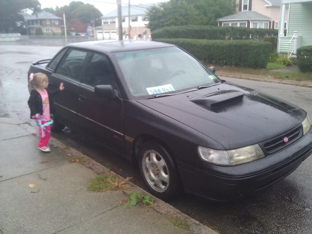

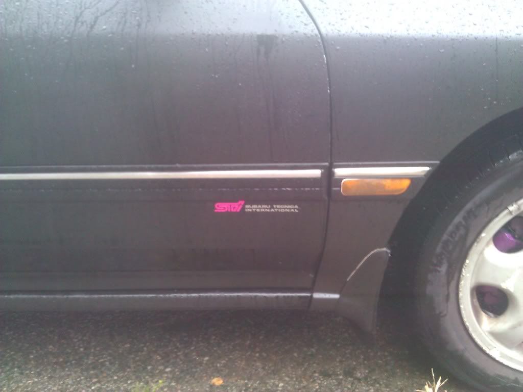

I got around to putting some decals on too, you may call it rice, but I think t looks cool, so fuck you in advance if you don't like it

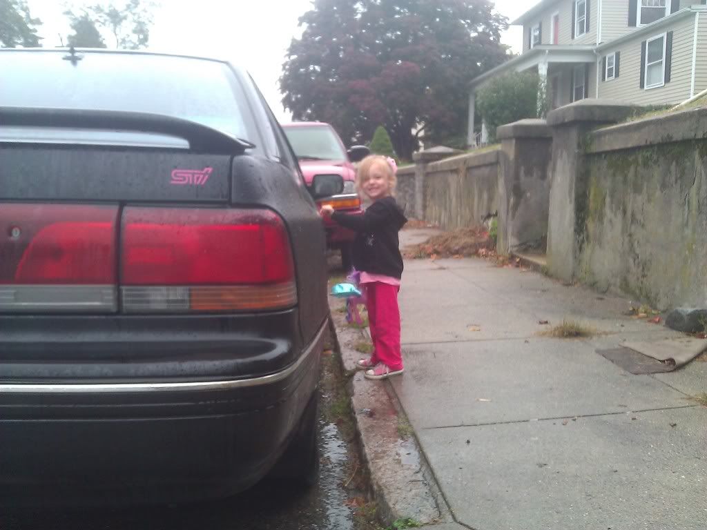

As you can see my daughter also approves of the decals lol

Coolant is less efficient at absorbing heat than water so that won't help. I ran straight water for a few months with no problems so you have another problem. Is it an OEM thermostat and radiator cap? Do you smell fuel/oil in the coolant or milky oil on the dipstick? Are there cold spots on your radiator and does your heater work well? Have you recently drained the coolant and maybe have air in the system? Is there any leaks underneath suggesting a possible water pump going out?

No coolant leaks, I never bled the system though, I couldn't find the bleed screw on the radiator everyone was talking about, if anyone has a picture that might help. Also it is a gates thermostat w/ jiggle pin so I figured it would work ok. The heater works fine and everything else seems ok, my first thought was the whole system bleeding, I added water for a few days while it sat until the header tank would overflow. As far as I can tell the caps are all OEM, I am using an 07 WRX coolant header tank I believe in the place of the AC compressor on a bracket.
Re: Xise's 1993 Legacy Turbo
I'm not familiar with the design of the Gates thermostat but everyone has problems with aftermarket thermostats restricting flow too much and causing overheating problems. I don't know what brands are to blame but when you see the culprit thermostat compared to an OEM unit the difference is amazing and it's no doubt they cause overheating.
I have never used a bleeder screw on any subaru when bleeding the air from the coolant system. Didn't even know there was one. Pretty sure there's not actually but I may be wrong. I've always used the radiator cap or the cap on the coolant tank. You want it to be at the highest point in your system to aid in removing trapped air. Just let it idle with the cap off for a good 30 mins and keep filling when necessary and at some point it'll probably boil over. It's best to use one of those yellow coolant easy fill funnels that attach with a rubber seal to the spout and you can fill it all the way up and just let it idle and burp itself. Super easy and I highly recommend it.

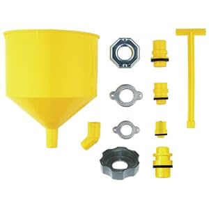

Sounds to me like you might have air in your system. Go on amazon or maybe autozone and buy one of those yellow funnels and it'll make your life a lot easier. I think if more people had these and had the patience to let the car idle for half an hour we would see much fewer overheating cases.
http://www.amazon.com/Lisle-24610-Spill ... +easy+fill

I have seen those before, they are pretty cool. The way I did it was parked on a hill and I just filled the coolant header tank until it wouldn't take any more coolant, let it run for a while and kept topping it off. That is how I always used to fill radiators and never had an issue. People here have always talked about a bleeder screw on the radiator...I was just never able to find it so I used my own method, so maybe the burping I did was fine and it is the thermostat causing the problem...:shrug:

TPS is 31. 42 is the idle switch which is part of the TPS. Don't forget to squeeze the upper radiator hose every couple mins to help get the air out.

nope it is a cable type, yeah that's how I manually burped it, squeezing the upper hose and then letting it run through the motor. I'll try a new Subaru thermostat when I get a chance, hopefully that won't cost too much.

There is no bleeder screw on the turbo legacy radiators, only on the non-turbo legacy radiators. The bleeder screw is where that line comes off the passenger side of the radiator across the intake manifold and to the coolant tank.kimokalihi wrote:I have never used a bleeder screw on any subaru when bleeding the air from the coolant system. Didn't even know there was one. Pretty sure there's not actually but I may be wrong.
Cute daughter!
