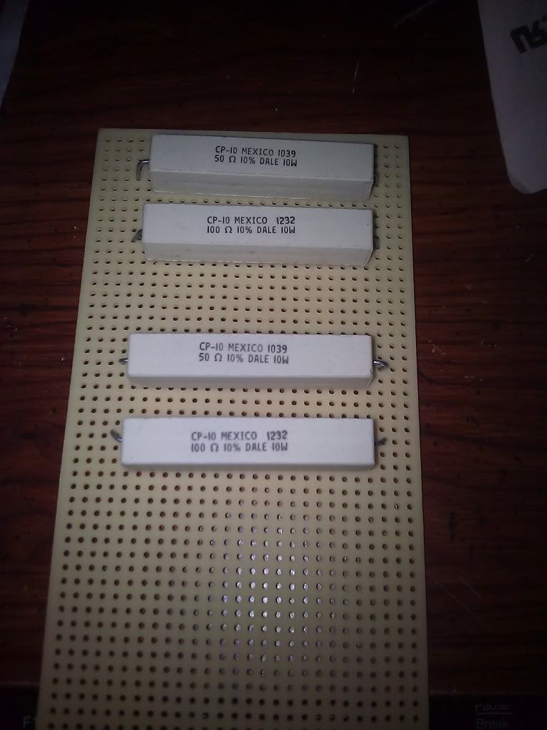

I got busy at radio shack today, got the resistors I need to make my block for my 50/50 split switch
My resistor block all made up, someone robbed all the switches from radio shack so i'll have to grab some at autozone...
then decide exactly where to stick em, either next to the ebrake or up where the air ride switch would be...I am also going to make a power mode switch..but that will be simple.

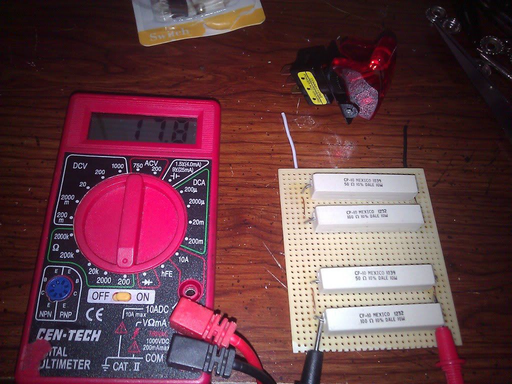

Resistor block is done, it is giving 17.8 Ohms so hopefully that isn't too much...aslo this was a harbor frieght multimeter I got for free so it might not be 100% accurate.

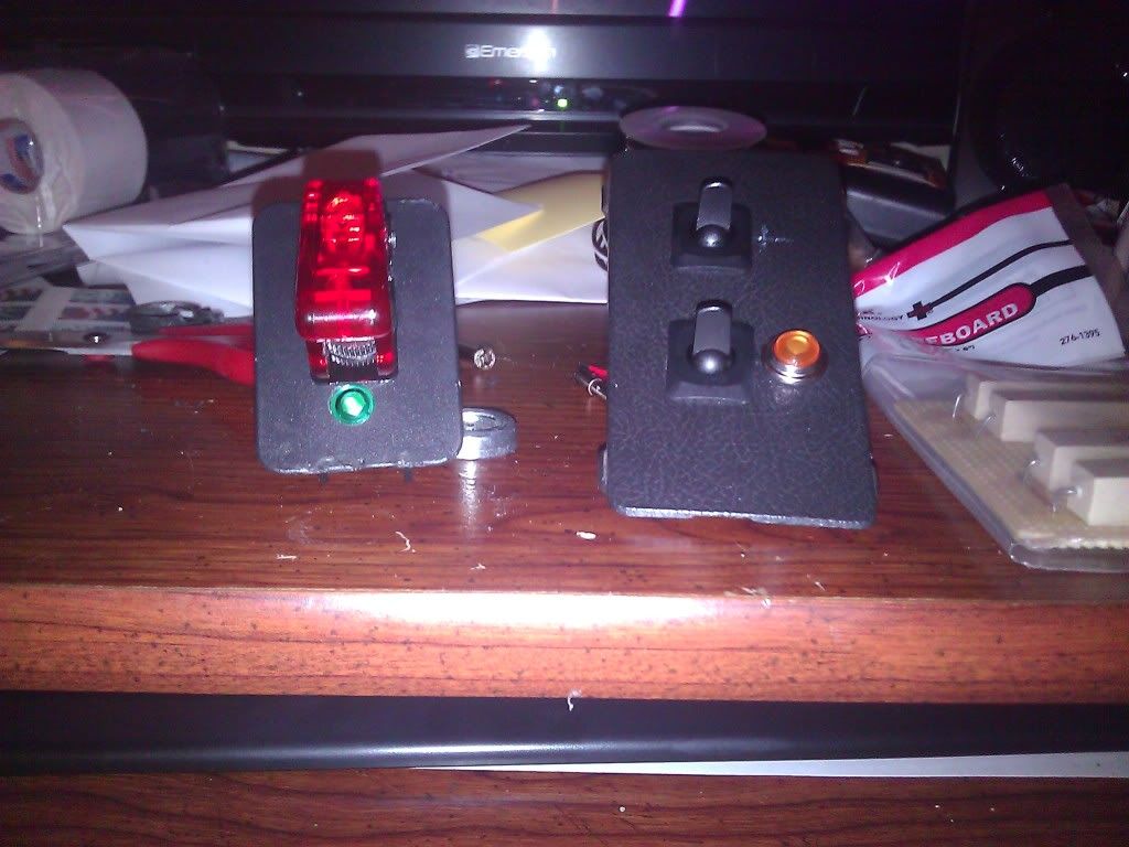

Mounted em where they are going to end up, the power mode switch right next to the steering column, and the AWD switch right next to the ebrake....not sure what the other switch will be for but I am sure I will think of something
Re: Xise's 1993 Legacy Turbo
I like the power mode switch.....it's hard core

Thanks Josh, hey is 17.8 ohms too much for that switch to work right? what does the ECU look for for that solenoid?
Based on the diagnostic from the FSM, the duty c solenoid's resistance is between 9 - 15 ohms
http://www.main.experiencetherave.com/s ... _diag2.jpg
If all you're looking to do is sink power to it, that will probably work....but you'll probably have to try it and see.

Just trying to have the trans not give off a code when I send power through the resistor, if the ECU is ok with almost 18 ohms then fine

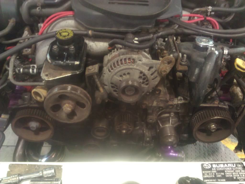

Ripped into the timing belt today, looks like my leak has been found, the water pump, oil pump and passenger's side cam seal were leaking...also the timing belt was off by 2 teeth on the driver's side cam
Honestly I am amazed it ran as good and had as much power as it did....that also means it will run even better once I get it all back together
didn't really get to far into it today, got the water pump out and then realized the hydraulic adjuster was not included in the timing belt kit I have. I also still need the rubber seal for the cover and to grab the timing cover plastic covers from the other motor as these are all broken on the mounting holes.

And the bracket it bolts too if you go that route
