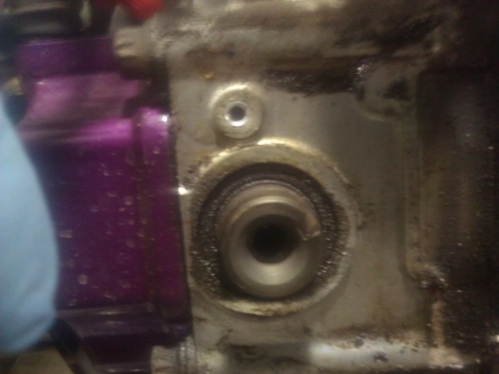

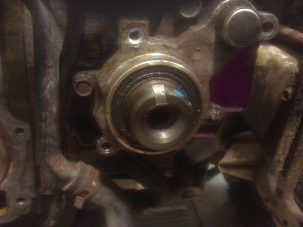

passenger's cam seal all nasty as fuck
driver's side not so bad, not leaing but being replaced anyway

I'm assuming you're replacing the o-ring behind the oil pump? Also check the backing plate screws on the oil pump.
Personally, I don't like the newer style t-belt tensioners. Either the one on the 06 Legacy I had wasn't ok, or they just don't hold the belts as well as the older style.

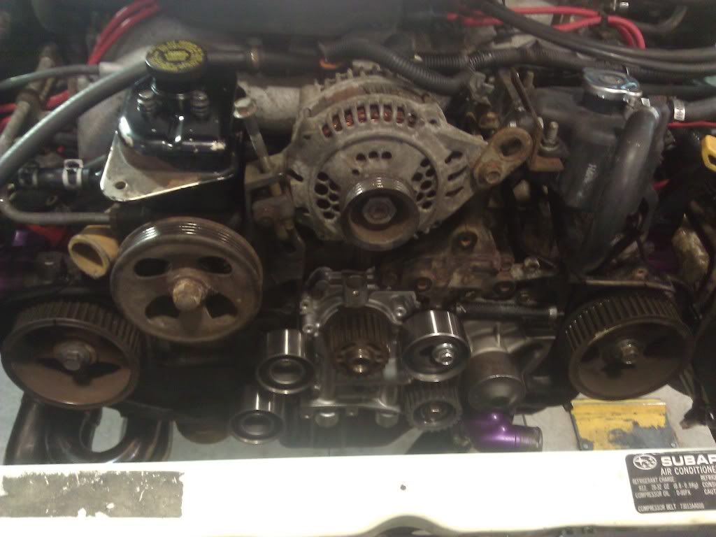

I used assembly lube, belt was pretty easy to do, I just used vice grips on the old belt to torque the cam gear bolts back on 50 ft/lbs and I used a spanner wrench yo hold the crank and torqued it to 80 ft/lbs...the spec gates gave was 69 ft/lbs...seemed too low so I went to 80...but shit even that seems low for such an important bolt...I want to up the torque another 20lbs lol....
Also I got this all done, timing cover back on, everything torqued down and then read that I was supposed to use an anerobic sealer....I used the same thing I used on the water pump and the oil pan, this
I sure will be pissed if I have to do this because I used the wrong sealant....I imagine it will be fine, and the FSM makes no mention of anerobic or not, it has the sealant icon, so fujibond?

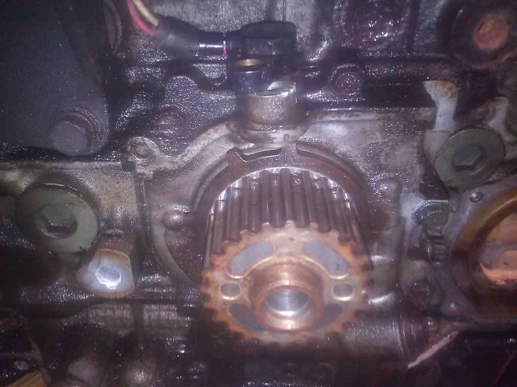

also the crank sensor is stuck in the old oil pump...looks like someone tried to bash it out with a hammer...needless to say it did not budge at all.
I HOPE the cranks sensor comes right out of the other motor...I really don't want to spend money on a new one...they are wicked expensive...no me gusta :(

The cam bolt torque is only 47-54 ft-lbs.
Ultra Grey sealant is the correct sealant to use between the oil pump & block.

Got the crank sensor from the other motor, came out nice and easy, thank God :D A new crank sensor is like $150 at least!!

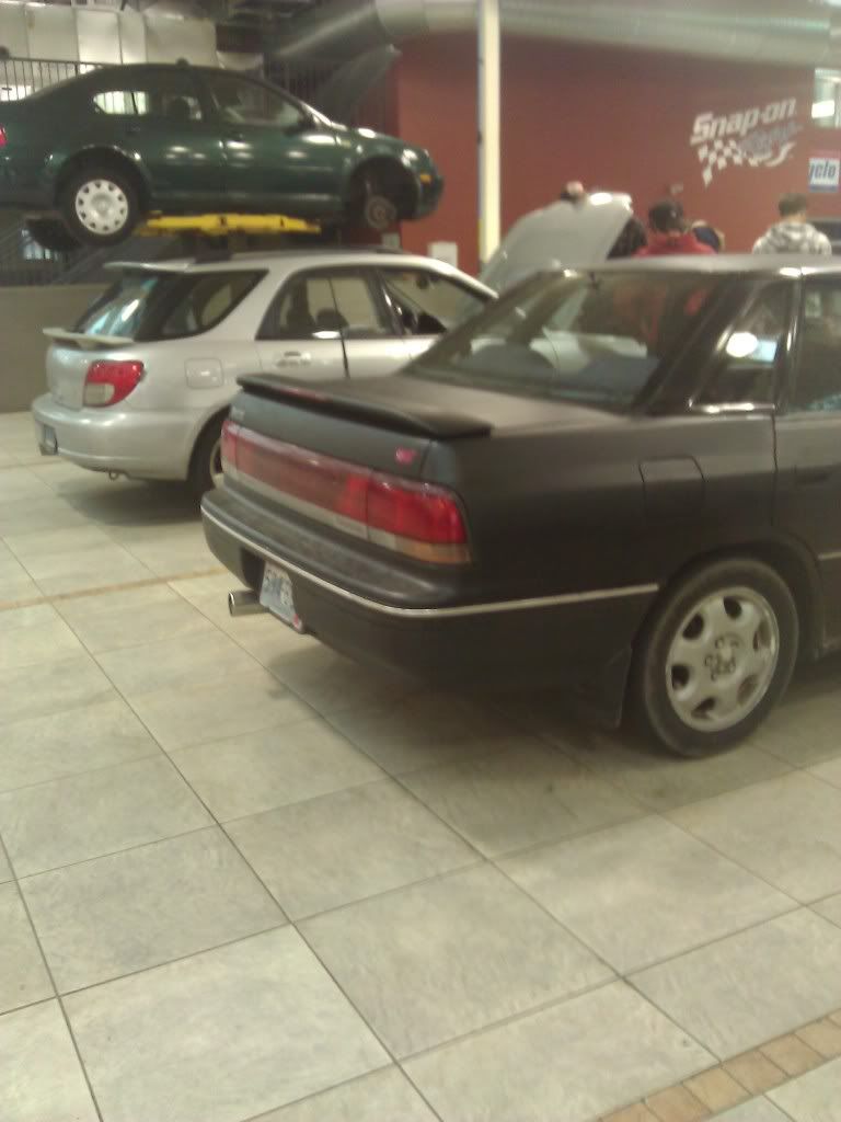

Week before final exams, got a shot of this kid's WRX wagon alongside mine, He is also running a straight pipe.

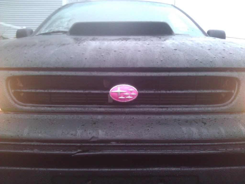

I also made another emblem, this on is from a 96 outback...a little big bu I made it work
