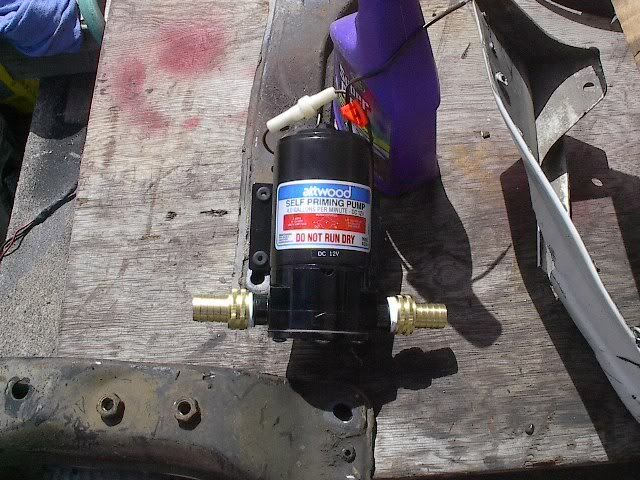

We started getting it all mocked up today!
We had to cut the bumper cover a bit, but it still looks pretty stock
Here is the crazy pump we got. 400 Gallons per minute! only 80 bucks!
Here is how it looks all mocked up. Tomorrow we will make some brackets, and run all the hoses!
