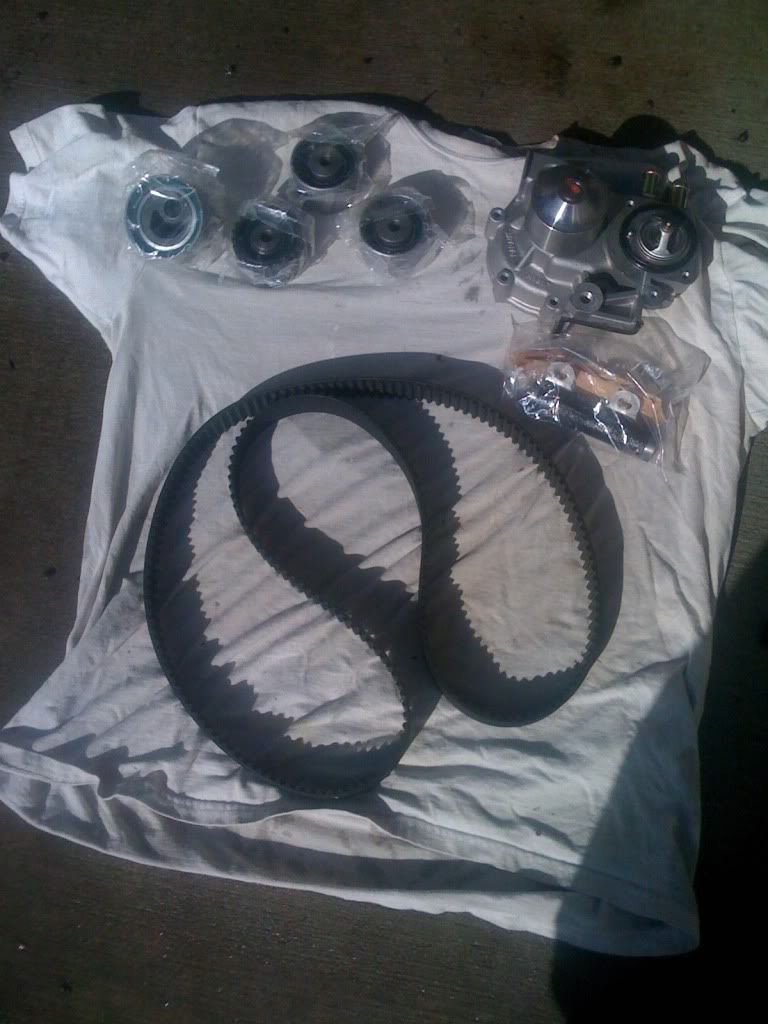

Finally got around to starting the engines nose rebuild.

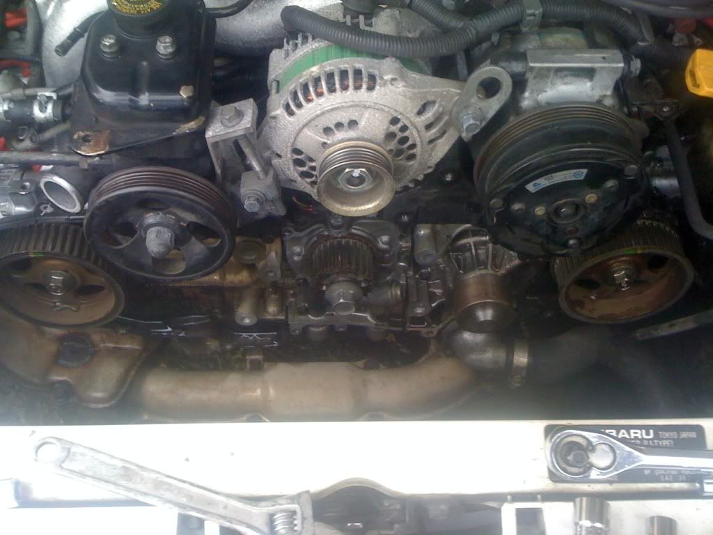

Bit of unsettling info. Shes had a rattle comming from the engine bay. Ive specualted that it might be a loose belt cover or some such. last mechanic that had her speculated on a bad Hydraulic Actuator for the timing belt. Tearring her down I was rotating the motor by the crank bolt and I can here a thin metalic rattle comming from the BACK of the engine when the engine comes off compresion. I think the bozos at AAMCO didn't tighten down the crank/Flexplate/torqueconverter correctly. *le sigh*
