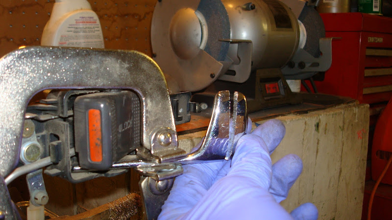

I hung the front door and hopped in to play around with the gauge placements, I think I'll put the water and oil gauges in the center a/c vents btw, but I shut the door and then couldn't get out. Crawling into the backseat is a BITCH when there is giant X in your way! Sooo.. I needed to trim the handles:
