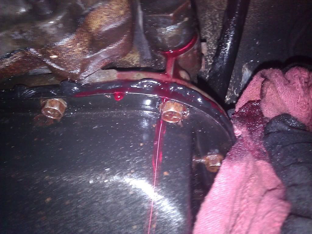

We have a place that does that stuff locally too. I just did the gasket on the AT trans and it is already leaking again, the gasket never set for whatever reason, it was still goupy.... this is after already doing it once and having it leak slightly near the rear of the pan...now I re did it and it leaks even worse b/c the gasket never set up properly...I let it sit overnight so maybe it solidified...who knows. Honestly I am tired of the AT trans, there is a guy selling a RWD converted trans for cheap I might just grab that and say goodbye to the auto...I hate automatics for this very reason.
It looks like the brilliant minds at AAMCO tightened the bolts way too much and raised all the bolt holes so the gasket can't get a good seal, I tried to fix it with a hammer and block of wood but it doesn't look like it worked very well. I will try one last time and then I am going to sell the transmission and put this car on jack stands until all the other stuff it needs is done...then I am burning down my local AAMCO... that is all.

turns out my hammer skills are on point, the pan was sealed perfectly...I crawled under the car with a creeper today and saw that it was coming from one of the fittings and spreading out on the gasket and just looked like it was leaking from there
So I am sure you can understand why I'd think the gasket was leaking again....turns out it was another case of AAMCO not doing their job right...I know I never touched that fitting, gave it like 1/4 turn, no more leak....made me happy

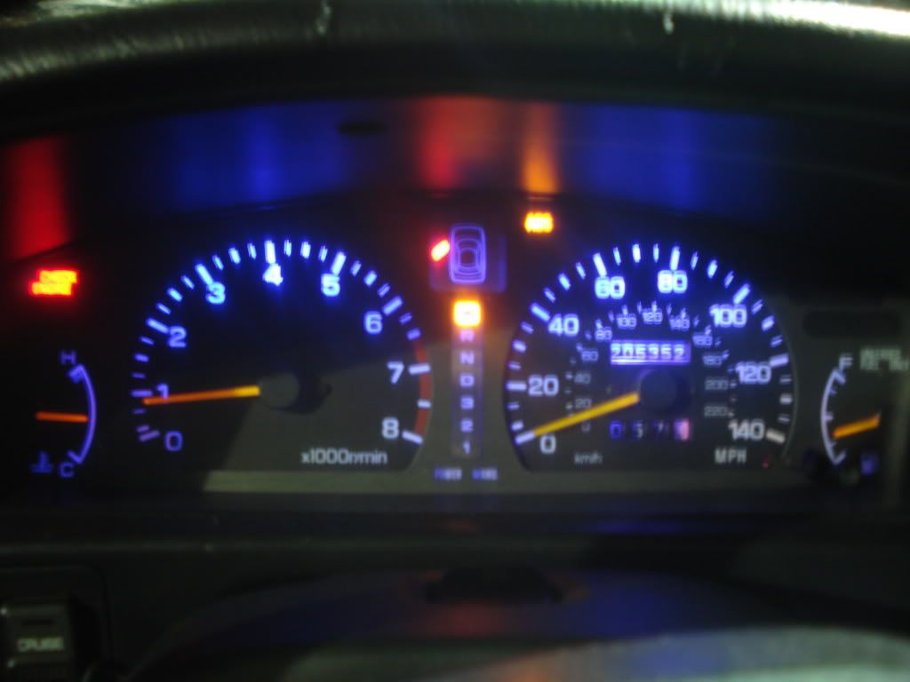

I decided to replace the gauge lights today, one was actually burnt out too. I used 2 194 high intensity purple, 2 74 led purple and 2 74 led amber lights on the ends for the fuel and temp gauges...you can't tell but it makes the needles light up more brightly, they might be better in red so I might try those int he future.
I know they look blue here but trust me, they are purple as fuck, not sure why they look so blue...speaking of things that look blue on camera for some reason, I got these.

better pictures with an actual camera.
now you can see the gauges, but still can't tell how purple they are...they look fucking blue lol
